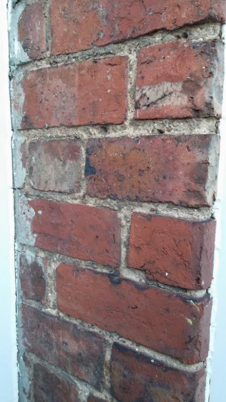

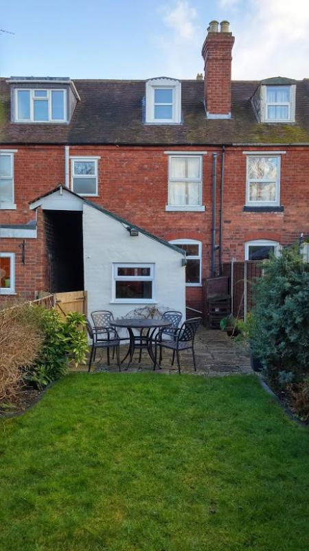

We need the back of our mid terrace repointing. Here are a few pics....

No idea on price. The beds appear to be the original mortar and in pretty good condition - good for another 10 yrs say, unless you are having penetrating damp difficulties.
If you go ahead, you will have access difficulties above the extension - scaffolding and bridging might be required. Pointing in conjunction with the flat roof neighbour's would help?
Take care of any roofing or guttering maintenance while the scaff is up.
Rake out to a depth of 20mm th 25mm, beds and perps - this is a must. And a bucket handle finish.

There's quite a few holes in the mortar although we have no damp (touch wood). I would like it done though.
How about the replacement mortar type? Is it lime and should I specify lime as the replacement?
Yes it's lime mortar and yes you should specify lime mortar be used in the repointing. If you have it done with cement (which most will default to since they know nothing else) you run the risk of causing damp problems.

First, tell those that have quoted that you want it doing with lime mortar. I suspect the quotes will change. Or they will tell you that you don't and everyone uses cement these days. Eliminate the latter.
Second, ask them how they will get to the wall above the kitchen roof e.g.'are you going to need scaffolding?'. The responses may be instructive.

Joints should be flush and finished with a churn brush.

Had another chap in today that came recommended. He said he would do lime mortar but recommended against it? He quoted around £380 to do it with lime. He really genuinely was telling me it was best to do it in cement? It looks like the neighbours have all been done in cement as well. Confused now.
He's telling you that it's best because it is harder wearing (which it is). He doesn't understand the damp issues it can cause with solid walls. At least he's willing to use lime and the price is fair.
Have a look at your neighbouring houses that have been repointed with cement. I bet most of them have the tell tale line of holes from an injected dpc. If you can find any that still have lime mortar I'd wager most of them do not.
Lime mortar is breathable. It allows moisture in the wall to wick away. This is important in a solid wall with only engineerig bricks for a dpc.
