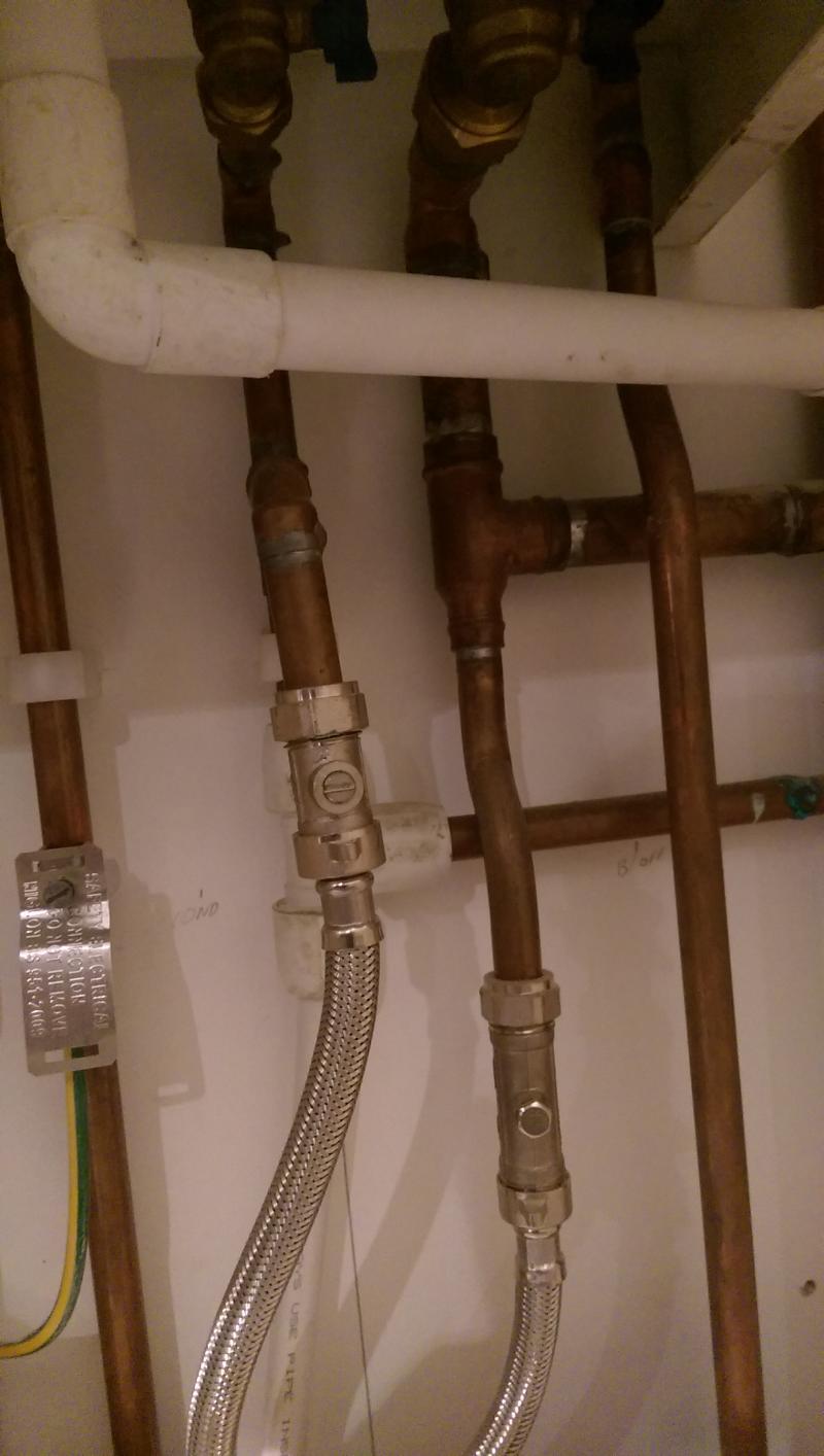

Hi guys. As the title suggests I am having problems repressurising my boiler. The boiler (and the house) are a little over 1 year old and admittedly I had not regularly checked the pressure gauge, and therefore didn't notice if it had been dropping slowly over time. Of course I know now that it's dropped because of the lack of hot water!
Pressure is currently at circa 0.3 and as such the boiler is not firing (it is showing the appropriate code "F 1" on the display for low pressure). I am not aware of any leaks anywhere so in the first instance I want to try to repressurise it. While I have looked at multiple online videos and some threads here, this boiler seems to be different enough that it's not clear to me how to do it (although I am beginning to think the flexible piping is screw operated hence why I can't find valves). Would appreciate any help you guys can give. I have uploaded pictures to my album to help, although the flexible piping isn't in the picture I can confirm it connects the two most right pipes that have valves. Thank you!
Post a picture of the flexible silver hose and we will tell you what to do.
Then check the pressure every week!
Tony
Slotted screwdriver turn the slot so it is inline with the pipe you will hear water filling, watch pressure gauge, fill to one bar then return slot to previous position

Tried turning the black valve in picture but didn't do anything and unlike the previous post there does not appear to be any screwdriver slot to try.

Can you take a better picture of the full pipework arrangement under the boiler please.
Also, can you get a better picture of the valve that is on the left side (connected to the flexible braded hose).

The flexi hose (braided silver thing) is your filling loop.
Firstly, check your pipework (since it looks like a complete maze of pipe back there).
From left to right (straight out of the boiler) the connections are: -
CH Flow (has the gauge fitted)
DHW Flow
Gas Inlet (Yellow handle – don’t touch)
Condensate (White Plastic pipe)
DCW inlet (Blue Handle – Called DHW inlet in the manual)
CH Return (Black handle valve)
Pressure relief pipework
The flexi hose should be connected between the DCW inlet (blue handle) and the CH Return (check). If this is the case after checking, you should only need to do one thing. By simply turning the black valve next to the braided hose so that the handle runs parallel with the pipework, i.e. put the black handle horizontal, it should re-pressurise the system. Watching the pressure gauge raise to 1 bar – bleed the air from all rads and re-pressurise again.
Can you check if that black valve is a quarter turn valve or a gate valve? I.e. do you have to fully open it?
Can you hear water rushing in when you turn the valve?
Black valve only turns a quarter and no can't hear any water noise.
