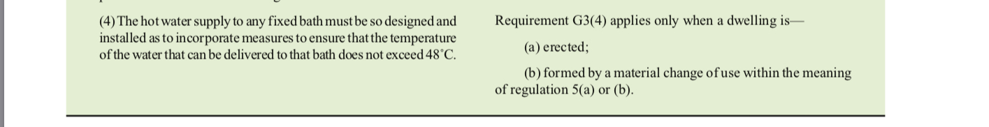

I understand Thermostatic Mixing Valves (TMV's) are required in baths and showers in public places, schools, hospitals etc.
Does this apply in Rental properties and HMO's ?
Its obviously good practice, but is there a requirement, and should it not also apply to any hot water taps in bathrooms and kitchens ?
No, the thinking is you can be submerged in a bath (and die of scalding) but the natural reaction is to pull your hand away from things like a kitchen sink.
Yes if a newly erected dwelling, not required for retro fit or if you renew the bath for example.

Very helpful thanks.
(b) formed by a material change of use within the meaning of regulation 5(a) or (b)
What is regulation 5(a) or (b) ?? - am I being a bit thick here, but what regulation is it refering to, part G refers to this in several places, yet itself contains no 5(a) or 5(b).
I’m not 100% as I couldn’t find it either, but when I asked about materials change previously, I think it means like a barn conversion, etc.
Earlier in the Building regs I think;
Meaning of material change of use
5. For the purposes of paragraph 8(1)(e) of Schedule 1 to the Act and for the purposes of these Regulations, there is a material change of use where there is a change in the purposes for which or the circumstances in which a building is used, so that after that change—
(a)the building is used as a dwelling, where previously it was not;
(b)the building contains a flat, where previously it did not;
Ahh, thanks for finding ... it isn't very clear on what it refers to.
