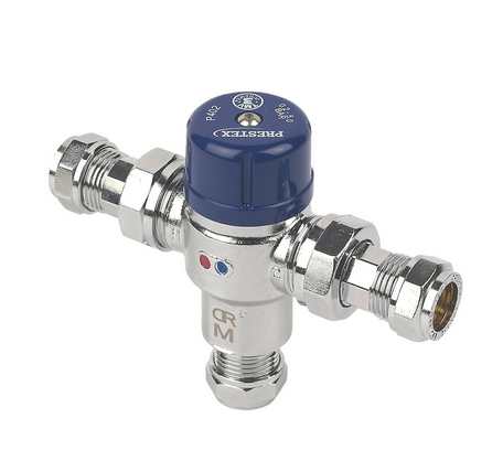

Can a TMV be installed right at the hotwater draw off of the Cylinder to service all taps
That would limit the hot temperature to all taps when you might need something hotter at the sink for dishes, for example.
If the TMV needs to be next to the bath, presume the outlet of the TMV connects to the hotwater of the Bath taps, and a the coldwater T's off to supply both the cold water tap and the TMV.
That's correct.

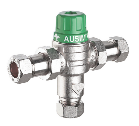

So with option 1) you could have this under the bath:
ae235
Reliance Valves HEAT110750 Ausimix 2-in-1 Thermostatic Mixing Valve 15mm
TMV2 and TMV3 approved.

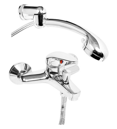

With this tap set, its a mixer, but all the cold will do is cool down the already tempered supply:
Basically, yes. Some like a hot shower though which you won't necessarily get by having the shower off the TMV as well.
