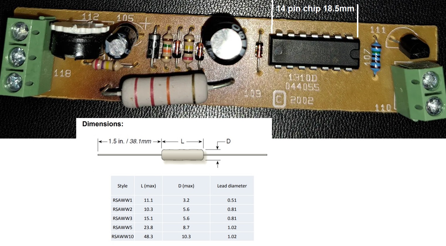

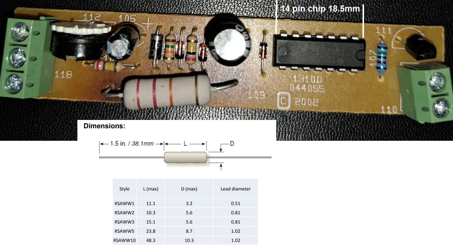

I'm still trying to see any evidence for the resistor being 1W. It could just as easily be 2W in that form factor, and note that it is not the resistor that discoloured, but the pcb.
Could be a 3 watt wire wound ceramic resistor
Would be good to know as after I replace the capacitor, could be the next part destroyed (by it's own) heat. At the moment trying to find a place that sells Kapton/Polyimide tape for a reasonable price that is not the "fake" stuff from Amazon/Ebay.
Forget the tape - it won't have any useful effect. The resistor must be at least 2W as it is dissipating more than a Watt. The weak point is the PCB which cannot stand continuous temperatures of that kind, so at least space the resistor off the PCB using ceramic beads.
There is no evidence - it's an assumption made only by FrodoOne. As has been said, it might well be a 2W or 3W wire-wound resistor (and I suspect it probably is)
However, that only makes a difference up to a point. Whilst the temp of a higher-rated resistor would not get quite so hot, it doesn't alter the fact that about 1.3W worth of heat is being generated continuously in a pretty confined space.

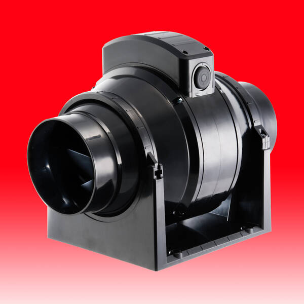

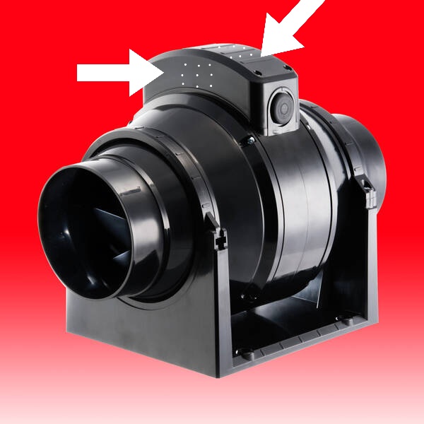

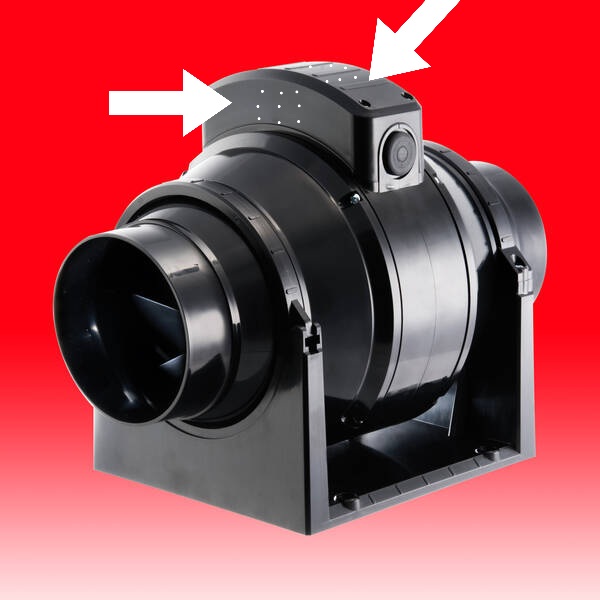

Agree the space the electrics are housed in is confined and unvented, see image below. There is probably no ventilation holes given it is primarily a bathroom extractor and Manrose needed to maintain the IP rating. However, the fan sits in line (in the loft) away from the moisture of the bathroom and the electrics in the separate space from the ducted air. I am now tempted to drill some fine vent holes in the electrical casing so heat can escape. Either on the top or at the sides. I can add a shroud also so let's say by some extreme bad luck the roof leaks right above the fan, the water still has no way to ingress the small holes I have drilled.
