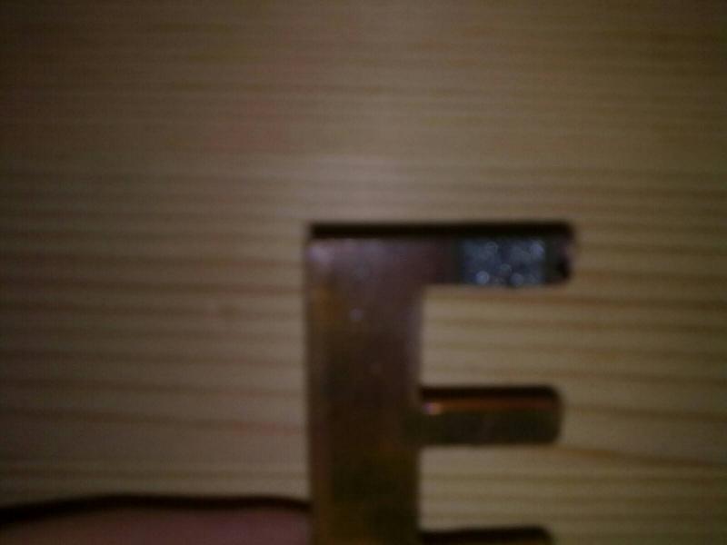

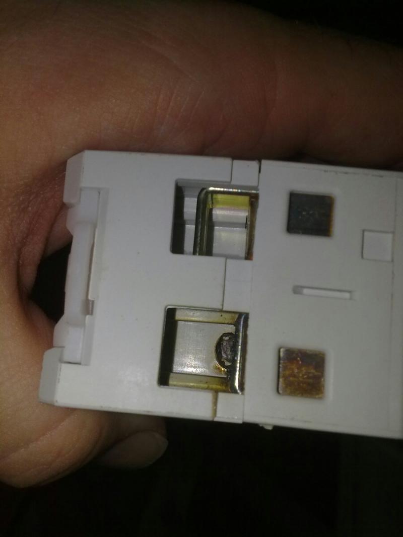

It looks to me like the right hand busbar on your faulty RCD is definiteley not installed correctly. if you look closely in the picture it is discoloured , a sure indication that it has overheated at some time. As long as you have a means of proving the supply to the rcd is dead then with the left hand RCD off the right hand one will be dead. The terminals on these RCDs are a tunnel tyoe it is my guess the terminal has been tightened up but with the busbar not in the terminal but behind it. This could be on the RCD or the MCBs themselves. To prove this , once you have isolated the power and proved its off at the rcd loosen all three terminal screws on the MCB.RCD and the busbar will drop out, Undo all the terminals fully and make sure the cage part of the clamp has backed out . Inspect all the devices for signs of overheatig and if found then replace the affected parts. Re-assemble and test. Do not even attempt any of this if you are not 100% sure you feel happy about doing this. If at all dubious then get a sparks in to sort it for you.

Thanks for all the replies and help, will have a think and a look at things tomorrow then probably call someone in.

Thanks to all those who responded, I think it's all resolved now. (fingers crossed.)
I replaced the RCD, had to clean up the busbar but all looks good now.
Spot on. Have a look at these images:
Does this means we've had an unsafe installation for 4 years?
You should really replace the busbar as it's more than likely over heated
Agreed, I would replace the RCD, bus bar and for the sake of two MCB's, those aswell if they have received any heat damage!

Unless your installation has been worked on since then, yes, it must have been this way for at least that length of time. There is no way it could work itself loose from the terminal and then end up being lodged behind it without someone interfering with the CU.
Its always struck me as a bit of a design flaw with those rising clamp terminals, its so easy for the tab to end up on the wrong side, if you are not careful... the older wylex NS boards were better in that regard, just a screw that tightened down onto the tab, rather like a large connector block type arrangement.
