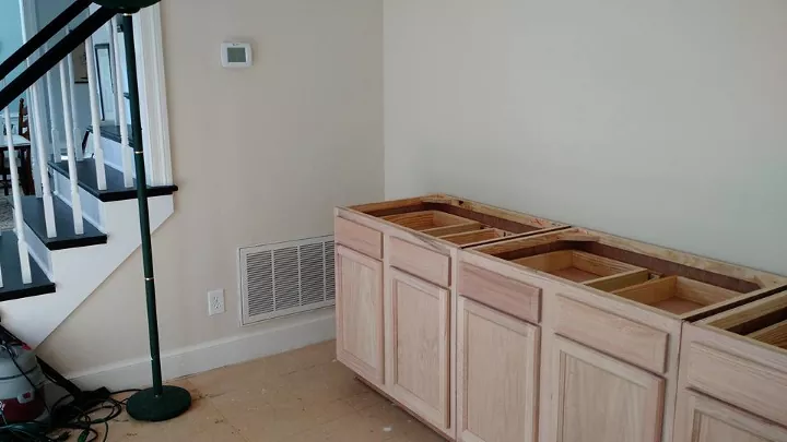

The bookcase will consist of kitchen units at the bottom of the case, then a kitchen worktop, then MDF shelving above. The base of it will look a bit like this:

The cabinets forming the base of the bookcase are exactly as wide as the gap between two walls that they go into:
60cm + 60cm + 50cm + 60cm + 60 cm = 290cm (wall width).
The walls are a bit uneven, but we checked and the cabinets fit perfectly and can't physically move sideways. I guess this would exclude any side-to-side movement, which usually breaks the legs.
The top of the shelf would also need to me secured to adjacent walls, making the structure a 'static load'.
If my assumptions are correct, that leaves me to explore one more sort of breakdown the feet may experience: breaking from the overall load of the weight of the cabinets, their contents, the worktop, the MDF and the books themselves.
Are the feet likely to break that way?
If you have carpet on the floor it's always possible you'll break a foot when you push them in into position. Then you will need to level up each cabinet front to rear and end to end, starting at one end (just like when installing a run of kitchen cabinets).
My own experience of joinery makes me more likely to consider making a single ladder frame up out of softwood (2 x 2in or 3 x 2in square edged, planed), levellling that up then installing the cabinet bodies atop this levelled platform. That is much stronger, more rigid and lower than using kitchen feet (which are normally 125 to 150mm high) and if you use square edge stock can be painted out to match the rest without the need to make up a plinth cover, which plastic kitchen cabinet feet will require, because let's face it they aren't the prettiest of things
