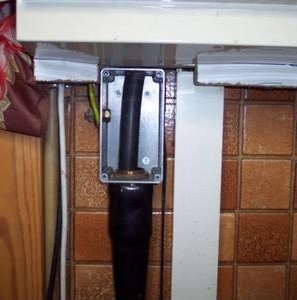

My mate has an swa cable terminated in his CU incorrectly. It's either a 2.5mm² or 4mm² 3 core (I'm guessing judging by the size) but it's just been taken straight in via a big 32mm stuffing gland so the armouring isn't terminated at all. According to what he's told me, it looks like the only knockout left available was a 32mm one and the person that did it for him tried to drill it out as a 20mm but failed miserably (not surprising I suppose !).
Seeing as the CU is internal and doesn't really need a waterproof connection, would it be OK for me to reterminate it for him using a 32mm swa gland ? I know it's massively too big for that size of cable but I was just thinking then at least I could expose a bit more armouring to get in the gland correctly and earth it for him to make it a bit safer.
The cable feeds a small outside shed where he charges his e-bike and leaves a battery tender type charger on his motorbike if that makes any difference.
TIA

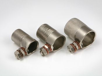

I didn't realise those even existed @Adam_151 thanks (y) Just to confirm, looking at that reducer, I would just fix that to the CU internally with a 32mm Earthing Nut then simply screw the 20mm gland into it yes ?
Yes, personnaly I'd probably use a 32mm earthing nut on the inside, But nothing to stop you taking a banjo out the pack of a 32mm gland and using that and a 32mm locknut, or even just making sure you scrape the paint off inside the enclosure where the locknut tightens down on it. Sometimes you see a banjo between the gland and reducder with a flylead comming off it, and while tehcnically nothing wrong with it - It just looks a mess to my eyes
The suggestion for the 32mm earth nut was because of the limited space below the CU because of a cupboard. I also think they look a lot better than having a hole drilled through the unit and a separate banjo and nut.

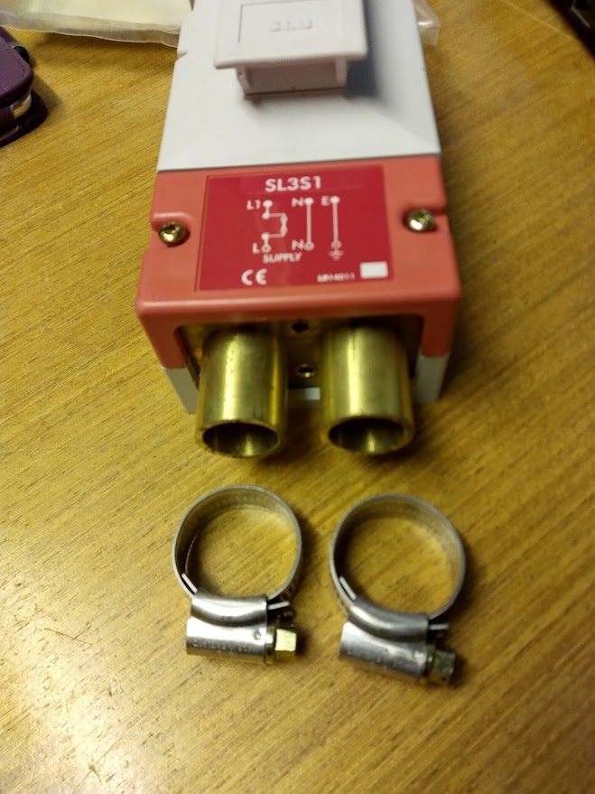

The far end in the shed is terminated in a little plastic 2-way unit with a 16A MCB for the two sockets, a 6A MCB for the solitary light fitting and an RCD Main Switch. The crazy bit is that the SWA is terminated via a BW type gland but there isn't a banjo on it or an earthing nut so the armouring isn't earthed anywhere. It's about 6' from where the cable comes out of the wall of the house to the shed and the cable is clipped along the wall. I was thinking that maybe the installer had earthed the armouring at the far-end from the CPC conductor in the SWA but obviously not ! The overall install is quite neat actually but obviously wrong so maybe the person that did it was just having an off day ? who-knows. The main House CU is metal. I did think the easiest way would be to earth it in the shed unit but (and bare in mind here I'm a DIY'er, not an electrician) that didn't seem to be "right" to me so I looked at the main CU end and figured it would be better to sort it there seeing as there is enough cable/armouring to gland it.
One option for terminating SWA into a plastic CU is this
Not possible in this case as the cupboard below is only about 2" below the CU but thanks for the suggestion. (y)
