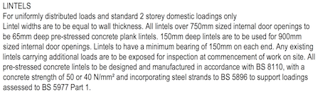

That would speed up the block work a bit (i'm not the fastest!), however that would only give me 100mm bearing for the lintel rather than up to 200mm bearing with the nibs (told to use 1200 x 140 x 100 concrete lintels for internal doors or door width + 150mm either side). Do you think it'd be stronger bonding that block wall together and running the lintels as you said? The rest of the two storey brickwork would then be laid above those lintels.

You dont need 140 x 100 lintels across a door opening - they are far too heavy. Just use the 100 x 65 pre-stressed lintels.
Also, a 100 bearing on the inner skin of the outer wall is not a problem. Because of the 'arching' effect of brickwork and blockwork, the lintels will be supporting suprisingly little load.
You can see where someone might be confused though when the building regs say one thing but it's different onsite. I used 100x65 lintels across drain runs in the foundations although they were only 215mm wide holes. The building regs say 100 x 140 for doorways 900mm (actually says 150 but i guess it means 140!), is this just the guy who drew them covering himself, using standard submission docs?

One or 2 comments on previous comments by others - a) the drawings should at least be to scale if not fully dimensioned b) bldg. reg drawings might specify lintel sizes but that does not mean 'bldg. reg sizes' , bldg regs don't specify lintel sizes for various openings and situations , it is the designer's specification for what should be adequate to do the job but may be 'overdesigned' and more than necessary c) ' You can see where someone might be confused though when the building regs say one thing but it's different onsite' - the drawings should not be different to the situation on site. d) drawings should show what is required to comply with bldg. regs but they can't show how everything is done, which is where this sort of forum helps with many queries.
