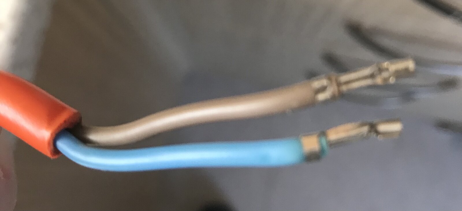

Hi,
I’ve accidentally cut through the power cable of my Flymo Hover mower, which is hardwired directly into the power switch.
I’ve ordered a replacement cable from Amazon, but after removing the old cable; I noticed that it has non-insulated Ferruals on the ends of the wires.
The replacement cable just has the copper strands.
Can anyone tell me what size Ferruals I should be looking for & any links to the Ferruals or a reasonably priced crimping tool?
Thx.
You don't need ferrules.
They make life easier / quicker on the production and assembly line and ensure no 'stray whiskers' of copper are there.

Though you may find the ferrules also stiffen the cable enough to allow the cable to push into the terminals
