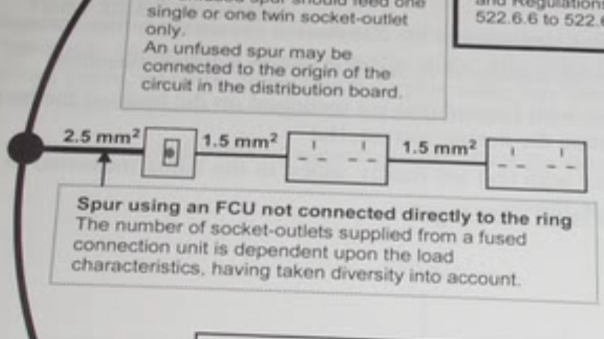

Option 3 is a spur on a spur which is not allowed on a ring final.
Where does it say that?
Simple answer is - it doesn't say that anywhere!
As is done to death on here, it doesn't actually stipulate in any circumstance apart from an unfused spur, so through an FCU the only limiting factor is the load,cable and of course the obligatory diversity calc. FAO Winston
