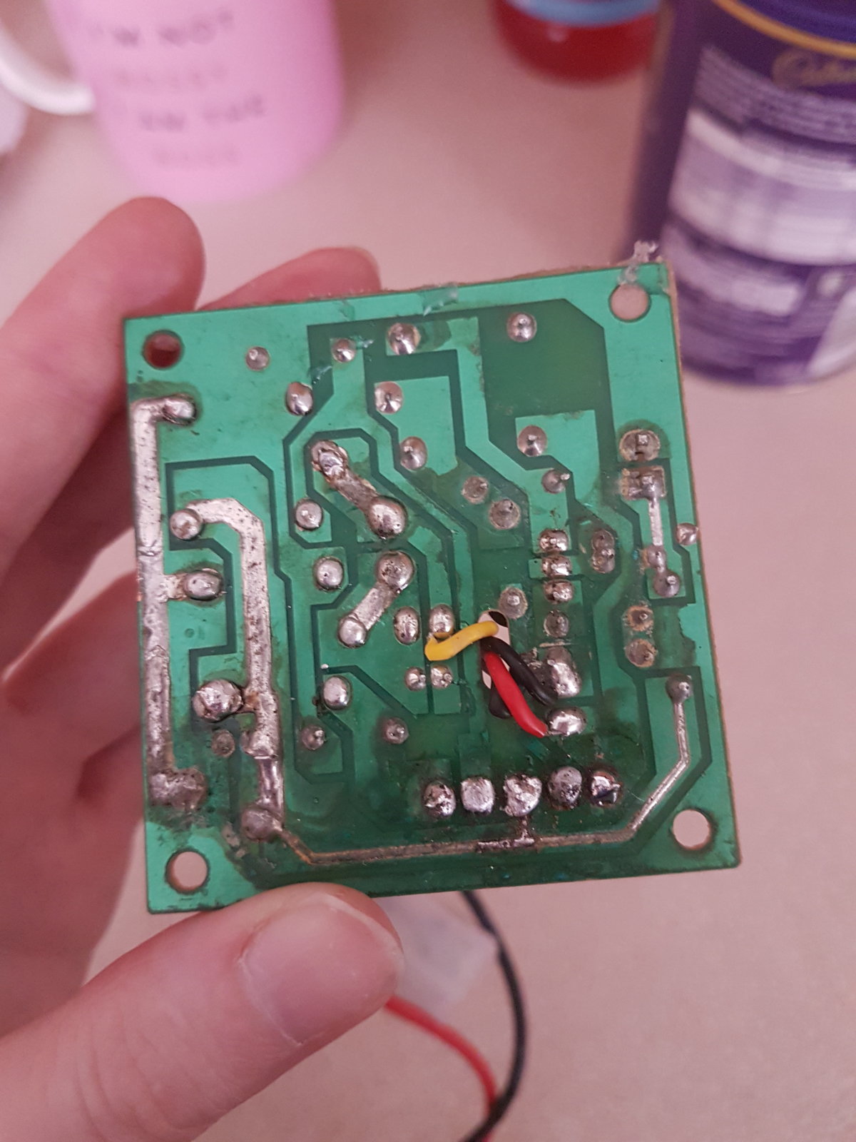

A dry joint won't necessarily show up as a dry joint by wiggling, they are usually caused by heat building up during current draw. Most of those joints look slightly oxidised & I would be inclined to re-sweat them while it is out.
Ok so basically just reheat the solder on them all?
Out of curiosity iv just noticed one of the relays isn't flat to the board could that affect it at all?
Reheat & apply fresh cored solder so that the flux allows clean contact. The relay not being flat should not affect it's operation as long as all the pins penetrated the board.
Ok fresh solder on them :p

Omg you are amazing I had given up all hope so I guess now i need to swap the motor wires back or the switch will work in the reverse directions right?
So... are you saying it works again then? Just back to front from the correct way due to the motor wire swap test?
I'm thinking that's what will happen it's hard to say for sure that's happening because the switch don't say up and down on which makes me wander if it's possible to just put the switch the opposite way into it's place so it wouldn't require swapping wires back. Yep it 100% goes back and forwards now just can't believe Its fixed. And why mum's hubbys work mate didnt know that solder was useless I don't no they r electricians. Ok so it cost me £15 to repair. (£4 for relays, £8 for a soldering iron and £2 for solder ( bought when it didn't work still as I figured at that point there had to be a break in circuit some where) It just wasn't in the spot I tried lol

No, definitely swap the motor wires back over. Didn't you say the car had lights too? The reverse lights will be on going forwards and the headlights on when going backwards for example!!
In hindsight, maybe the relays were fine, but I did say to take them out and test them with the multimeter first before buying new ones!! :p(y)
Well done for fixing it though.
