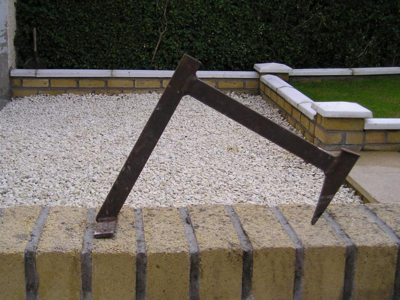

Alistair tell me more and are they going to be useful to southern style roofing. Birmingham you have to remember this is a diy site.
They can be used on any roof!
The brackets are spiked into the rafters/trusses and a batten laid across to create a working or access platform.
//www.diynot.com/forums/viewtopic.php?p=1260497#1260497
View media item 63416

Just 1 point i would like to pick up on from that document, they state that the spikes are driven through the sarking boards! in reality you would always aim to spike through the rafter centres as the main supports for the boards and spiking through the sarking to give mid span support.
The brackets have a habit of twisting over if they are not driven all the way home...especially if through the sarking.
Thanks Alistair for the information but I don't see how we could use them on a slated roof in Lancashire, due to the way we nail them on.
I wouldnt use them for re-roofing where i had tile battens to use!
I would use them for things like velux, hip ridge work etc.
