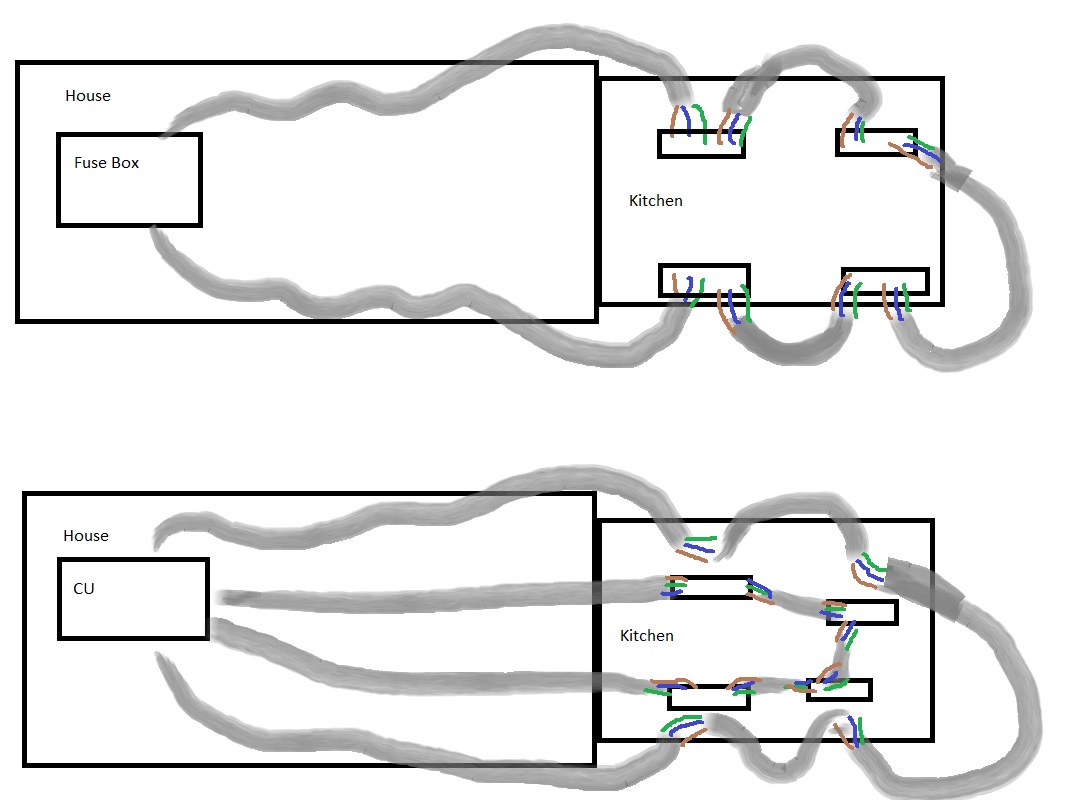

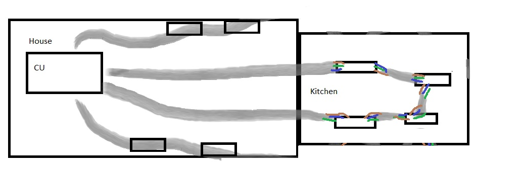

Hi all. I am having a new consumer unit fitted very soon as I am on a really old fuse box which has been extended over the years (previous house owners) and it looks like something from North Korea. The new consumer unit is being done by a real sparky by the way.
The house is currently all on one ring main, with dedicated circuits each for shower and cooker. When the new unit is put it, I will be having the kitchen on its own circuit.
In prep for this I need to run new 2.5mm cable for the kitchen and put in a new cooker isolation switch in the kitchen as the current one is too far away and under the stair cupboard!
So, I have two parts to this for the prep as follows...
To save disruption and ring main traces cut out and re-splice the main ring main (this all needs to be done in one day ideally), I will be prepping by taking off the sockets in the kitchen and "passing the existing ring main cables through" and then connecting the sockets back to the new 2.5mm for the dedicated kitchen circuit. I was originally going to use connector blocks but then saw the following two products and felt they might be even more ideal, one for each Live / Neutral / Earth, stick them back in the backbox and put the socket back on. My question is, is this right and ok?

I don't really understand what you intend to do with the ring circuit in the kitchen.
Do you mean you are going to connect the existing cables together and then connect the sockets to new cables?
If so, I think that a daft idea.

Hi EFLIpudence. The intention is as you describe, take the existing sockets off, connect the existing ring main wires together using the connectors I linked to above, then put the sockets back on with new cables which are then on its own circuit. This was suggested by an electrician as a means to prevent tracking/tracing wires which in this house, could run anywhere (I even have a wire going diagonal up a wall). Yes the house needs re-doing but, it isn't happening anytime soon.
The method suggested would mean the existing ring main can take the same route it does now but does not have sockets connected anymore in the kitchen, they just "pass through".

I'm still not sure exactly what you are trying to achieve.
Can you sketch a diagram and post it here?

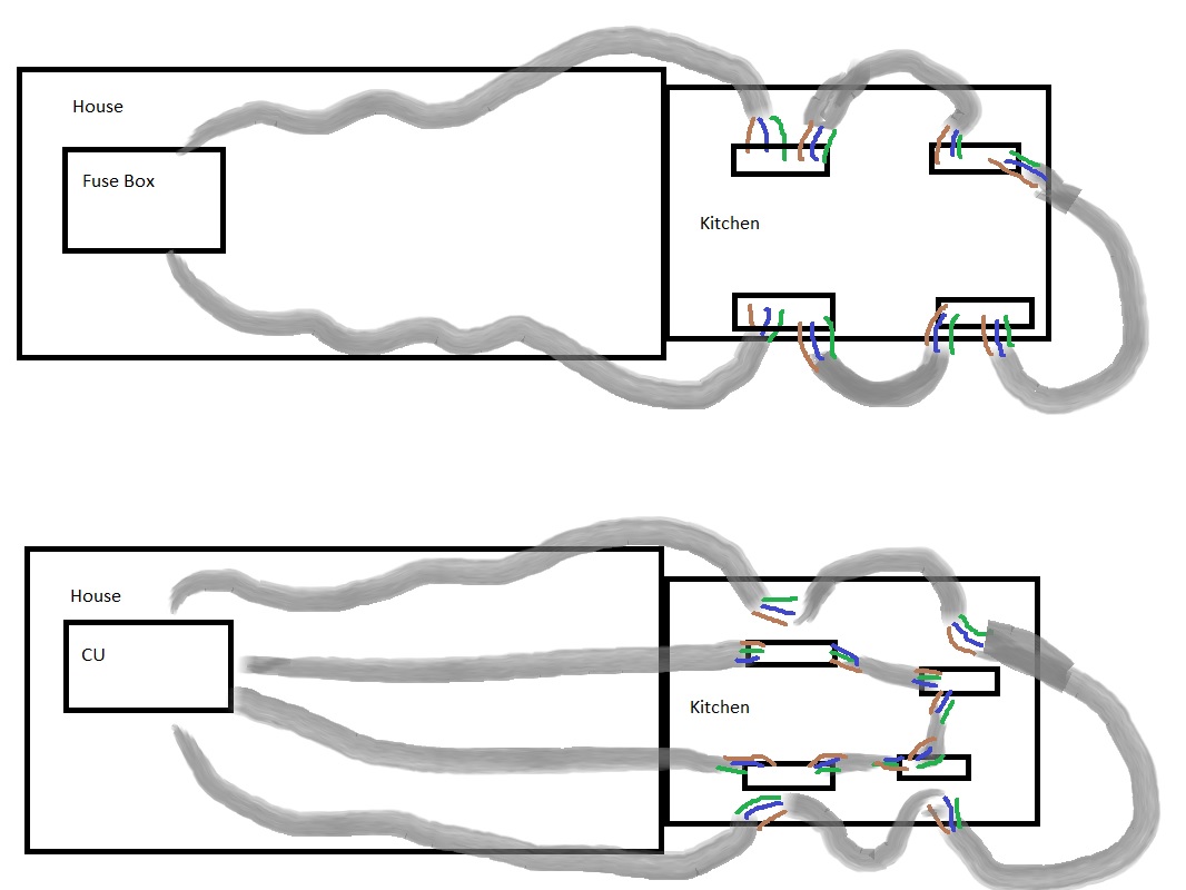

Fingers crossed the attached picture explains far better than my words. The top diagram is the current ring main on the fuse box, it goes all around the house including the kitchen. I need a new CU immediately to replace the fuse box and would like the kitchen on its own circuit (dishwasher, washing machine, tumble dryer and other things like mixers etc the wife likes to have running at the same time). Lifting up floorboards, taken down ceilings etc is not an option and so, to get he new CU and a new kitchen circuit it was suggested to do it like the bottom diagram which is, connect the existing ring main together behind the sockets in the kitchen and run new ring just for the kitchen sockets.
Basically, the house ring stays how it is in the walls, ceiling, floors etc but now has no kitchen sockets on it, the main house ring main now just passes through the kitchen sockets. I hope I am making sense now :)

Drawing is ok.
I see what you are trying to do.
It's probably impossible to advise without knowing the exact route of the cables but I don't like the idea.
As the kitchen will use most of the current on the circuit, and the rest of the house very little does it matter?
What about making the present ring two 20A radials and disconnecting the cable at the last socket before the kitchen both sides (if both sides have sockets)?

Unfortunately the first socket coming out one side of the existing ring is the first socket in the kitchen so if I disconnect it, it goes nowhere else. This would have been a good solution. The rest of the layout is potentially very random so hence just trying to leave it in situ, the house can be fully re-wired in a few years time.
Would you be able to advise off the bat though that it's not against regulations to begin with, what I was intending to do?
Then just one 20A radial and disconnect the socket on the other side.

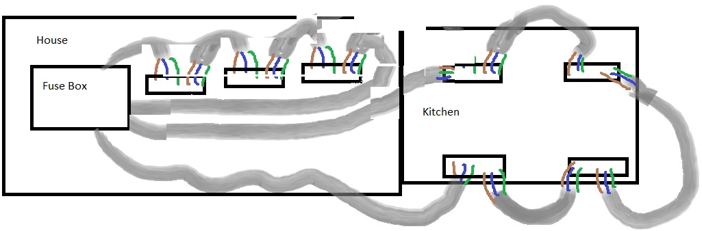

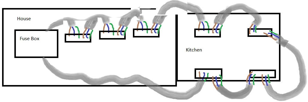

If I understand correctly you have this sort of layout, IE the kitchen is the first part of the ring and you can get access to each end of the kitchen:

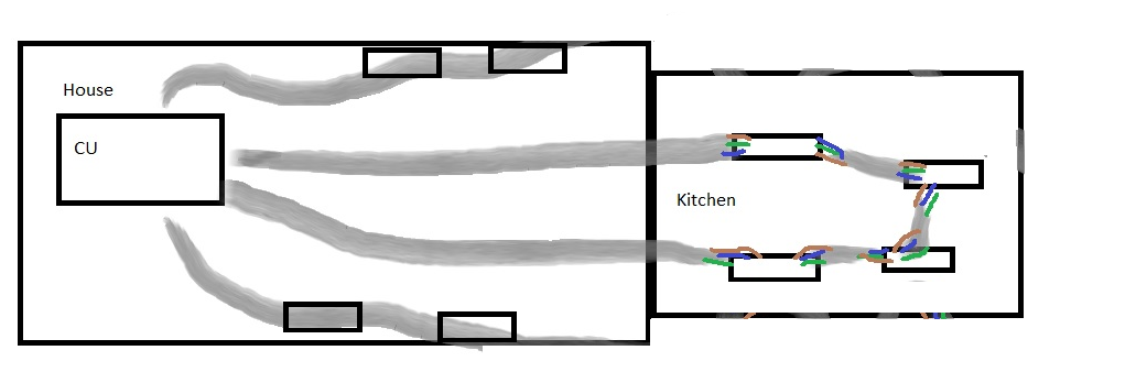

In that case split it once and run two new cables from the CU to one point:

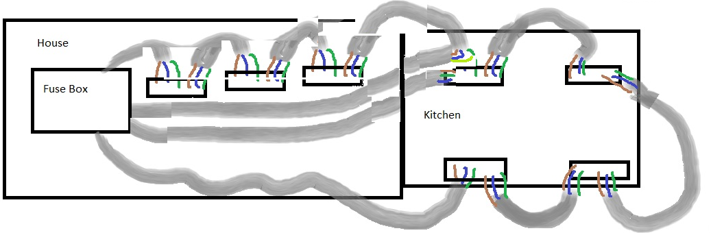

Or this with join in kitchen socket:
Oh and excellent drawing, it describes your plan perfectly.

I have just been using a metal/cable scanner on the walls and using that with my memory of some wires when the edge of floorboards were up before carpet etc, trying to draw a picture of the ring how it is today but unfortunately, I lose the wire at the end of the kitchen! It goes up the wall and simply stops! Unless it's floorboards up and potentially even part of the kitchen ceiling coming down, I don't think this ring can be traced effectively. When they did the kitchen extension they clearly extended the ring circuit but, lord knows how and where!
Not sure what to do now. ie, the original idea seems easiest but obviously getting the hint from here it shouldn't be done like that. The original sparky advised he was going to do it like I originally diagramed but I am using a different guy now and was hoping to make life easy by prepping the wires so he can just connect up.
Hurting my head abit with what to do for the best. :unsure:
