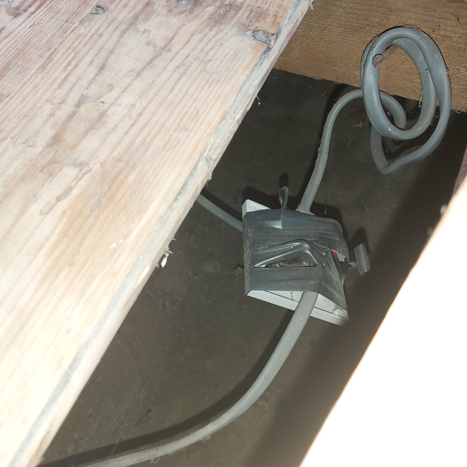

Ok, progress. I took onboard the inputs on this thread and went back again from the beginning, this time though just bit the bullet and pulled up floorboards and did some tracing to see what can be done to chop out the kitchen and extension from the main ring circuit, re-join just the house and then join the existing kitchen wiring back to a new circuit, no more trying to "pass through" the wires.
Well, the excercise today was hard work but very enlightening to say the least. So far I have found, loose socket connections, a floorboard nail directly through an earth cable, a socket earth wire sheethed with black instead of green or green/yellow and a spur 3 meters from its master socket but upon lifting the very next floorboard next to the spur found the main ring cable running pretty much below it (just why not spur from there a few feet at most or better, no need to even bloody spur it). Not to mention sockets where the cables are SO short I spent 30 minutes putting just a single one back on!!!
So, my fears were realised, it's hard work and the place needs a full rewire! However, I guess a rewire isn't going to happen for a few years so, a bit of pain now is actually worth the effort. Hopefully i'll be able to report back the job has been done successfully soon.

Three metres of cable is cheaper than a junction box.

Just a quick addition to what I already listed; check this picture out of one of the spurs found under the downstairs floorboards. Fancy a spur? Just add a socket under the floor, spur off it and tape it up. Top job!
Well at least it was taped up(y)
