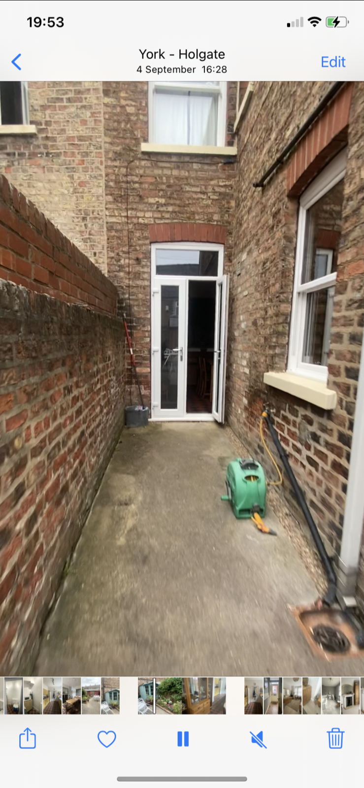

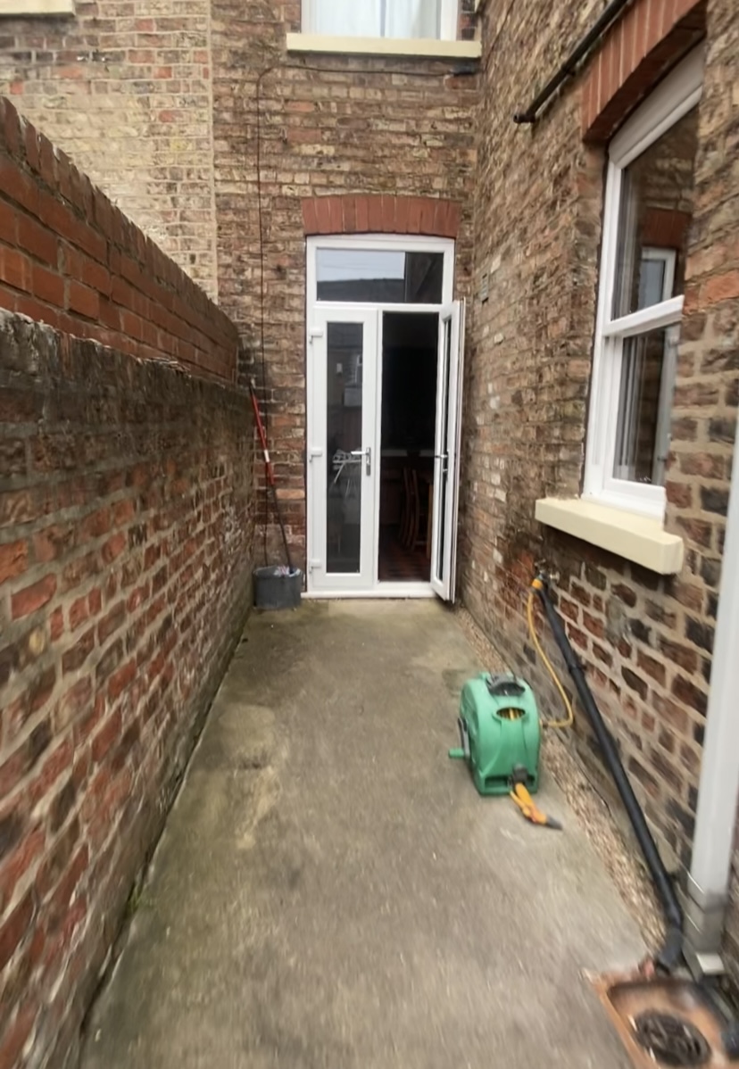

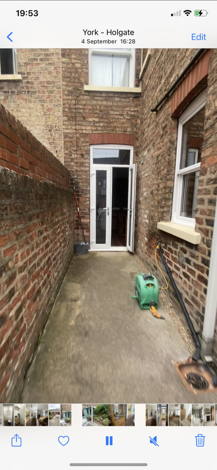

Interesting… I will have a look for a water source there. Could there be a leak beneath the concrete in the yard?
I think I can see a grey gutter downpipe behind the corner, close to the black soil and wastepipes.
Depending on age and district, they probably go into the same "manhole" in salt-glazed brown clay pipes.
Between 1940 and 1945, these were broken or cracked in most towns and cities due to movement caused by bombs, and have been leaking for 80 years.
I have never see an old house where they didn't leak. I'm told there is one, but I have never seen it and I don't know where it is.
The water supply pipe probably comes in from the road at the front, under the floor. If you have a back lane, it might come from there. It is also likely to be leaking.
Ok thanks. This one here?
That is definitely something to be looked into. There is a back lane too. Although sounds difficult to remedy? I don’t know whether to just run a mile with this house but it’s such a difficult market at the moment!

yep. to my eye the bricks round the tap look wet as well. See the difference in colour?
Digging up old drains is not a bad job, in warm sunny weather. You need a couple of strong women to do the heavy digging, but it's not a complicated job.
The problem is common in hundred-year old houses. Bodging will nor cure it, but repairs will. The DPC has probably been bridged. The gravel trough against the wall might be an attempt to let water drain away or dry out.
I's say it could be a drainage issue as per John D. The terrain around the outside of the French doors is not ideal in that it is a moisture trap, with little chance for wetness (especially in winter) to escape.
Yes there’s a definite difference in colour.
