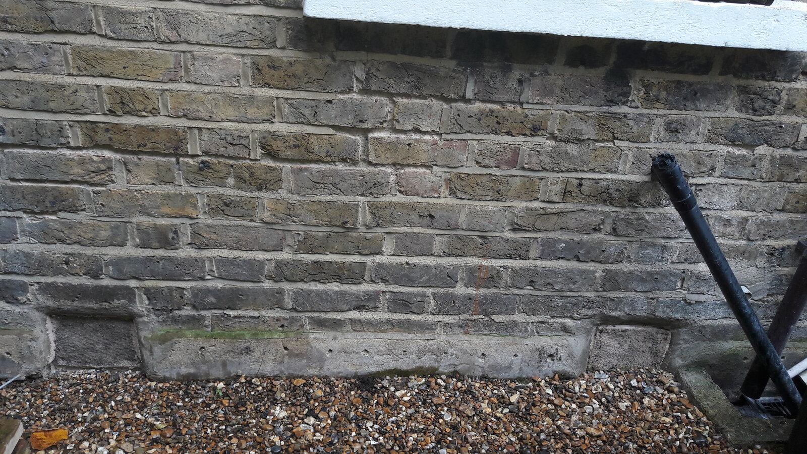

please do stand back and take some wider pics
All your photos are too close.
Are you on a hill?
The patch of gravel next to the back door is very wet. Is there a downpipe, drain or driopping gutter?

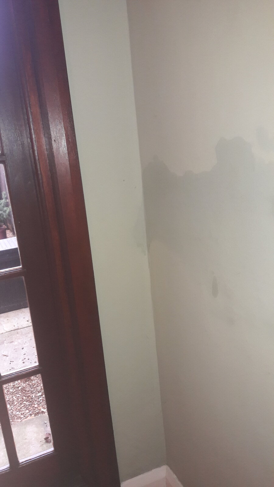

It is about 9 inches thick from o/s brickwork to interior plaster. Here is a pic of the interor of the o/s wall
As you can see there is v little damp on it.

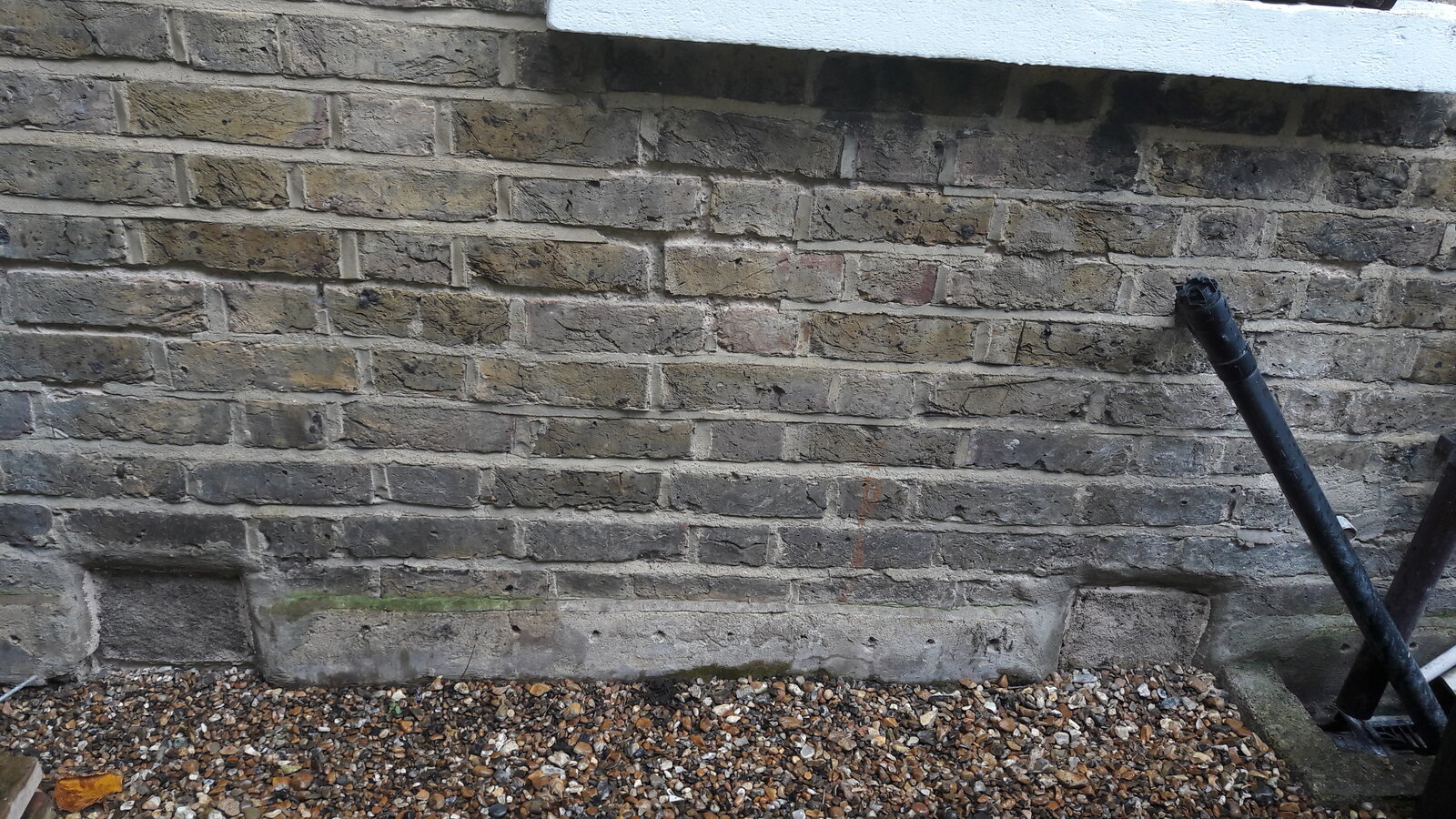

Here's the pic showing full elevation.
I do remember the neighbours mentioning that they had had an issue with their floor, right next to where my problem is. I remember them saying that the floor was wobbly and the cause was due to a lack of air bricks. I saw my airbricks and no wobblyness so thought I was OK. How wrong I was.

Looking round the house, there are 3 further airbricks. All of them, like the one pictured, are above floor level and don't seem to go anywhere. i.e. directly on opp side of them are skirting and plaster. It's all a bit confusing.

Photo's of her wobbly floor at the wall/floor abutments, and the walls above it - ie, party wall & outside wall.
Pics of her outside elevation like the pic you've posted.
If you go into her house then try and get low and see if you can smell rotting wood or a mushroom smell near floor level - sounds odd but it works.
The yard dividing fence last upright post should have a strip of DPC material isolating it from the wall.
To do a proper pointing job then the post and last fence panel should be removed for the pointing and DPC strip.
The fence base brickwork should be isolated from contact with the wall.

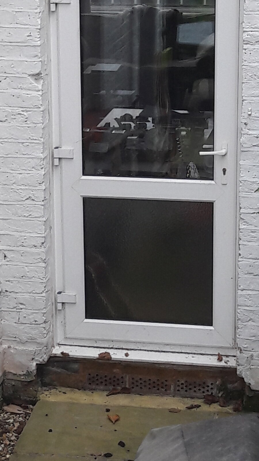

I had a look over the fence and saw a long airbrick at ground level underneath her french doors with no step in place. I guess this is the sort of thing I need doing. When possible I will post a pic of this.

Your house is on a slightly lower level than your neighbour - which could mean your houses are on a slope receiving more ground water than more flat locations.
The new pic of the party wall implies penetrating damp from the pointing & maybe the door sealing? The neighbour's have painted their brickwork which might give a bit more protection from penetrating damp - but i'd imagine some damp signs would be on their walls?
Remove the air brick and remnants of a S&C plinth on both sides of the step - remove any plinths from around your house.
After re-building the step etc (as above) then install the kind of vent your neighbour has in the step riser.
From the interior have you examined above and below FFL on the left hand side of the doorway?
Have a look at the kitchen wall/floor while you are at it.

youll be remedying that until youre blue in the face. chop it all off , tank the whole wall and corner. render 4:1:1/2
sand cement lime with waterproofer/salt inhibitor and skim.
youre welcome!
Just hack it off and replace in lime, its hygroscopic salts leaching out of the plaster which draws moisture into it when humidity levels rise. Ive got a few spots of this in my old victorian house. In places where water cant physically get! Its merely salts...
Spoke to the neighbour last night and he tells me the wobbly floor was on the other side of the house, next to the party wall of the next terraced house along and that it was due to loose floorboards. They noticed a musty smell when they removed them and got the builder who did their kitchen to install two airbricks at the back to go with the two at the front of the house. One is the long 3 airbrick assembly below their patio doors (pictured). The other is a single airbrick below their kitchen door which provides airflow through a pipe buried in their concrete kitchen floor, to the suspended floor of the rest of the house

The three brick vent under the neighbour's sill is a good solution to be built into any new threshold on your side.

As advised above the ground level has been raised & it needs lowering. Your neighbour's have lowered their ground level.
Likewise, the plinth needs removing and the pointing angle grinder'ed out and then repointed with a sand & lime mix - feeble previous attempts have been made to repoint in cement and sand, the S&C has failed, and might be trapping moisture esp. outside your dining room?
