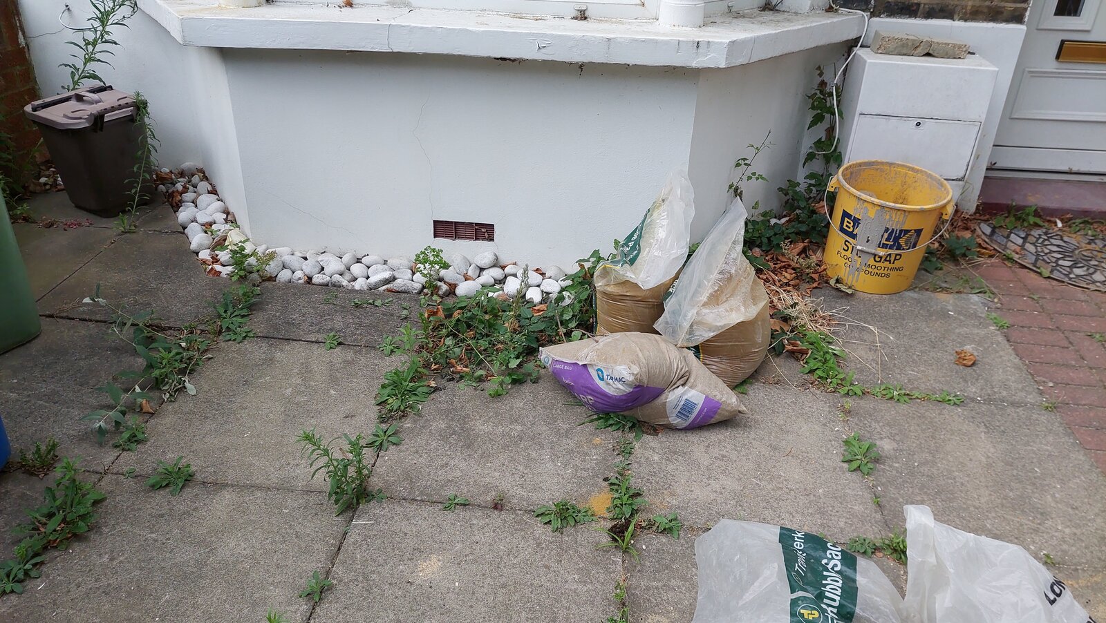

And the only two air bricks - one in the front bay, & one in the rear elevation, are way too high for venting the sub-area.

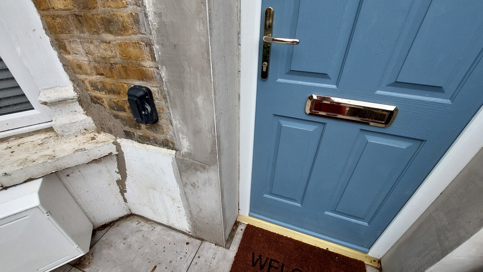

I have raised the ground outside such that it becomes a slope and the front door threshold is now level with FFL inside and outside. In the process, the air brick got partially blocked.
I am wondering if it will help if I dig a trench around the bay window such that the air brick can be unblocked. One of my neighbours did this. Another neighbour even exposed the bottom part back to bricks. They are the only ones who have done work to the bay window floor area on the street. Presumably if it is rising damp, it should affect my neighbours too?

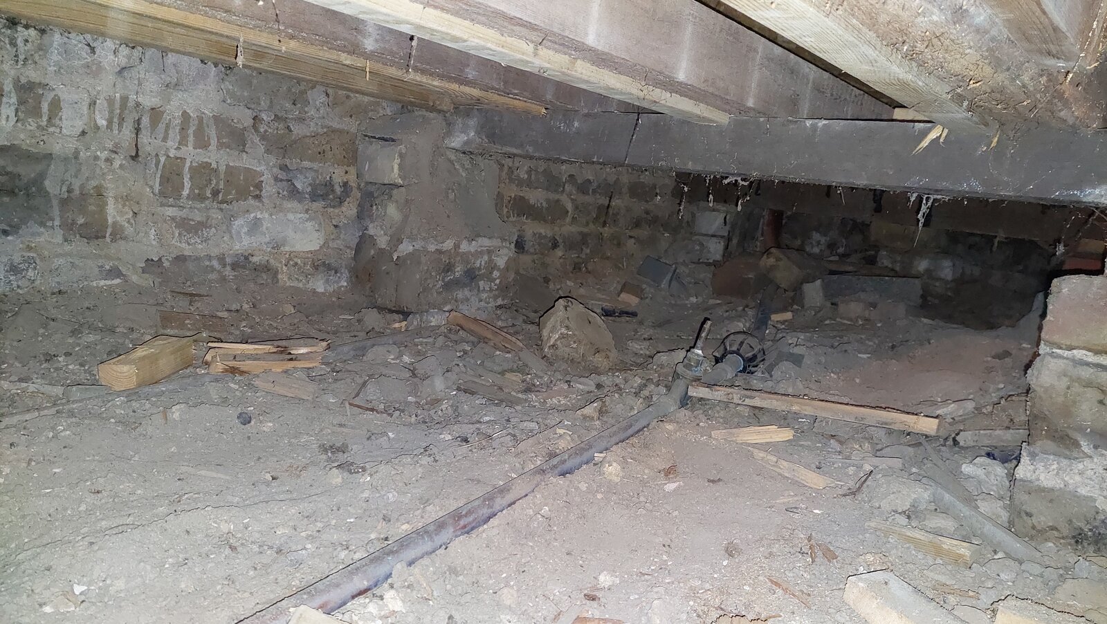

May I ask about the joists?
Some seem to think that your original joists were rotten, hence more evidence for 'rising damp' - whereas I see joists in decent condition, that you have doubled up for rigidity and insulated. The ground beneath also looks pretty dry, in your original photos.
Was this the case?
Was this the case?
The darker joists were the original ones, and then I have some new ones added for levelling and insulation. The ground below was generally quite dry. I didn't find signs of damp before the renovation project. The damp is found after the renovation is complete, and only on one external side where I have raised the floor level outside.

Your ground level is very close to the bottom of the airbrick, which in a property with a DPC would be a problem.

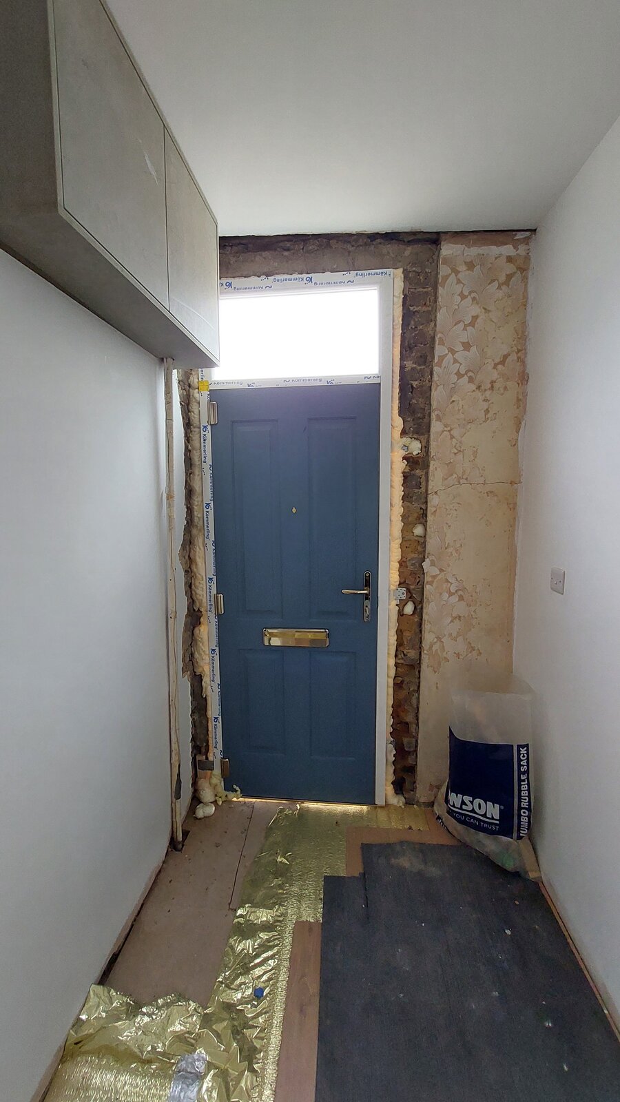

An update after a few weeks where I have fixed the render cracks and filled the gaps between the doorframe. The damp is still there and is more visible after rain and will disappear after 1 or 2 days of dry weather. Given how high up the wet patch goes, and there is a line of water from the middle, I am starting to think this is less of a DPC issue but water ingress from outside. Any pointers or advice will be appreciated. Thank you.
Please see below a photo before the plastering was done. Some expansion foam used to fix the doorframe. Would that be the cause?

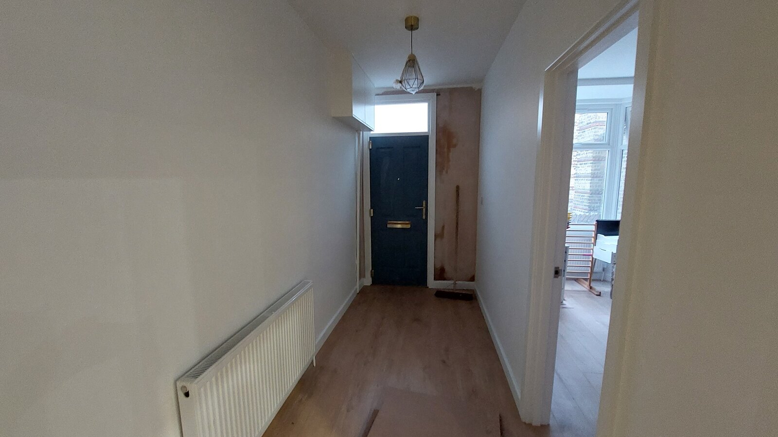

This photo was taken approx 1 week after plastering was done. You can see that the wall is mostly dry except for the same area where there is damp today.
How it looks today.
