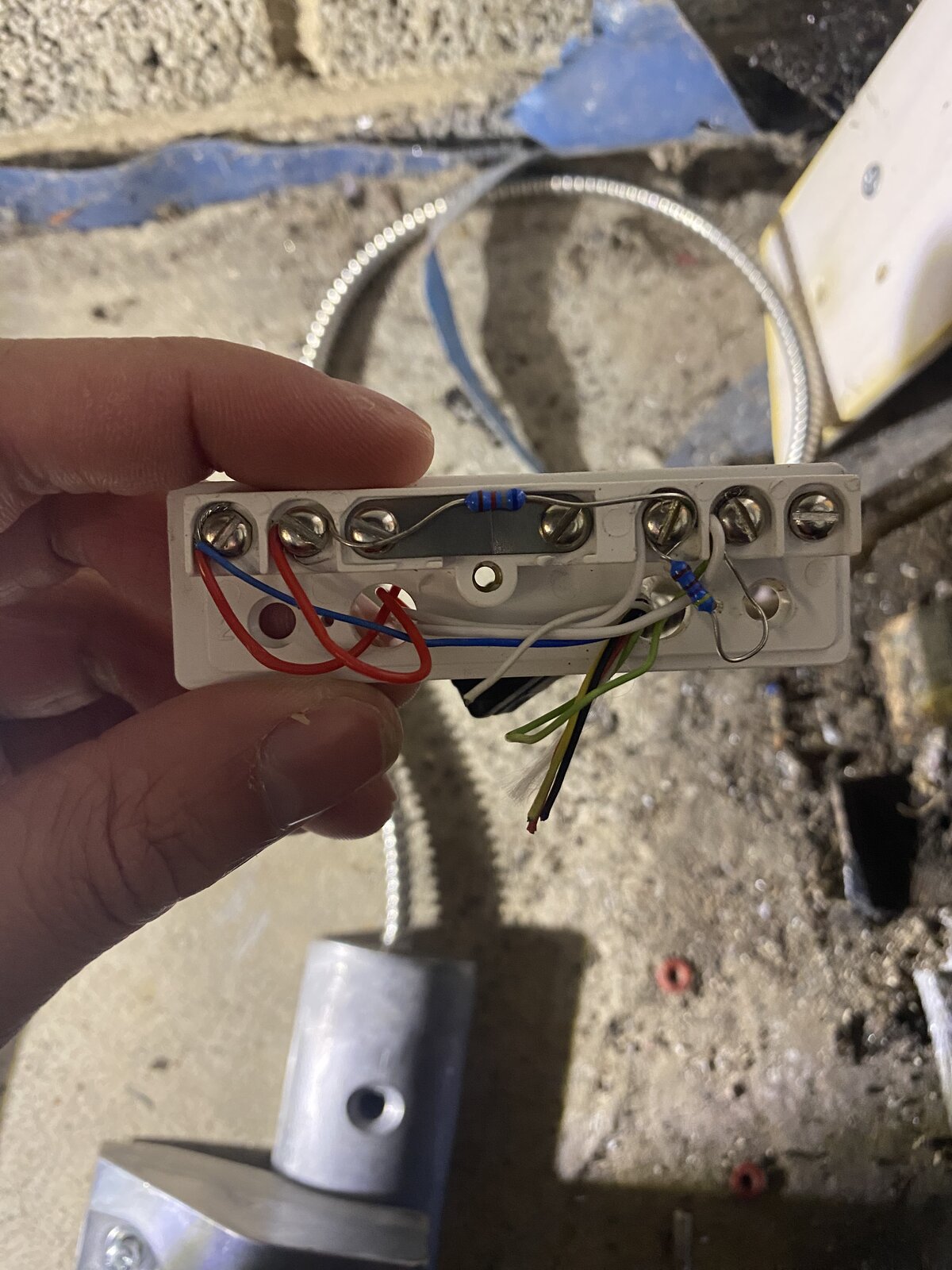

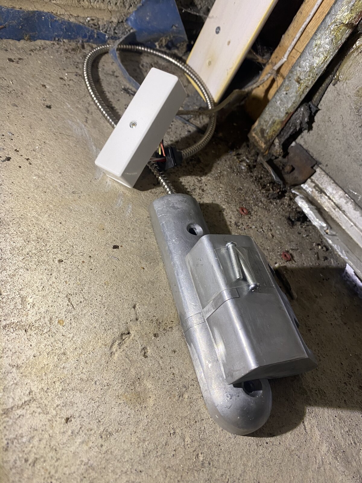

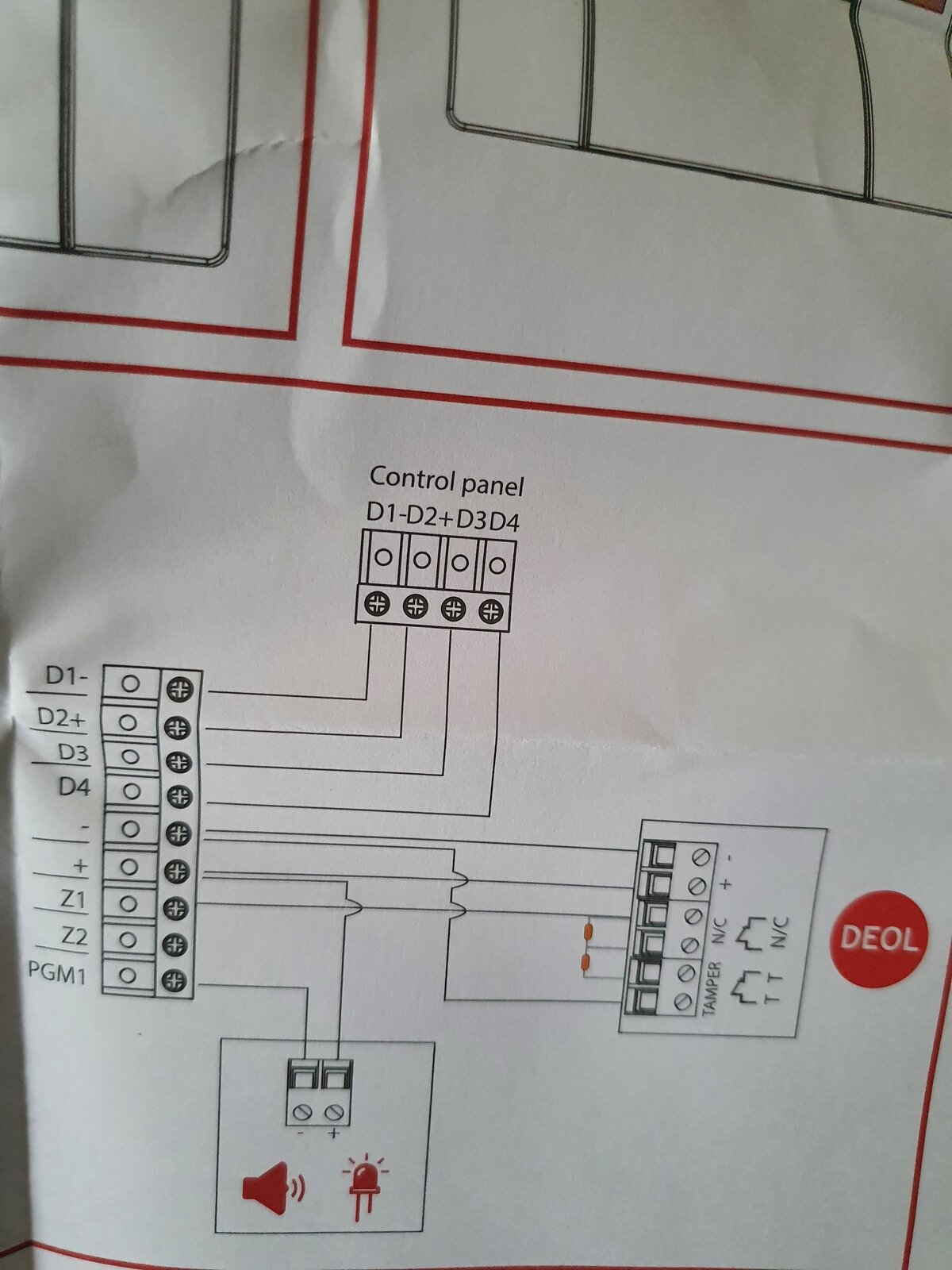

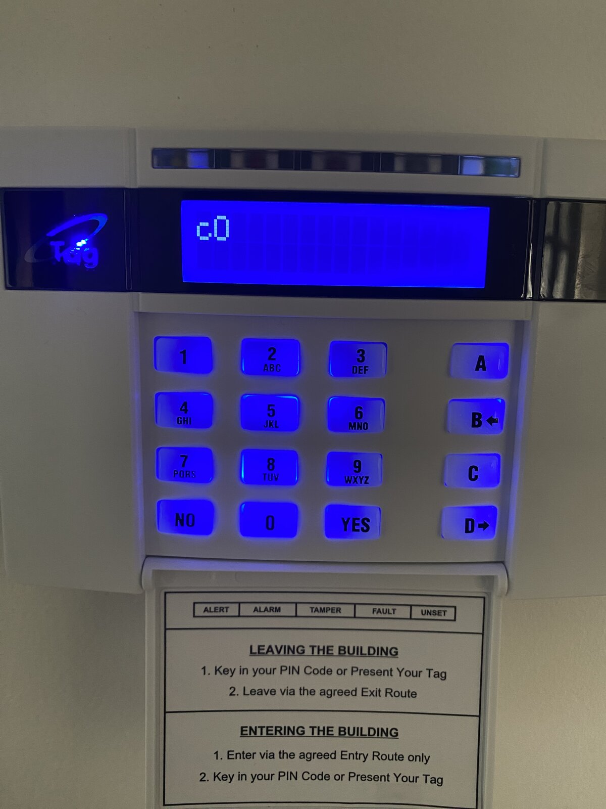

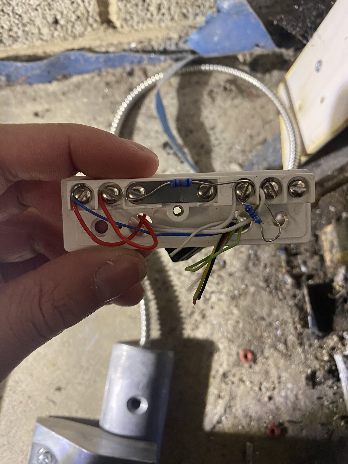

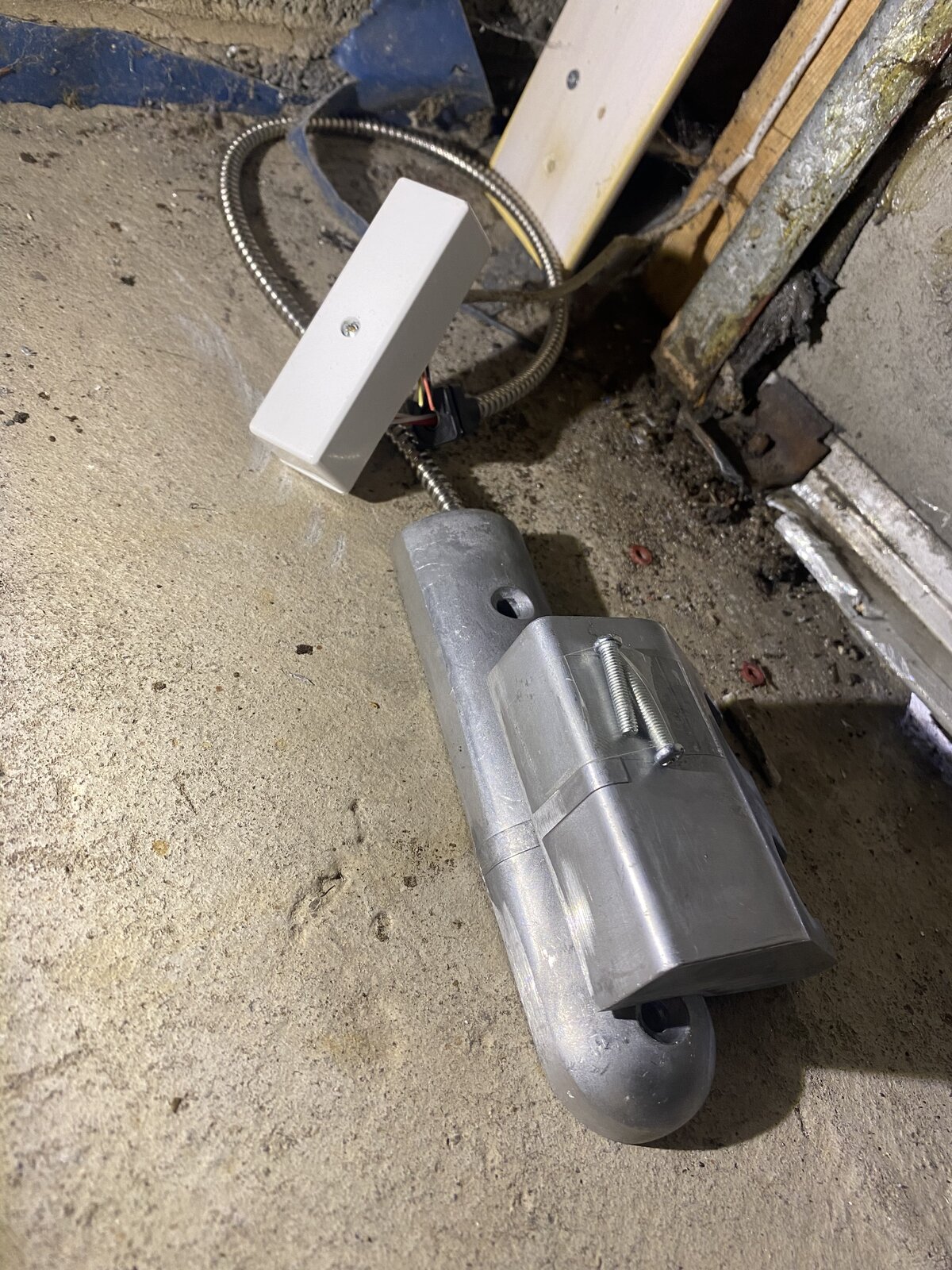

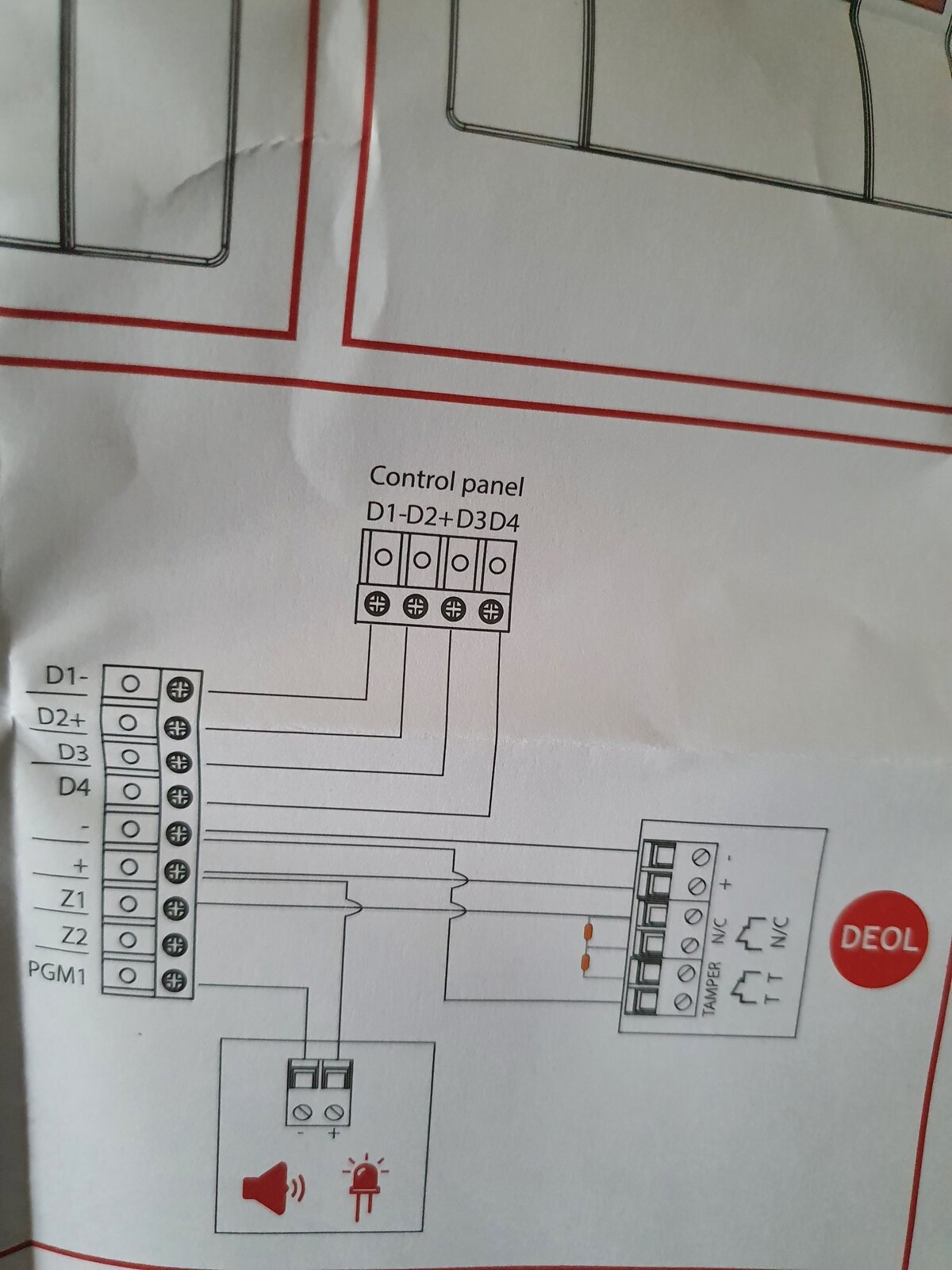

Sorry for the late reply, i attempted this again today and it shows Open circuit, I have attached some pictures ( note that I just realised I didn’t put a 2k2 resistor in but dont think this should be the problem right?)
Blue goes to - on keypad
Green goes to Z2

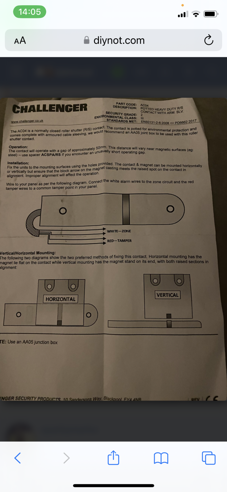

20221212_132445.jpgcan you confirm reds are tamper pair and whites are alarm pair?
Does look OK from photo.Do you have multimeter? Check pair blue/green go from door to keypad and wired as diagram.

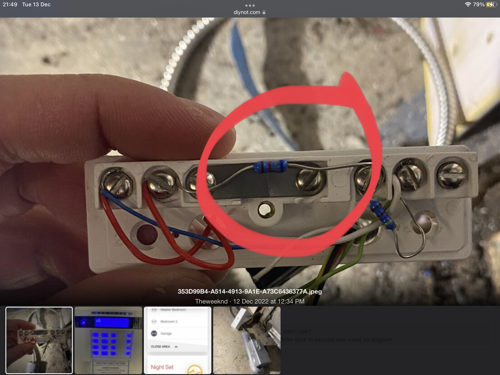

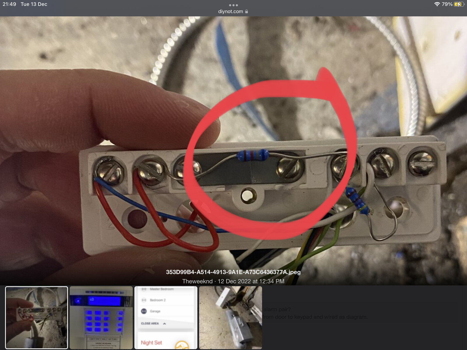

That’s not a 2.2k resistor ! In the junction box ….looks like a 6.8k resistor
If you have multimeter
Set to ohms
Across blue/green in junction box with magnetic closed on contact you should have 2.2k
Remove magnetic you should have 6.8k
That proves contact is wired and correct.
May need to check cable from door to keypad.
If still not working wire contact on short fly lead directly onto keypad.
If still not working the programming issue.
The above should prove one way or another if correct .
U also said the door contact was wired on to z2 on keypad ? Have u changed this ? How many keypads u got. Also if you press yes when in the keypad diagnostic menu it will show u the zone resistance so see what it is open and closed
