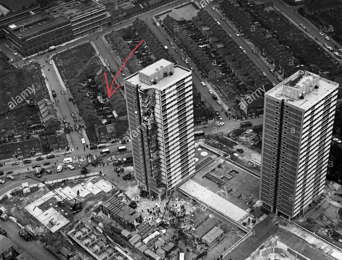

I think gas was used as a scapegoat here. There were other serious problems:
  • it was not adequate for expected wind loading, since the wind speeds which the regulations required to be considered were much too low for a tall building—in a high wind, an upper wall panel could be sucked out, leading to collapse similar to the actual collapse
  • it was not adequate in a fire, a significant fire could lead to bowing of the structure, followed by collapse as above.[7]

There may very well have been other problems but let's look at the facts as I remember them:
1) A gas leak [of some type] occurred in an upper floor about 3/4 of the way up the block.
2) An explosion occurred when the female tenant lit the cooker.
3) The outside walls of the kitchen and lounge disappeared.
4) Everything supported by the missing walls fell.
5) The weight of the debris falling onto the lounges below made them collapse.
6) The builders were found to have not installed the precast sections correctly, using cardboard instead of the proper products.
7) The building was repaired to the proper spec and repopulated.
8) Public pressure got the building dismantled 15 to 20 years later [note dismantled and not demolished] for precise examination.
9) As a result of 8 above other buildings of the same design were in use for many more years.
10) There were many many buildings built to this exact design and I believe this was the only one to suffer in this way.
11) When demolishing buildings to this same design they do not collapse in the same way without the use of a massive explosion comparable to that of the gas incident [tested and accepted].
All of the above is from memory, I would say I was about 11 or 12 at the time [1966-68] and I'm pretty sure it was about 1985-87 when dismantled.
If any details of 35 to 50 years back are incorrect I offer my humble apologies in advance.
As I understand it the cooker was repaired and the lady made a good recovery but a handful [very few] lost their lives as the tower was quite new and not fully let.
Lastly I don't believe anyone apart from Winston has any doubt about a gas explosion being the cause of the incident.

The walls were so loosely tied that ( from memory ) anything that created about one bar difference in air pressure between inside and outside could have dislodged a wall panel.
Quoting from HERE
Abstract
In the early morning hours of May 16, 1968, the occupant of apartment 90 on the 18th floor of the 22-story Ronan Point apartment tower, in London, lit a match to brew her morning cup of tea. The resulting gas explosion initiated a partial collapse of the structure that killed four people and injured 17 (one of whom subsequently died). On investigation, the apartment tower was found to be deeply flawed in both design and construction. The existing building codes were found to be inadequate for ensuring the safety and integrity of high-rise precast concrete apartment buildings. The Larsen–Nielson building system, intended for buildings with only six stories, had been extended past the point of safety. The tower consisted of precast panels joined together without a structural frame. The connections relied, in large part, on friction. The apartment tower lacked alternate load paths to redistribute forces in the event of a partial collapse. When the structure was dismantled, investigators found appallingly poor workmanship at the critical connections between the panels. Subsequently, building codes in many countries have adopted structural integrity or “robustness” provisions that may be directly traced to the Ronan Point collapse.

Ironically if the explosion had been on a much lower floor then the extra weight on the wall panel joints may have prevented the panels from being dislodged.
Yes I saw that, and if higher there would not have been so much weight to fall and destroy the lower floors. Very very ironic
I vaguely remember comments about there being no fire or fire damage suggesting it had been a very low energy explosion.
Didn't it result in gas being banned in all such blocks, I seem to recall an old college tutor of mine saying that when he was on the tools in the 60s it was difficult to get the MK cooker control units (presumably the huge 6" square ones) because they were all being used on jobs to retrofit cooker circuits into tower blocks. I do recall when looking at the DNO risers in tower blocks locally that out of two blocks, the later one has much more uprated supplies (presumbly as it was designed from the get go as all electric), although there were no overload issues in the other one AFAIK
Yes, hysteria about gas being incredibly dangerous and causing whole blocks of flats to collapse, so ban gas from high rise buildings.
Also partly responsible for Corgi (now Gas Safe).
In reality the collapse was due to multiple failures including design of the structure and incorrect construction of the building, gas was just the trigger that caused the inevitable collapse.
