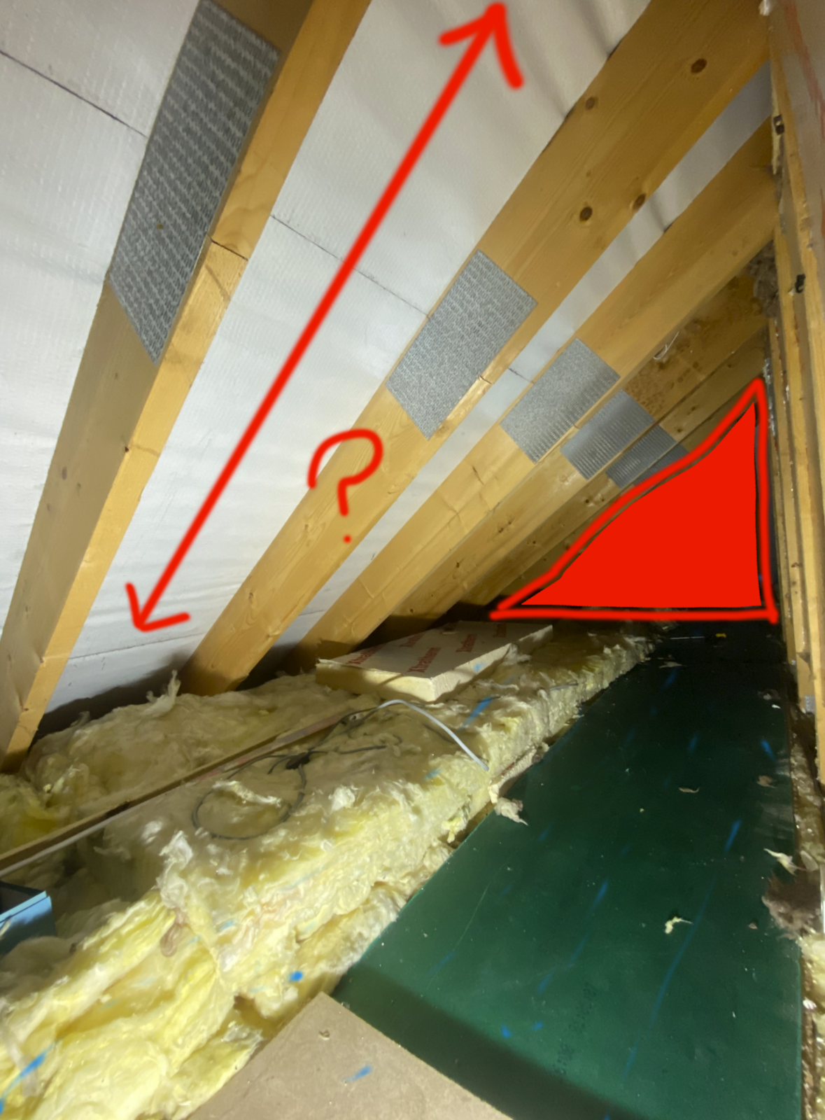

Teading your comment it looks like it also would involve removing all the white membrane and swapping that out? so tiles off, basically re-working the entire roof?
That's probably the extreme case; I was more thinking it prudent to access and insulate the roof from the outside for the parts that are inaccessible from inside..

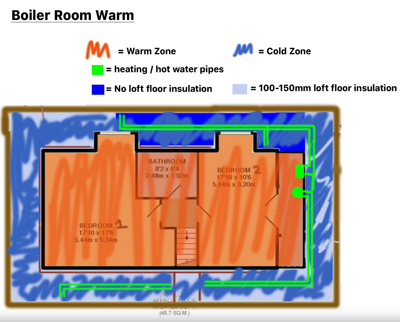

I agree, whatever happens with the loft space on the other side of that boiler room 'wall' Even if that does stay as a cold space, the boiler room will be made into a warm space. As shown on the video, roof-wise in that section it looks like someone started to do it and give up as it does have 100mm celotex in the rafters. Im going to insulate that properly and double layer plasterboard for good measure.
It's the separation of the boiler room and the cold loft on the other side of the boiler room wall that I think is going to be harder to insulate entirely. Partly as the 'wall' is just a big piece of plywood with a big section missing which needs to stay for loft access.
And even though all the boiler pipes start in the boiler room they do run through that plywood 'wall' to the cold side before wrapping back around. Without having those entirely re-routed they're always going to largely exist in the cold space, even if we insulate the boiler room incredibly well. That said we have lagged all the 22mm pipes with the fatter variant lagging (19mm thickness)

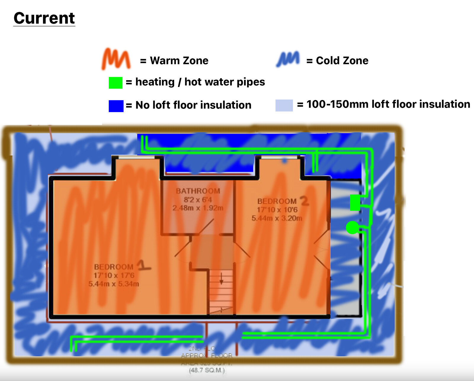

Only alternative I guess is back to Warm loft everywhere, but im a little unclear on exactly what has to happen here logistically to convert this. That white membrane has to change right?
Doesn't need to be everywhere but it would likely be easier to warm roof the bit the other side of the boiler room. I don't really see the plywood wall as a wall; more like "a large board to screw things to in a cold loft area". By making it a part of the warm envelope you take away a whole load of fiddly work moving or insulating pipes. Remember too that pipe insulation is 19mm (not very large in the grand scheme of things;my air source heat pump has 75mm insulation on its feed pipes); your loft wool (roughly same thermal performance) is supposed to be 300mm; that'll outperform the 19mm pipe lagging by a huge margin. Lag by all means but cover the pipes in wool too. Avoid insulating power cables unless you've calculated that they can still carry the power they currently do after insulating (look up cable derating)
Insulating the ply wall will involve insulating the sloping roof above the boiler. if using board for it ensure it's a good fit between rafters and board/tape over them too to create a vapour barrier. You're essentially performing a loft conversion of the boiler room and installing the insulation the builders should have done
If the white membrane is non breathable, leave a gap between it and whatever you insulate between the rafters with. Eg if your rafters are 200mm, put 150 insulation between, flush with the ceiling.
Ahh, right, im with you now @robinbanks . I thought you meant making the whole of the cold loft space into a warm space. You mean just the portion on the other side of the plywood where the pipes are.

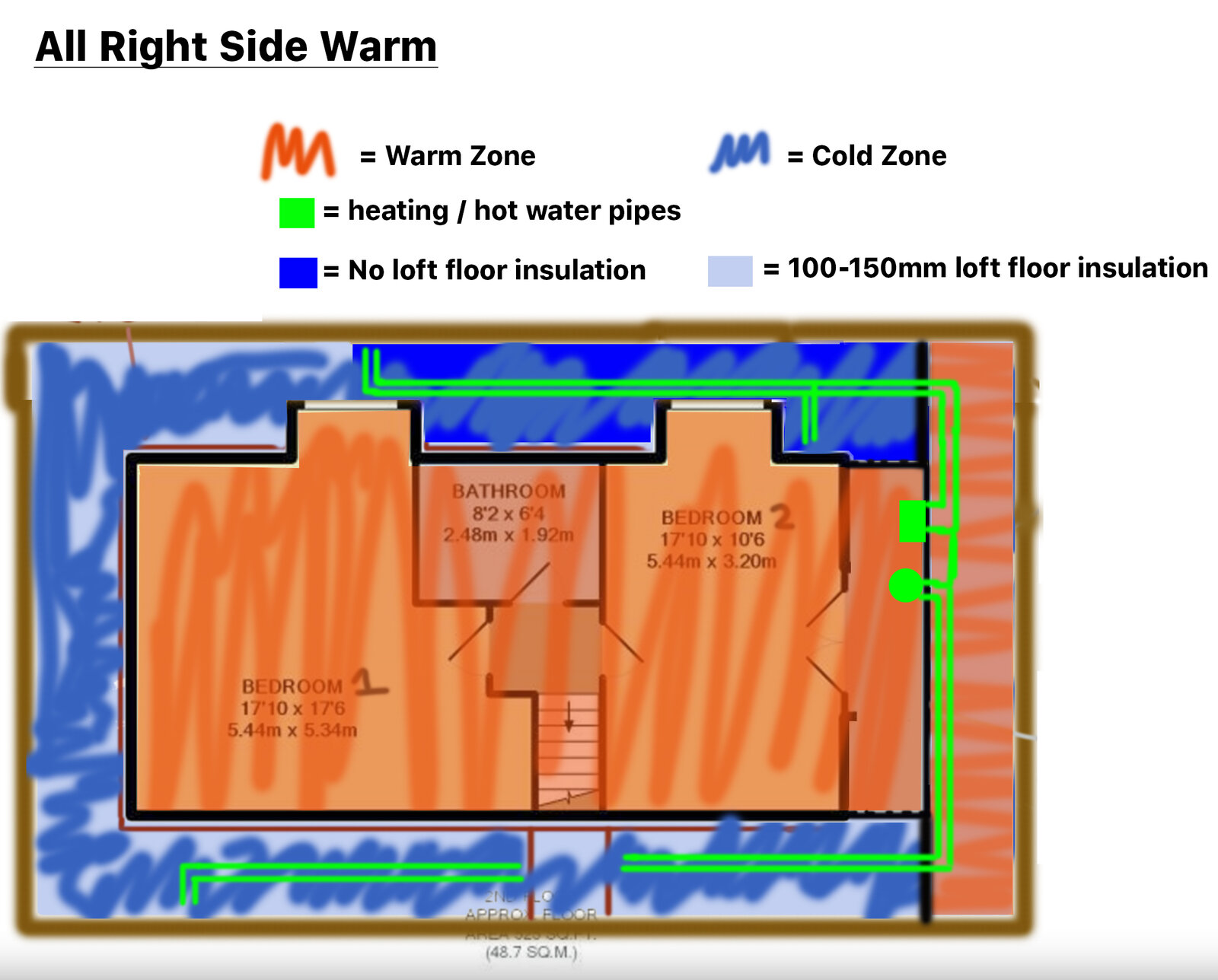

I've put some photoshopped images below now of the current setup, a version where just the boiler room would be warm and a version that I think is what you're proposing... The images also include the the location of the hot water / central heating pipes up there. Unfortunately they do span pretty round most of the loft space. See the 3 images below.
If i am understand you correctly, you're proposing the last of the 3 images, where I was originally planning to do closer to image 2.
So if I went with your proposal on image 3 and made everything on the right side of the boiler room into a warm space. If Im putting 100mm kingspan in the rafters and assume im blocking the vented soffits etc... What keeps the timber dry and where would the ventilation come from? ...Is this why the white membrane between the rafters would need to change?
Also based on how far the heating / hot water pipes span it'd only fix a portion of it anyway I guess. Lots of the pipes would still be in cold areas.
im not advocating leaving that untreated. Those areas need filling up with insulation that covers the pipes and the dwarf walls. If you can't get access by crawling consider laying wool out by rolling it and pushing it with a stick (drain rods where you can make the stick progressively longer if space is limited) or by having a sledge made of plastic membrane onto which rolled out insulation is placed, then the head end of the sheet is pushed (by stick again) so that the sheet slides along the floor taking the insulation with it. It's going to be a compromise compared to taking walls or roof out to gain access, but it gains a reduced amount of work in making good

On the topic about insulating the roof. The rafters in our roof are 200mm, if I went with 150mm of kingspan flush with the bottom of the rafters leaving the 50mm between the white membrane and kingspan, I assume i'd run the kingspan as far down to the eaves as possible, atleast so they're snug with the wool on the loft floor so all the air from the vented soffits there could only get up the air gap behind them, between kingspan and membrane.... OR would it be best to put wool in the soffits too essentially blocking the vents?
That said, even if I did do one of the above for 1/4 of the house / insulating an entire run of rafters all facing the same direction, im assuming it'd do very little to help the thermal performance of the house? As the vented soffits perpendicular to the then insulated/boarded rafters would still be letting lots of cold air in still bypassing the insulated rafters entirely? tried to display that on the image below (i've used the other side of the loft for this image as it's less busy, incase you're wondering where the pipe work has all gone)
So I guess i'd have to completely block off the portion of loft that had has the insulated rafters, to stop the vented soffits blowing through to this section entirely, Like an insulated stud wall either side, something like the image below?
Then if I understand you correctly, with all the air from the soffit vents not able to reach these insulated/boarded rafters, they'd still be OK moisture wise due to the airgap between the kingspan and membrane? the air from the world side of the roof tiles would be enough to keep them dry?

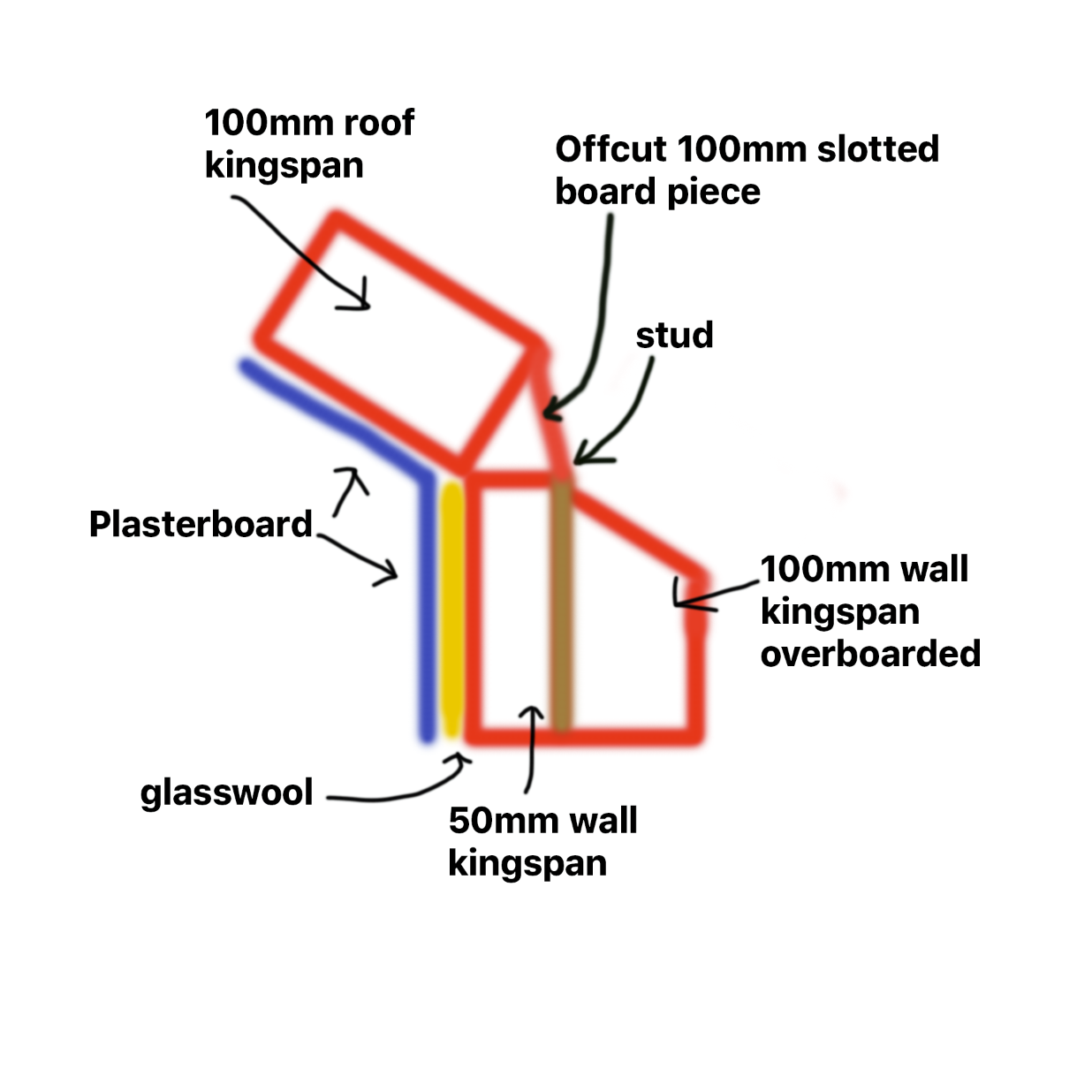

Took a look at video 3- re the first half of the video: I would pull those boards out from between the studs, I'd cut a chamfer on the top of them that mates as closely as possible with the angle the ceiling boards are at (if the ceiling boards are at 30 degrees I would cut a 60'degree angle on the stud board), wipe the end of the ceiling board with a damp cloth, apply some good lines of expanding foam on the ceiling board, wipe the recently cut end of the stud board, and refit the stud board. Push it carefully into place so it doesn't flatten the expanding foam any more than it has to; if you push it too far and have to pull it back the foam might not expand to fill the gap any more. The stud boards will this be mounted higher and will have a gap at the bottom; you can fill that with wool
For travesties like that socket powering the router I'd pull it off the wall and move it so it wasn't in the way of the board then fill in the hole it left, use a longer bit of cable if necessary and have the cable come out at the side of a stud so the insulation can pass by its side. Bashing a massive hole for it really just goes to show how rough arse those builders were
If only doing part of the roof you then have to completely create a room, so install walls that join up with the insulated part of the roof and enclose the boiler room, joining eg an insulated dwarf wall to the insulated roof slope with a triangle of insulated wall
They're dry already so it won't take much to keep them that way; they're barriered from the house generated moisture by the overboarding of the rafters (and if you have no space for insulation overboarding you can install a membrane)

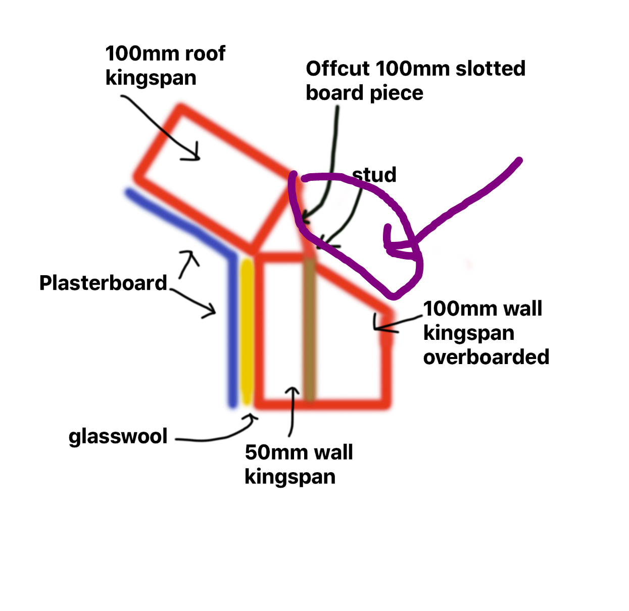

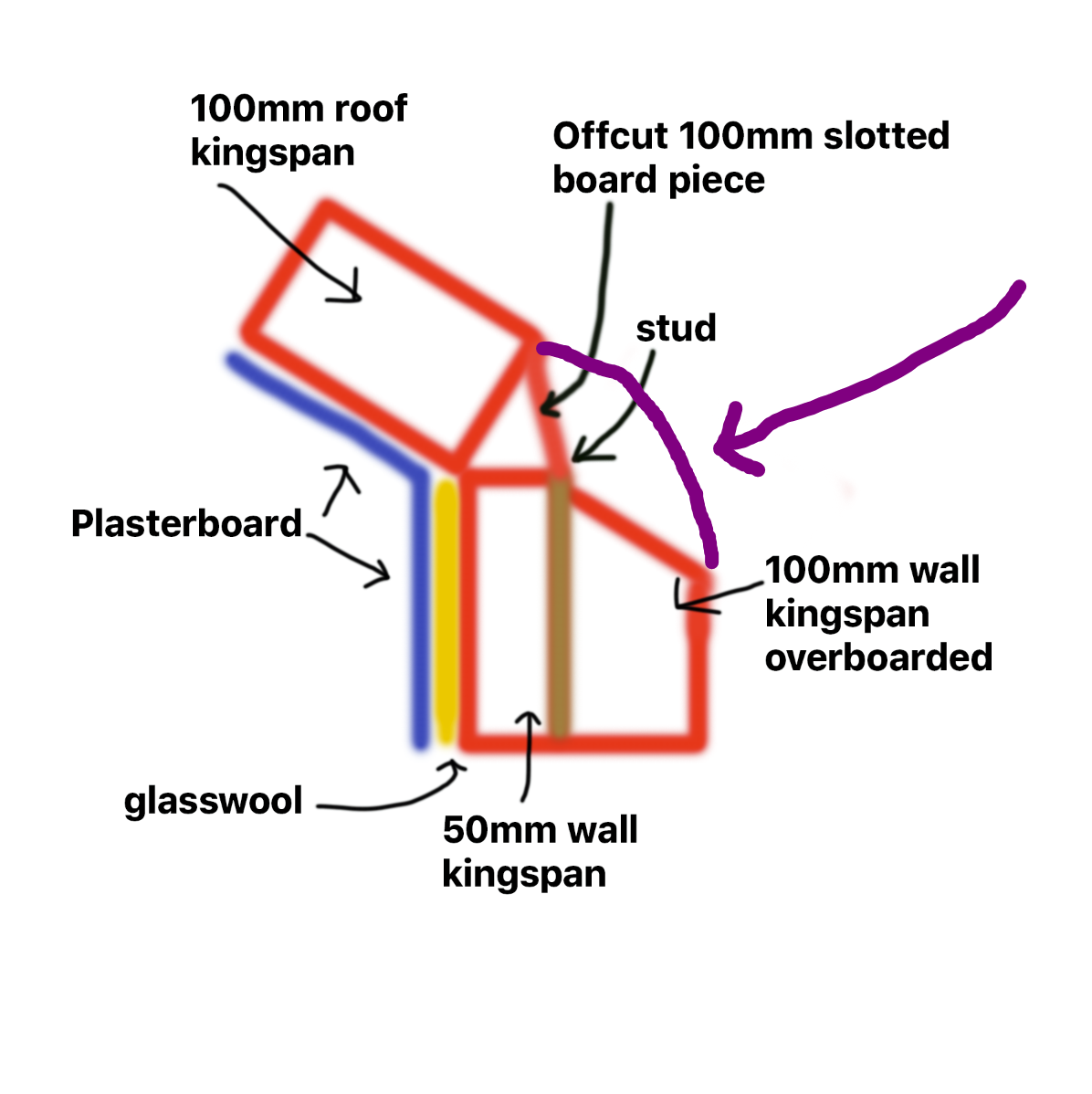

Ah Yes i've already started this in earnest, though I didn't chamfer the edges at the top of the 50mm wall boards already in the studs as I've bought a load of 100mm board that will be going over the top (appreciate this may be overkill, better than underkill i guess!)....the plan was to chamfer the 100mm boards to the angle of roof allowing me to get them as high as possible too / flush with the roof rafters, in turn covering all of the 50mm wall boards. I've drawn a crude cross section below to show what i mean.
The 60degree angle that remains where the roof and wall boards meet i've put some wool in there for now, but my plan was to use off-cuts from the 100mm overboard pieces to slot and foam into that gap like below.
Though even as i draw it, I can see really for it to be consistently thick, I should have something insulative in this space here between the roof rafters... I guess i could just put some wool there.
