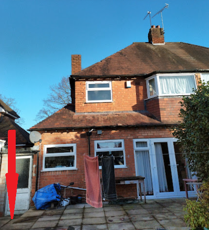

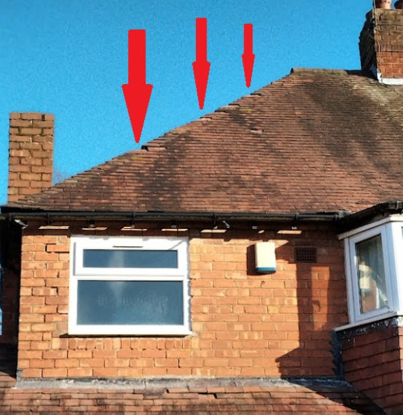

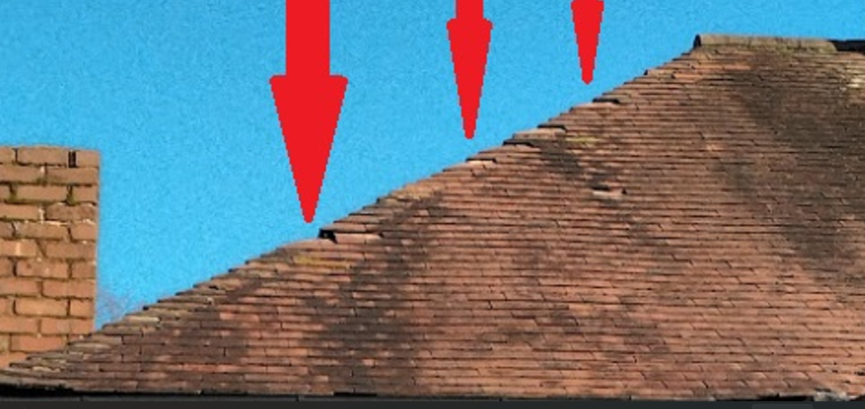

There are upper roof hip tiles missing:

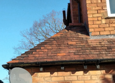

Looks like some misaligned hip tiles on the lower roof:

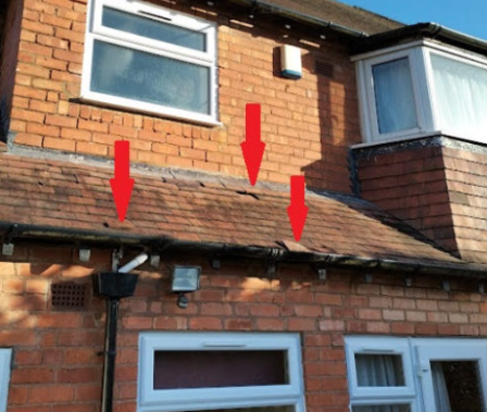

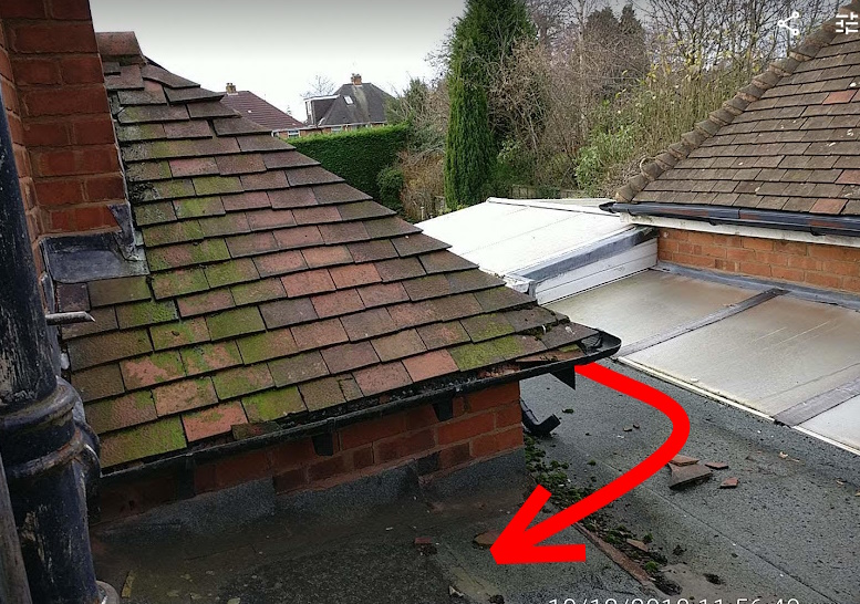

Some lower roof flat tiles need replacing or resetting:
Can I get Hip Arris tiles and get the missing ones replaced? Is it a hassle replacing a few of the hip tiles because they are interlinked? Are they bedded in or just nailed in?
Does the angle of the Hip Arris tiles have to match the pitch of the roof is this why the lower roof hip tiles look loose?
Or is the only solution to get them replaced with a new dry hip ridge kit? (although I am sure this project will bring its own problems as well)

they are all nailed and bedded . if some come out then expect the others to follow in the future.
id have them all lifted re drilled and re fitted from bottom to top.
for replacement hips you'll need roof pitch, looks about 35 degrees but that's a guess
the lower damaged tiles are probably end result of hips falling

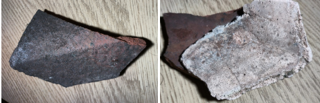

-Tiles broke when fell - got this little bit - assume its not enough to gauge pitch angle?

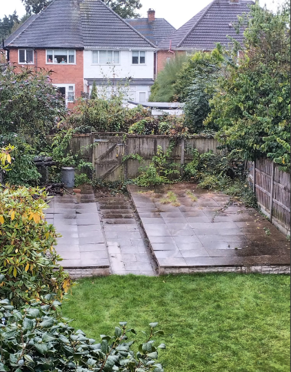

Is there space to get a cherry picker in?
Yes, there is a rear access road into the garden with a 1m approx gate width. I assume something like this could get in?
Also there is side elevation flat roof. which may be able to be used.

No, that's no use at all, it only goes vertical, and would be a long way out. Cherry picker - this sort of thing https://www.niftylift.com/uk/product-types/cherry-picker
Reach up, and out.

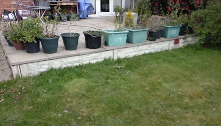

Part of the patio is raised. So assume the cherry picker would need a ramp or something to get up that step, no idea if it can get up a ramp easily or how heavy it is to be pushed up?
I guess the narrow ground level bit is too far away to get to the upper roof hip?

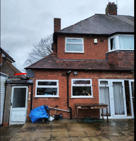

I get the general process and understand a roofer would work from the broken hip tile upwards? So about 30 odd tiles to the top from the big arrow and about 10 tiles need replacing. The ones that aren't broken would come out okay if you have to work upwards? I assume they aren't all nailed in? So the job would be to nail and spot-bed the broken ones and then get the others back in.
Are you sure there isn't some nifty trick to just replace the broken hip tiles or just spotbed them in? Just as a fix to get through the winter?
