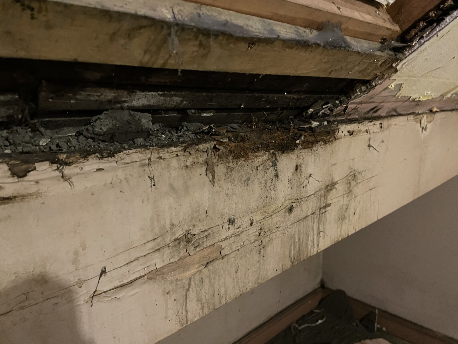

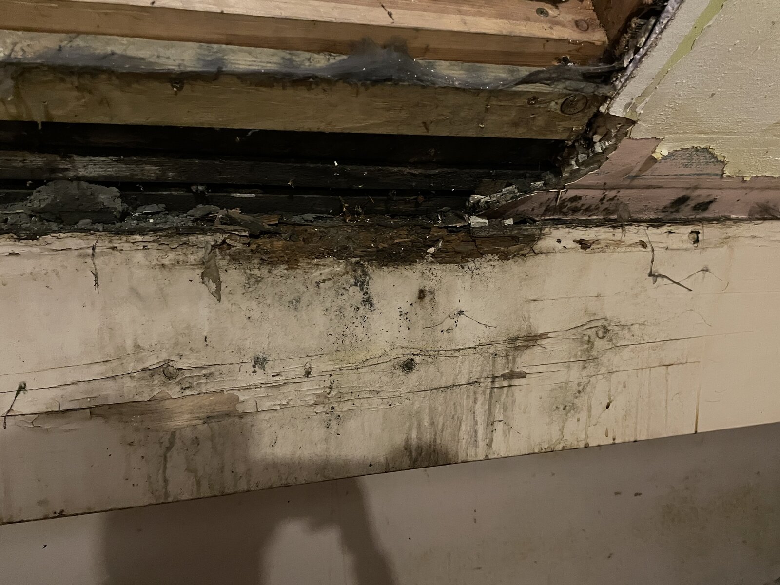

Rotten purlin under velux window
12 May 2011
32
Yorkshire
I am in the process of stripping back the attic rooms in my 1910 Edwardian terrace house which has been over boarded badly with no insulation.
Upon removing the boards I have discovered the middle section of the purlin under the velux window has rotten (presumably from a leak). It is the top tenth of this section of purlin that has rotted under the window - the rest of the length appears ok.
What is the best way to go about fixing this? There is no sagging in the roof or anything at present.
91365117-6086-4A21-AB0B-3266836434C6.jpegB22FE512-21F5-4935-A995-BAC00AF31D2F.jpeg210EA998-1DD5-49E4-BA93-1CF0CF3C4506.jpeg
how long is the purlin ?
I am no expert but i does not look all rotten from the photos . Perhaps strip the paint and have a better look.
