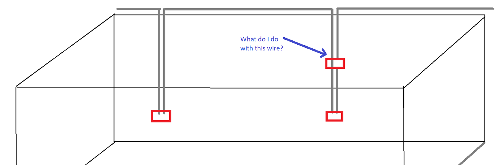

I'm moving some sockets and incorporating them in the ring. Currently I have four double sockets on a spur which I know is wrong.
This is a ground floor room. The ring runs in the ceiling and will drop to each socket. In one place I want two sockets, one above the other. One double socket above desk height for desk lamp and temporary equipment, the other double socket below desk for IT equipment.
As both sockets will be on the ring, one cable will need to run through the upper socket into the lower one. What do you do here? Do you run the T&E:
I'll be chasing into hard red brick so the shallower the chase the better It's a half-brick internal wall, tiled on other other side, so cracking a brick will be a pain to fix. I'm using standard depth sockets not fancy flat plate ones so 25mm boxes are fine.
I can't take the wire horizontally between the two sockets because there's an alcove (not shown).
Highly artistic picture attached!
