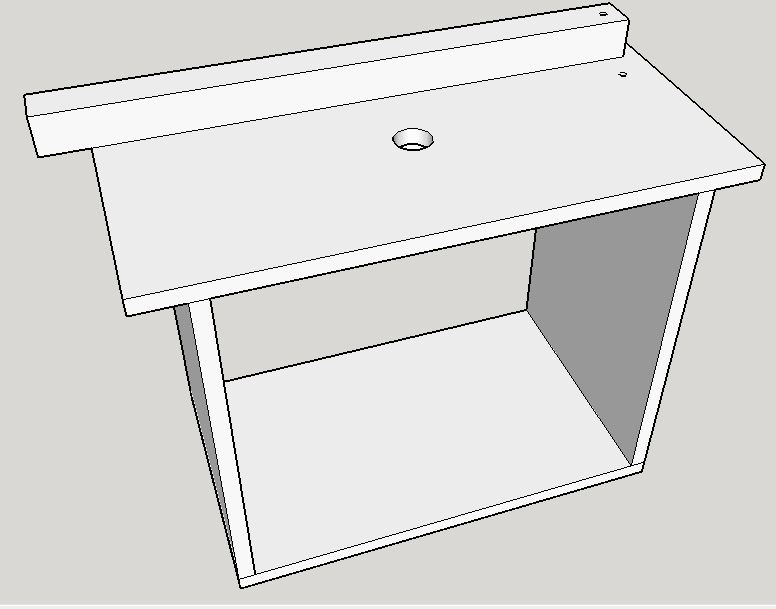

A plunge router can do that sort of work for you with the appropriate router cutters. For example the bevel cuts you are talking about can be done using cutters such as these from Wealden Tool. A tilt abor table saw can also be used to do that sort of work. With the router it is far easier and safer to do that sort of work with the router held (inverted) in a router table. A router table can be home-made for under £20 and is little more than a four sided box with some bracing (screwed together from MDF or Contiplas), with a hole in the top (for the router cutter), another 8mm hole over near one edge to take an 8mm coach bolt, washe and wingnut and a piece of 3 x 2 planed softwood (drilled for the 8mm coach bolt) and a G-clamp for a fence:
They take under an hour to make if you get your materials cut to size.To use the router table it is clamped onto the top of a bench or table with two G-clamps

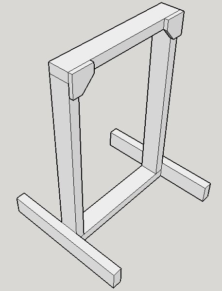

I'm in full agreement on the point made about Workmates as benches - they are far too small and unstable for use as a bench in most cases. For the use you envisage why not knock yourself up a couple of quick and dirty trestles from 3 x 2 or 4 x 2 CLS with sheet material (plywood, chipboard, Contiplas, etc) corner braces - anything from 10mm to 22mm thickness will do:
A basic bench can be made using these with either an old flush door screwed to the top or with three 3 x 2 CLS pieces screed to the top bridging the trestles and onto which a piece of chipboard, plywood, MDF or Contiplas can be screwed to form a workbench. This type of trestle bench can be made up to 8ft long for little cost and with a fairly minimal tool kit and will break-down for storage quite easily

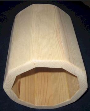

Sorry just thinking out loud now if I were to make an octagonal tunnel could I then dado the lengths to fit them all together without the need for glue or would it just fall apart given weight within the tunnel? (I am thinking something similar to this: http://www.oocities.org/forchinatechins/images/WoodTunnel2.jpg)

....if I were to make an octagonal tunnel could I then dado the lengths to fit them all together without the need for glue or would it just fall apart given weight within the tunnel?
That's what is often referred to as a "coopered joint" and there are no "dados" (housings) involved at all. All the joints are "shot" or planed flat and true and the structure is held together with glue (although they might be strengthened wiuth loose slips let into the edges). To produce such joints you'd normally require a table saw, a jointer (or overhand planer - a jointing plane could be used instead on smaller pieces) and a fair degree of skill. Granted it isn't curved like a coopered barrel, but if you get the chance take a look at a video of a cooper at work and you'll get some idea of the amount of accuracy involved.
