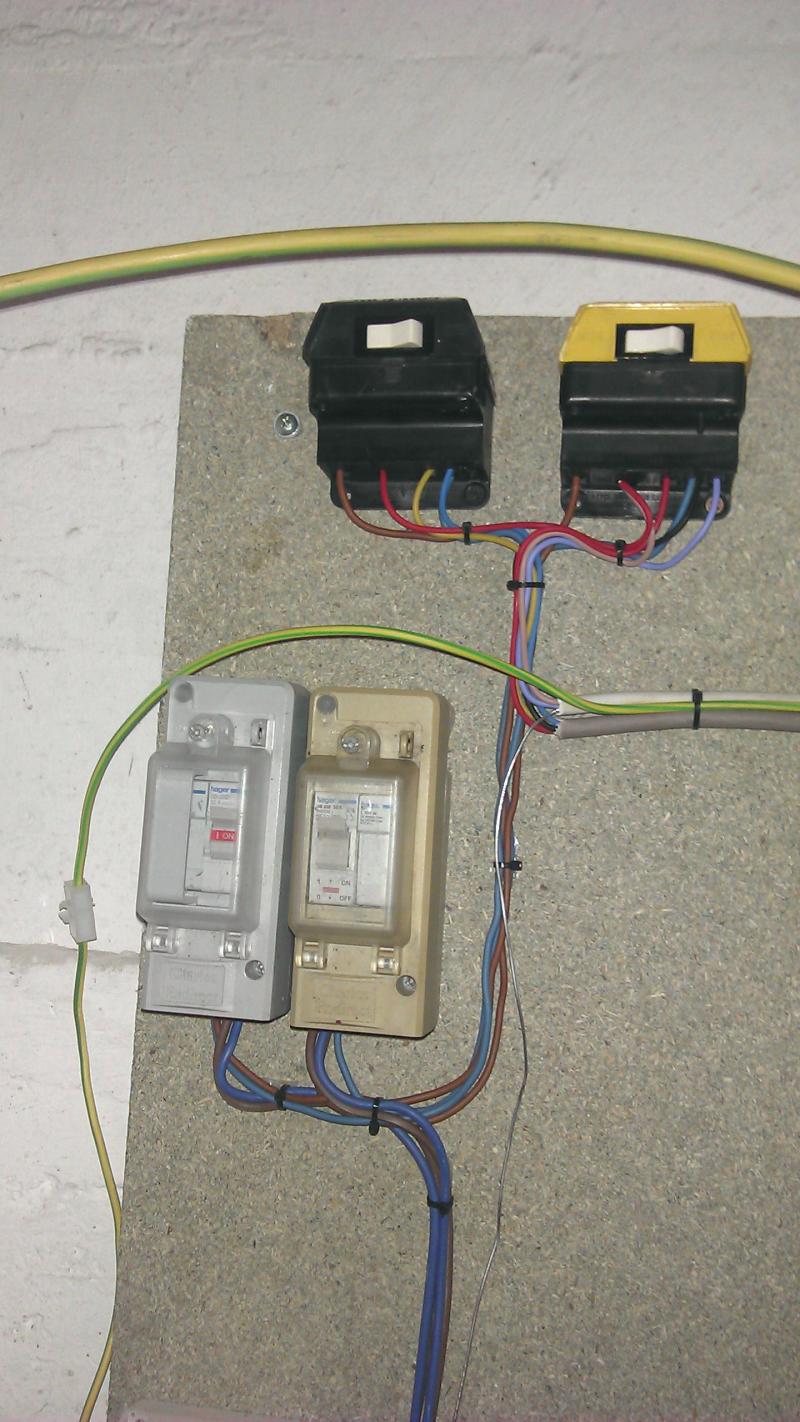

Here are the pics of the set up- Please note this is still in design stage.

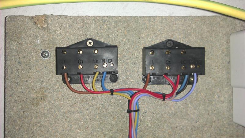

This is the wiring layout-
In the Live part of the base is a cable running from each fuse unit.
In C1 on the right is a Red and Brown wire . Brown is from the cell and Red links it.
In LO on the left does the Car park light and right is for the Up lighters.
In the N side is all the Neutrals.
In C2 is the Neutral from the cell.
Jake
Ah think i see where you have gone wrong you can share 1 cell eye between the two relays each requires its own cell.
Might be better to use just one P42 unit to switch a suitably rated contactor for the lighting load.
Also the relays and bases should be installed in a suitable enclosure.
Where did you get the charles en direct gear from ? them isolator units are normally fitted with double insulated tails and installed over the DNO cutout in a lamp column base.

Oh i was told by one of the maintenance guys like your self that you could do that. I will get a 2nd eye and put that up.
The enclosure is in the post.
I brought about 20 of them to fit up some columns when we get the money to buy some SWA.
Whys it Shoddy? The earth is a temp till i find a earthing block.
