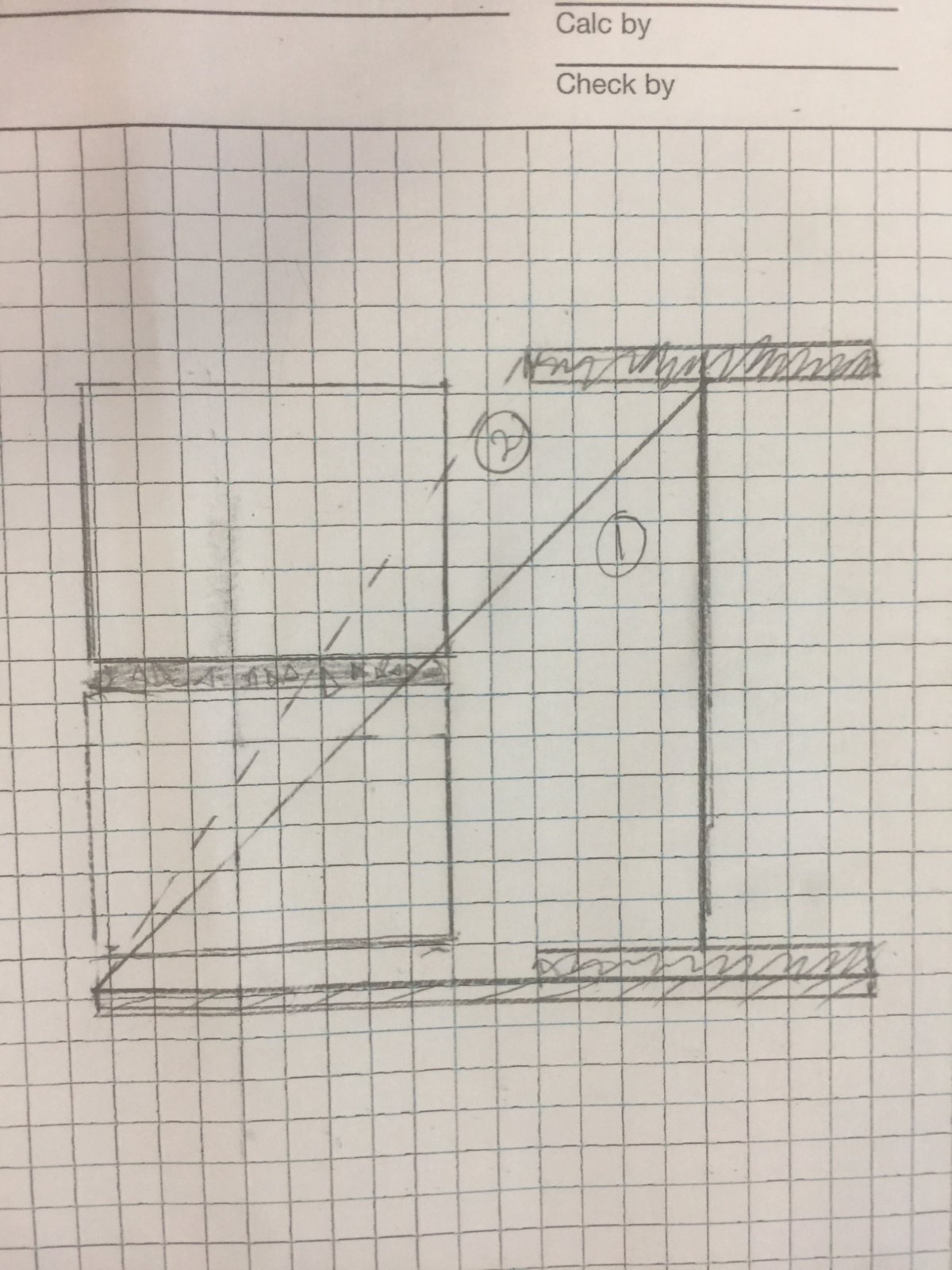

As the beam will be asymmetrically loaded with respect to the shear centre, there will obviously be a bending moment and therefore torsion induced in the I-beam, which needs to be allowed for on longer spans.
But those stiffeners would do little if anything to reduce the torsion-effect. Theoretically they will reduce deflection of the plate in the xx axis, but for a 6mm plate, 100mm welds every 300mm would be adequate.

An update guys:
I have taken one of the RSJs back to weld an underplate to it and the steels guy said stiffeners will stick out on my wall so I can’t use that. I contacted the BCO prior to confirm they are happy with the underplate, the BCO said okay, but either 6mm plate with stiffeners or 10mm without, so I had to go for the 10mm without stiffeners.
Question: why would the stiffener stick out?
Builder doesn’t agree, with 10mm plate, says it will increase brick joints massively and not practical, even the 6mm. So I’m going for RSJ for inner leaf and IG C lintel for outer leaf, gauge is 3.2mm and 225mm high. Both not bolted.
Lol, it's almost like someone else has had this problem and developed an off the shelf product to solve it.
Thanks guys. You can tell I had fun being bounced around by the BCO, builder and the steel fabricator.
