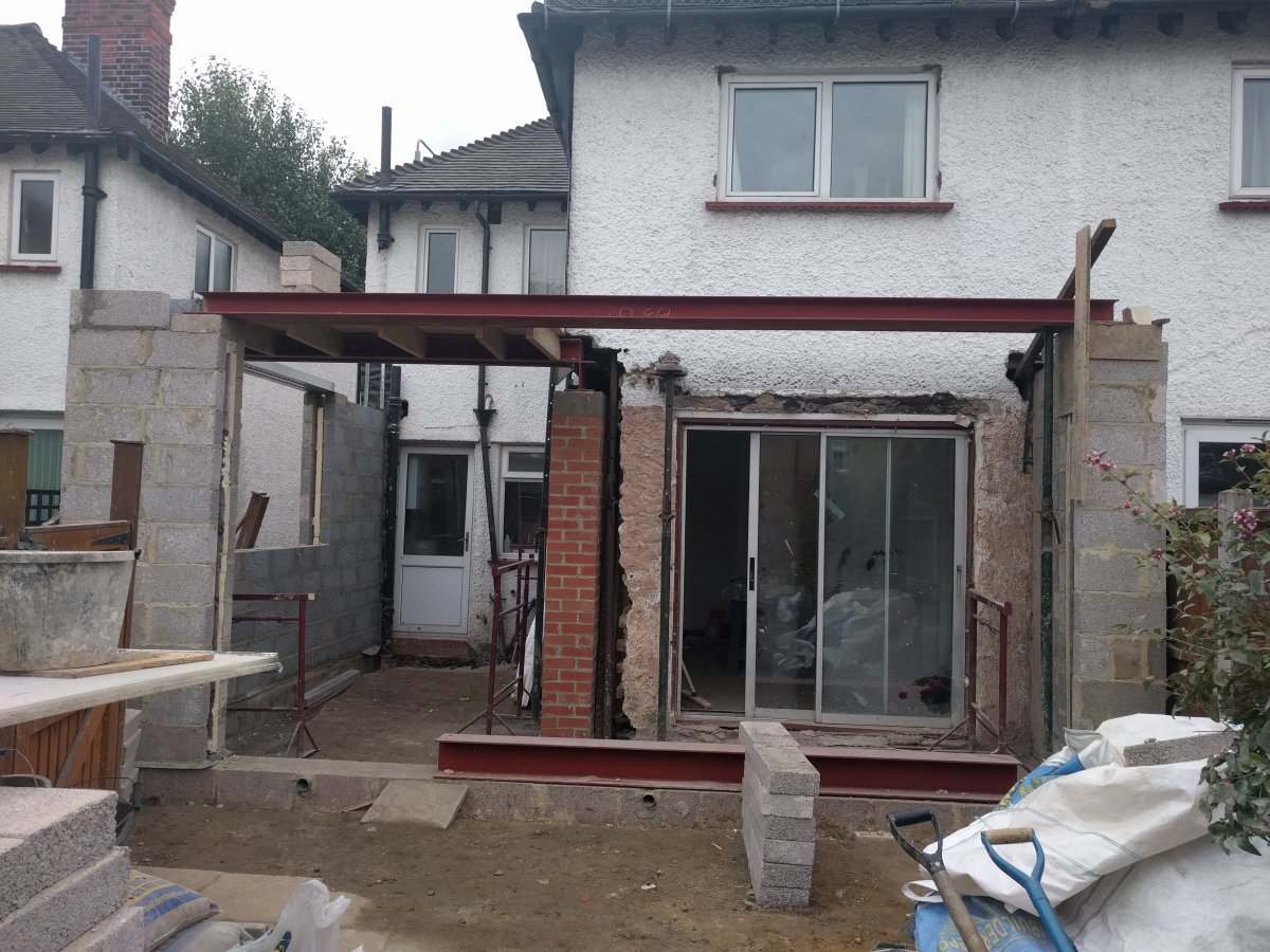

Sorry for drip feeding, just for the avoidance of doubt, this is how built it is right now. The windows haven't yet been ordered. Click to zoom in.

Gotta say, there ain't a huge amount of difference between what your architect has specced and the Velfac detail.. window position looks to be about it!

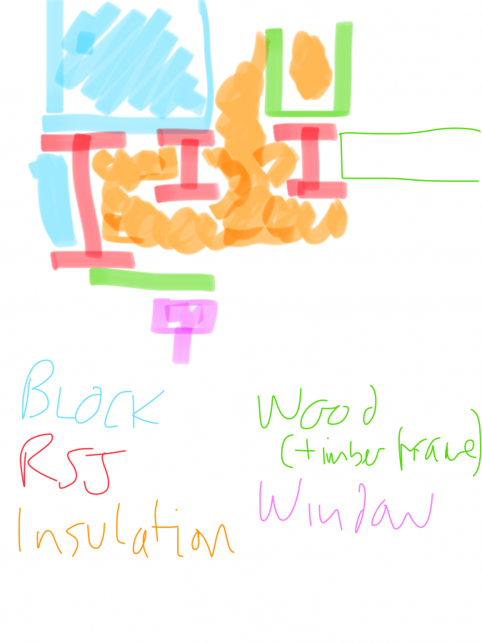

I had two lintels (three actually but the outer pair were bolted together) which made some things easier, especially as they were at different heights
IMG_0033.PNG .
I think your biggest niggle is a single lintel spanning the cavity.. maybe lift your lintel more and have the window fixings on a steeper angle. They're only lateral restraint. You can pack and joist hanger the ceiling joists if you need.. by increasing the height of the lintel you increase the amount of insulation you can squeeze in, so you can move away from these fancy techs and to somehing that will withstand a bit of punishment.
Of course you can also shorten your window to suit too.. depends on how tall you want them vs the ballache of reconfiguring the lintel
Thanks cjard, that's really useful info about cranking the fixings, I'll talk to the window fitter about that. There's not really any leeway to get the window height we want, however we can ask them to lift the steel a little and redo the pad stones.
So in your case you have one of the steel(s) on the cold side and the other on the warm side.
In my case I'd be trying to get the whole steel mostly on the warm side, right?
That would handle the interstitial condensation question better I think.
pretty much, though the outer pair of steels are cold side and the inner single in the timber frame bit is warm side. The window connects to 18mm ply that is hilti gunned onto the outer steel. Technically the ply is hence the coldest bit.. it shouldn't lose heat to the cavity, but it will lose it to the world. I'm not too bothered about this because a foot wide strip of ply with the narrow edge facing the room is going to transmit less heat than an alu window frame, even if the frame is thermally broken
