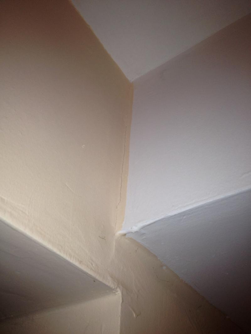

Just out of interest what would be the best way of getting the works signed off? Break plaster, take pics and send to SE, SE approves and then send to building control?
Anyone? Really stuck. If I get an engineer out to confirm all is okay. Do I still need to notify building control? Just more of an added expense but need peace of mind. Also can I delay a SE report until I have the money for a retro app from building control? Is there a time limit to get the calculations over to the council? :(
For a retrospective approval you will need to expose each end of the beam, give your SE some photos and the size of the beam and the bearings and what they are bearing on (eg padstone or the brick wall), if he is a sensible SE and you can give him all the info he will not need to do a site visit. Then get the SE to do some number crunching and if the beam is OK then you can get BC out to inspect each end and then you can give him the SE's calcs. Then once BC have checked your SE's calcs he will sign it off. But prolly best not to involve BC just yet as if the SE cannot prove the beam you may have to think again.

Pics of the opening when finished are of no use and we know what you mean by the two beams. Its all about the sizes and bearings etc.
Realistically if something was gonna go wrong it would have by now, if you have no cracking or anything else visible then its more than likely all fine, in practice at least. But if you are really worried and want that certificate then you'll have to have a dig and see what's what. No point patching up until its all been signed off.

Does to me as well. He can't remember. It looks like the same size rsj as the one in the google pic I posted so going to put some money aside for an engineer to put my mind at rest as it's driving me round the bend.
I shouldn't worry about it. Though if it does go it will go quick and you won't know anything about it! :evil: :LOL: :LOL: :LOL:
Well, maybe enough time to just look up at the cracking!
