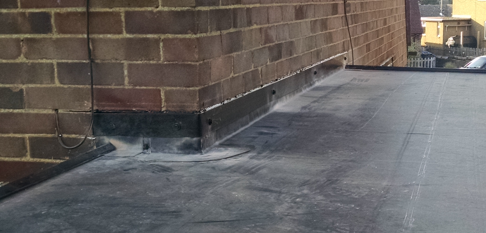

Here mine from the top.

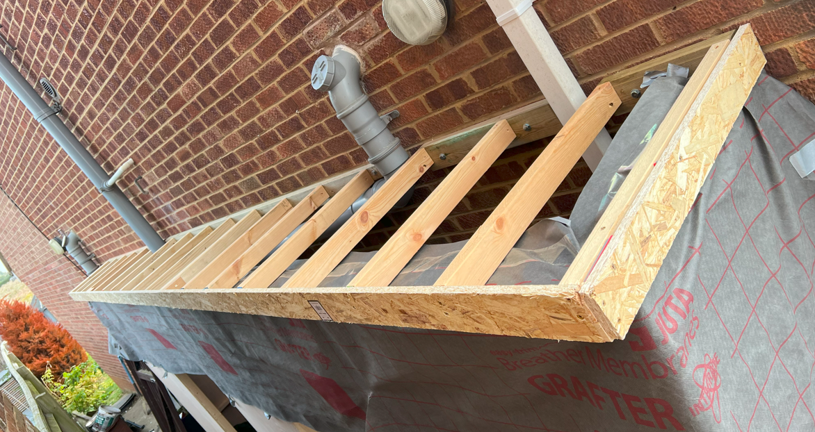

My roof will have a slight fall away from the wall. This will create a tiny gap where the 18mm OSB meets the wall as it has a straight edge. Previously I thought I would slide the plywood upstand into this but I agree, its worth leaving that out. Will this gap be an issue at all?
You could cut the OSB on a slide angle so it meets the wall, or just caulk the gap or just leave the gap, it will not be an issue. My roof also got a fall but I don't remember what i did :)

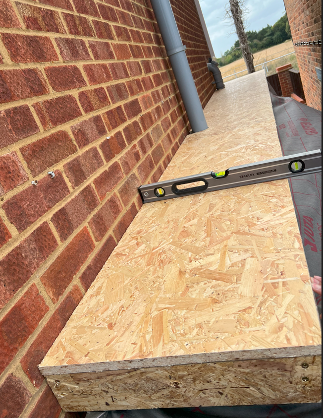

I dry fitted the deck yesterday and have now ordered the rubber layer.
When cutting or screwing OSB boards, there is some wood chips that spread and become prickly. Is the rubber resilient enough to cope with this or should I be sending it down? Perhaps sanding makes this surface worse?
Looking good, I would sand them if they stand up, alternatively you could use a countersink before you put the screws in.
