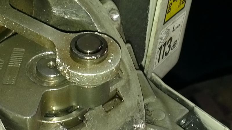

Having fetched (almost) everything apart before, I had determined that the blades were not jammed, and neither was the gearbox. However, I could not get to the bowels of the recoil mechanism.

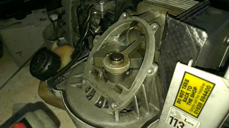

Yesterday, I took a couple of plastic bits off, and got to the crankcase cover, which I duly removed. Et voila!

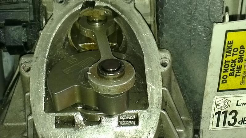

Bits of metal scattered inside - it appears that the bearings at the pivot of the piston arm (non-barrel end, the bit attached to the counterweight) had given up the ghost, causing the arm to spin off-centre, and gouge itself on the side of the housing. Causing the jam.
I freed it easily enough, but even rotating the counterweight by hand caused the pivot end to "ride" up the shaft, jamming again after a revolution or two.
As I cannot get the remains of the bearing housing to budge, nor the counterweight from the crankshaft (despite removing the circlip), it is definitely a mender's job.

From what you describe Mr.B it would seem that the big end bearing has given up and what you see are bits of the needle rollers that form the thing. :eek:
A picture would be great, but if its what you say its really the end of the line for this machine, economically.
I can't think why the bearing has failed - if its a lubrication issue the piston and barrel are always first to suffer.

OK, gasket, bearings, retaining ring, and piston ordered - £30 inc vat and p&p.
I just can't get the big end :eek: to slide far enough upwards to free it from the counterweight - therefore, I can't replace the bearings, or piston, as it currently stands.
Counterweight is well-wedged onto the crankshaft - even after having removed the circlip, it won't budge.
A thought I don't want to countenance is (if I could free the counterweight from the crankshaft) would be to drop the crankshaft out from below (no doubt involving more disassembly!), then sliding the counterweight out, and dropping it off the big end that way. But that is even more taking apart, and I can't budge the counterweight.
Any ideas John? The stymie of a couple of well-stuck parts appears to be all that separates me from a sense of smugness!
Errr strewth :eek:
I'm afraid the crankshaft assembly must come out of the other side (flywheel side) complete with its main bearing......this should allow the piston / connecting rod assembly to slide off the crank pin and allow the piston to withdraw from the barrel.
Thats all I can think of....I don't think its likely that the crankshaft assembly would be pressed into place in situ - it would be very hard to balance it if it was.
I know the counterweight is separate from the crankshaft itself and the two pieces are coupled together with a 'retaining ring'.
Truthfully, I havent had one of these particular engines so far down before, so you are ahead of me with this one!
