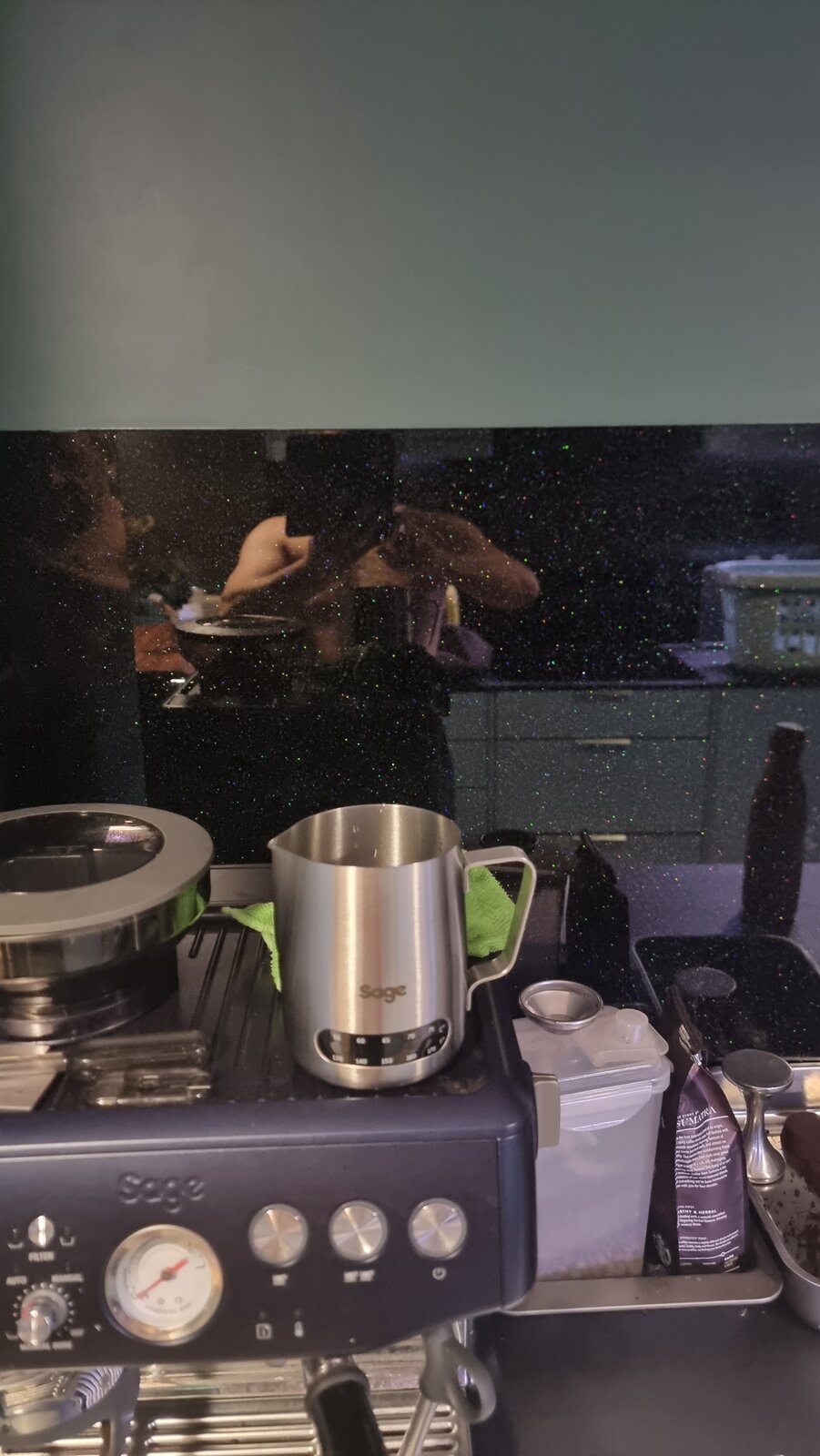

Coffee's g00d this morning.
A dash of hazelnut n' cinnamon gives it a twist o' taste.
Wanna know how you can make yours better, not bitter?
"Yeah. Science!"
I did this with my old grinder but maybe too much water. I'll have to see where I can get one of those sprayers
