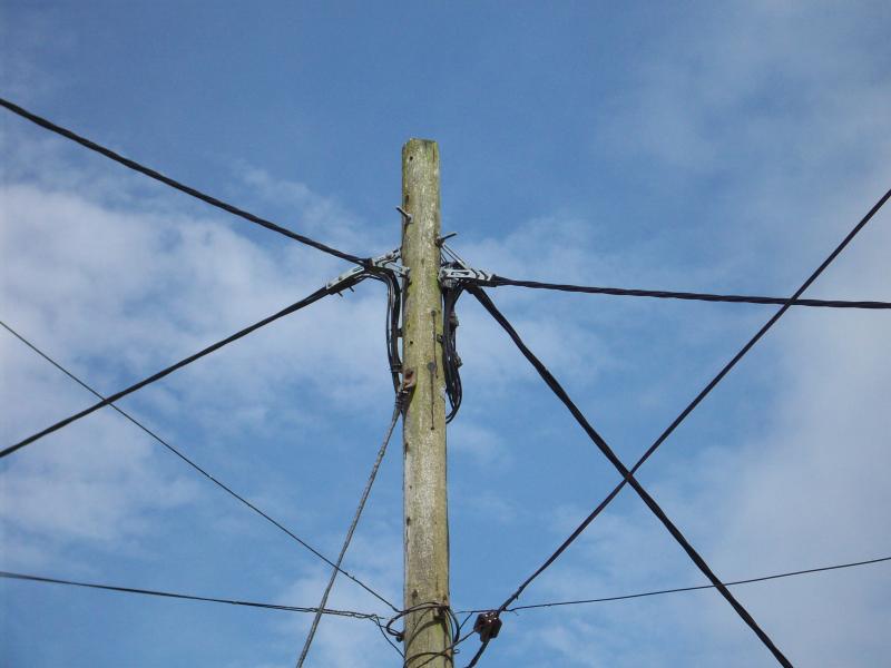

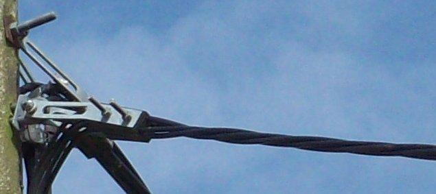

I'm at a disadvantage here, because I'm not familiar with the various cables or what they are called. The cable which travels from the pole to the building here looks like four twisted black-insulated singles and it's been there for an awful lot longer than 5-6 years. I'll try to take a photo tomorrow.
Here a couple of photos. The near-horizontal (on photo) cable heading off to the right is my supply. Is this 'ABC' cable?

Concentric cables can be used but only over short didtances, or as just explained to me "it's finding a fixing on the property strong enough to hold it in the air"!
We can run it as mural wiring but it has a large bending radius as we use solid aluminium conductors.
ABC is actually good to run to a property but we wouldn't use it as murals owing to the single insulation and bending ssues, again, caused by solid aluminium.
To be honest we still use copper single core cables for 3 phase as they are far more flexible. Single phase tends to be single core concentrics.
he looked at me a bit strangely when I asked if they used straight con for this sort of thing, saying that 3-core concentric would be 'rather a fat cable'.
And the OD of ABC with a sleeve over it is......?
Concentric cables .... We can run it as mural wiring but it has a large bending radius as we use solid aluminium conductors.
Intresting. The cable run of my supply along my (neighbour's) wall (some 15-20m in total length) involves going around an external corner of the property - so presumably would represent a bending radius problem for either concentric or ABC. It therefore sounds that it's most likley that they would replace the present four PVC singles with four PVC singles! - but, given that the present cable seems to be in reasonable condition, begs the question 'why?' (as I said the DNO 'fault man' who did the 'temporary clipping' yesterday seemed most concerned about the aesthetics).
