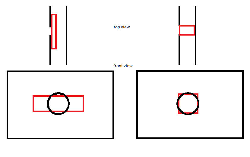

Okay so a few weeks on and the bracket is loose again. Unsurprising I guess. Plastic is just too weak for this kind of weight. Especially as the towel can be wet after use.
I originally thought about a long thin strip of wood, inserted into the hole and glued horizontally to the plasterboard. But I wonder if it's better to use a larger chunk of wood but glue to the second plasterboard and flush/just slightly recessed with the front plasterboard. Would this be a stupid idea?

With mine, I fixed a disc of varnished hardwood to the wall with hollow wall anchors, and then fixed the towel rail to that.....the hardwood is on display but at least the rail is solid enough.
Yes that's as I suggested.
Right, I finally got round to tackling this. I've stuck in a piece of wood 15x25x76mm. Glued it in with gorilla glue. Should I use anything to seal in around the gaps?
I realised after I'd done this that I could have squared the hole using a hacksaw blade from a hacksaw I bought recently. :confused:
So the gorilla glue had dried and the wood appeared fixed in place. Drilled some pilot holes and screwed in the bracket. Very slightly wonky but once the rail was put back on, not obvious. It does feel very strong now.
Thanks to @foxhole @Chud and everyone else for the advice.
