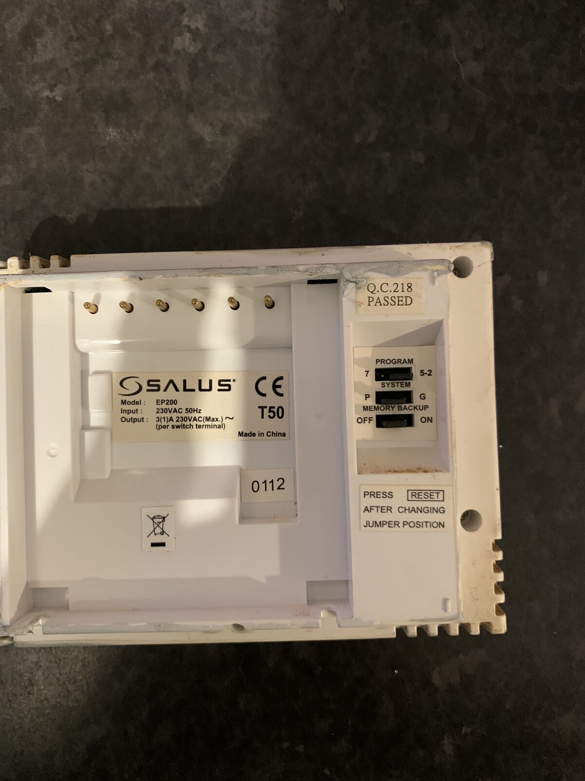

The power to the thermostat, is usually fed from the programmer.
If the programmer has failed, the receiver would stay off.
If you feel confident enough can you show us the wiring behind the EP200, and we may be able to rule that out as the cause.

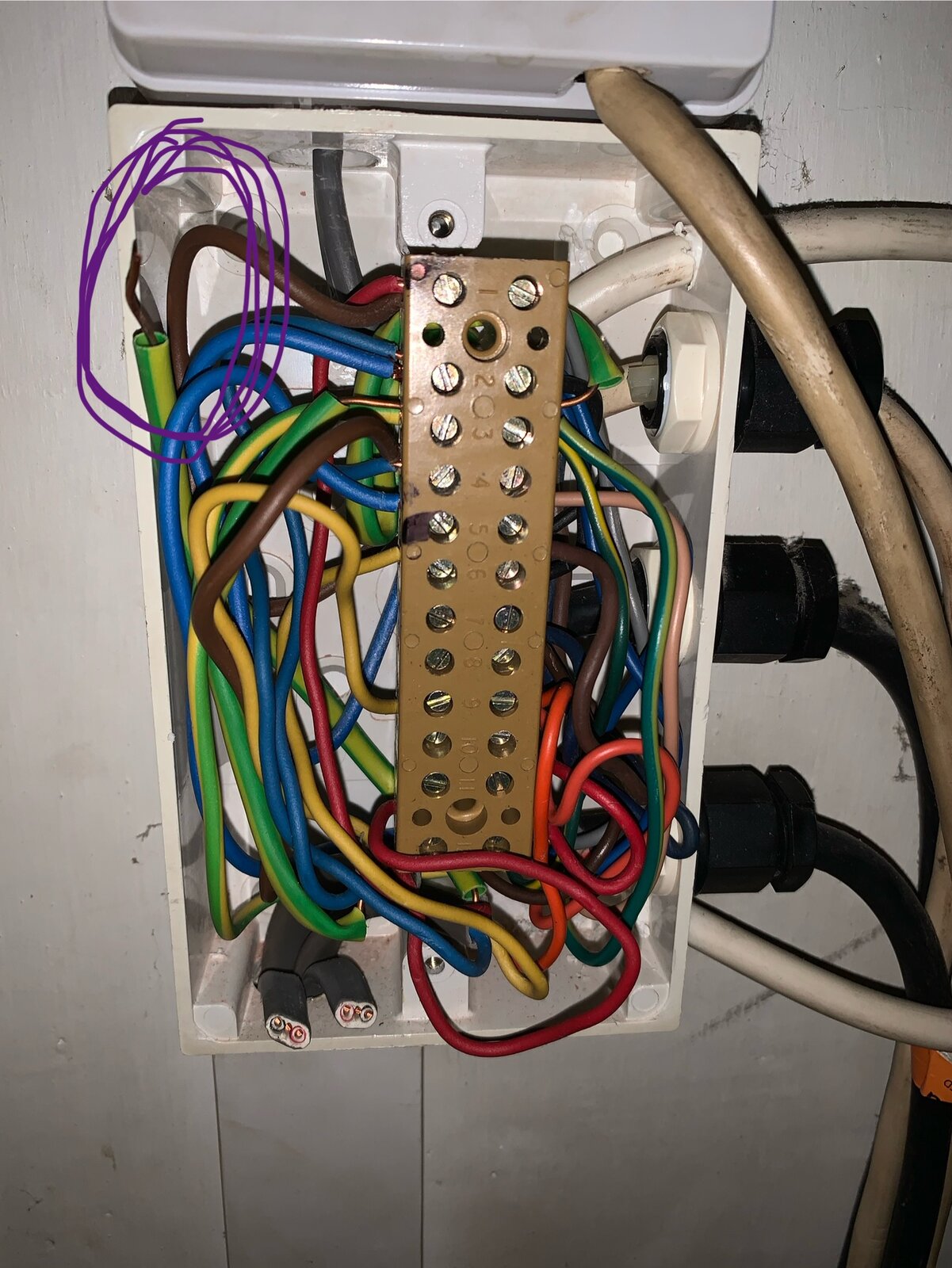

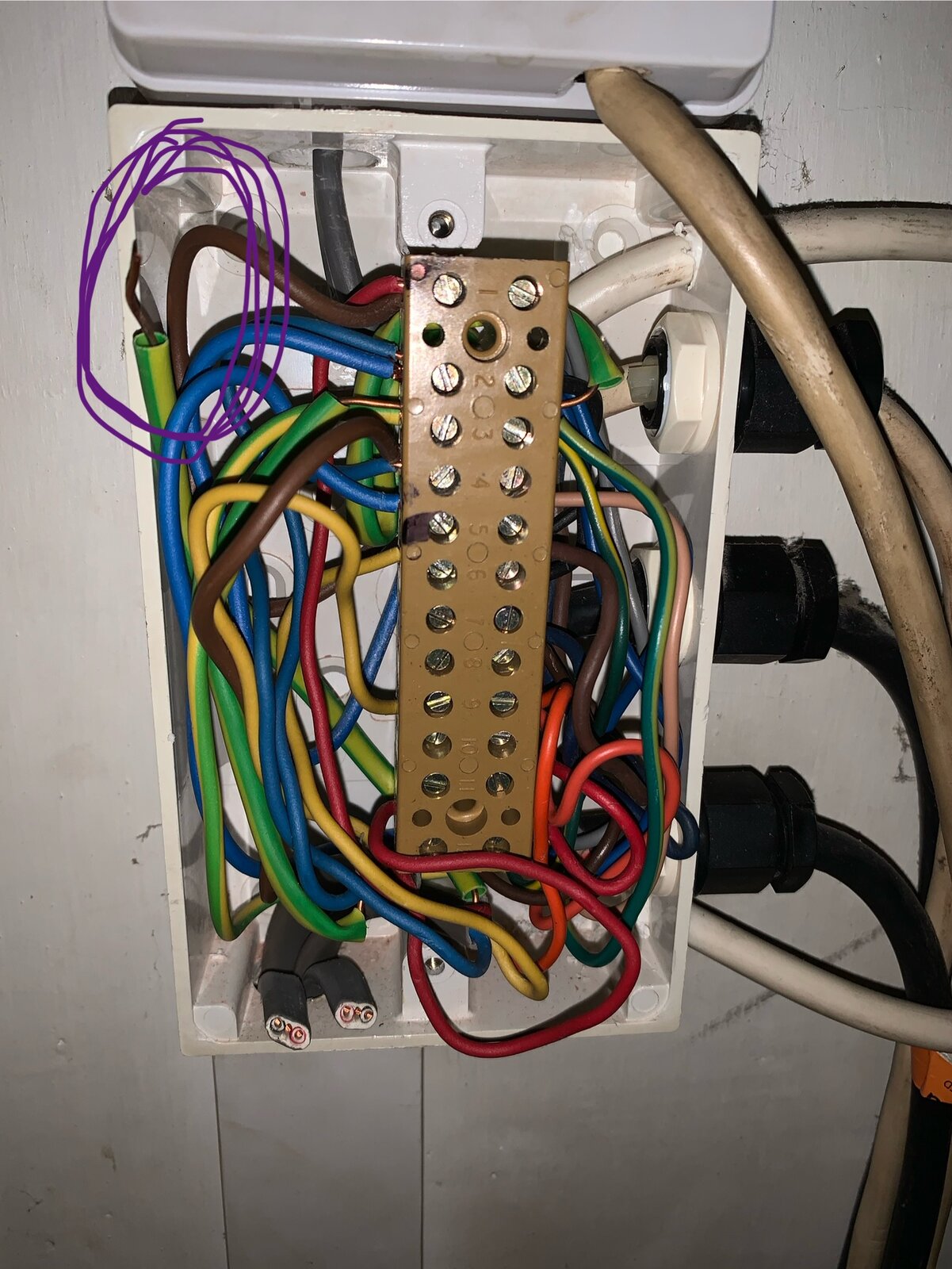

Not had chance to look at back of thermostat, however looked in the box with wires and noticed this one isn't connected
Not had chance to look at back of thermostat, however looked in the box with wires and noticed this one isn't connectedView attachment 361924
Ignore that for the moment - we are trying to follow a logical troubleshooting process.

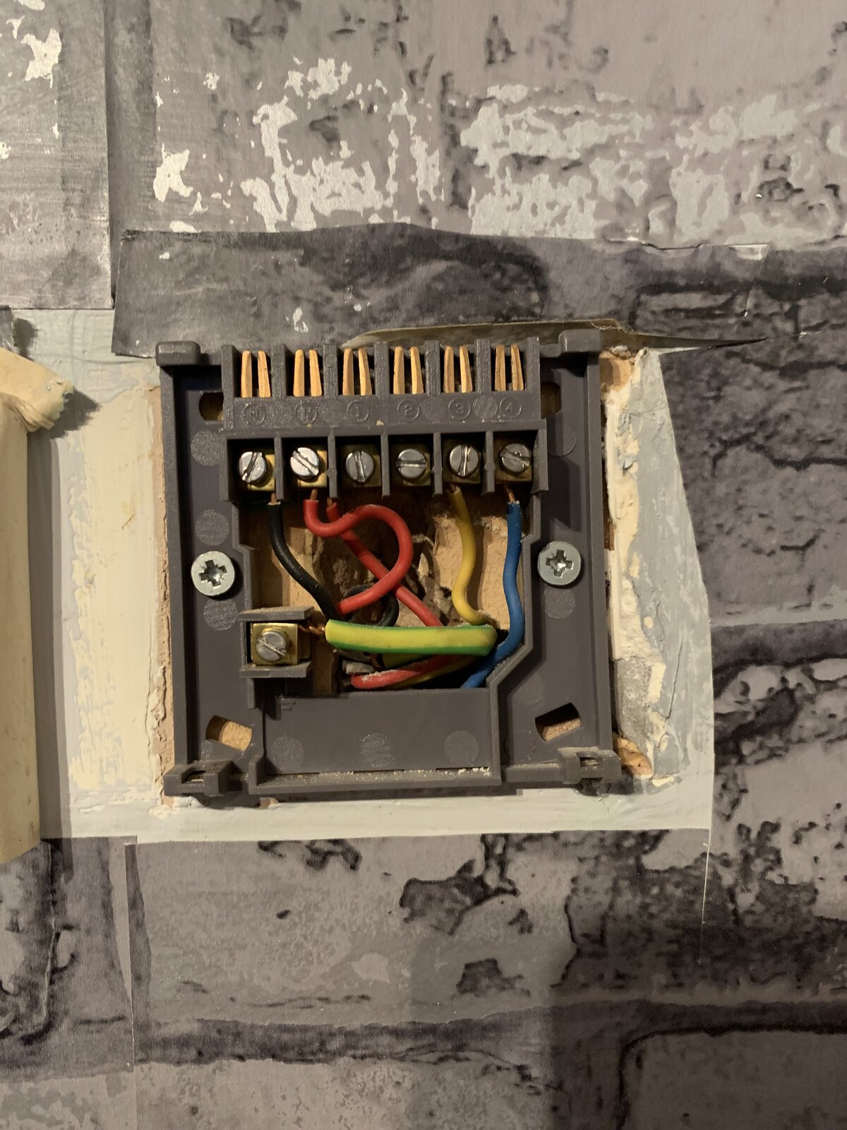

If you can show us the wiring behind the programmer, we can try and bridge that out, to see if the receiver power is restored...
Ok will do that shortly, i’ve changed the reciever and still nothing so has to be to do with that! Or the wire if not
OK, again, with the power safely isolated, move the Blue wire in terminal 4, into the L terminal, along with the two other red wires.
With the power restored, if the Salus receiver then powers up, the problem is with the EP200.
Thankyou so much, heating now on! Looks like the Salus EP200 is fault, can’t say how much i appreciate your help :)

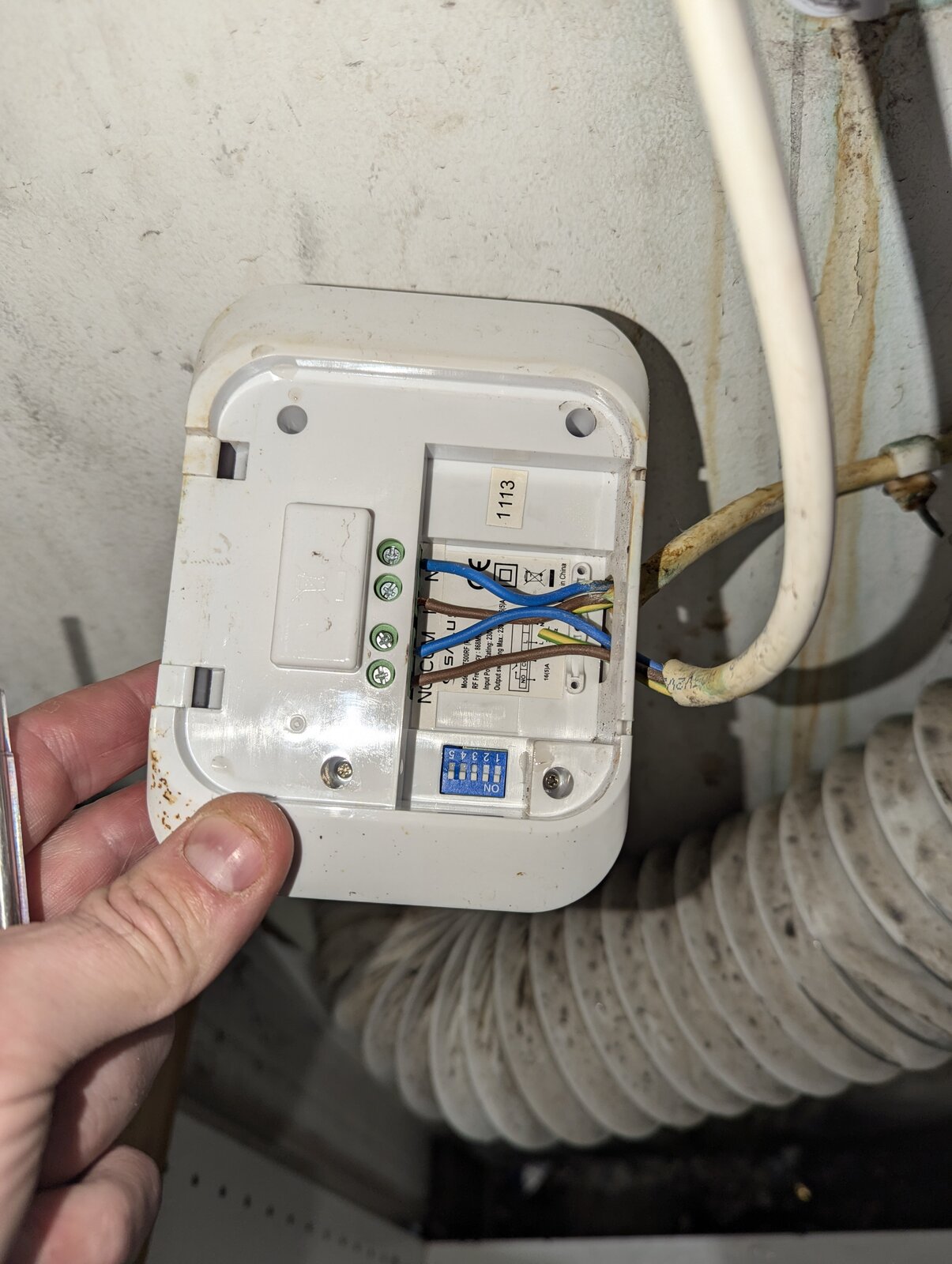

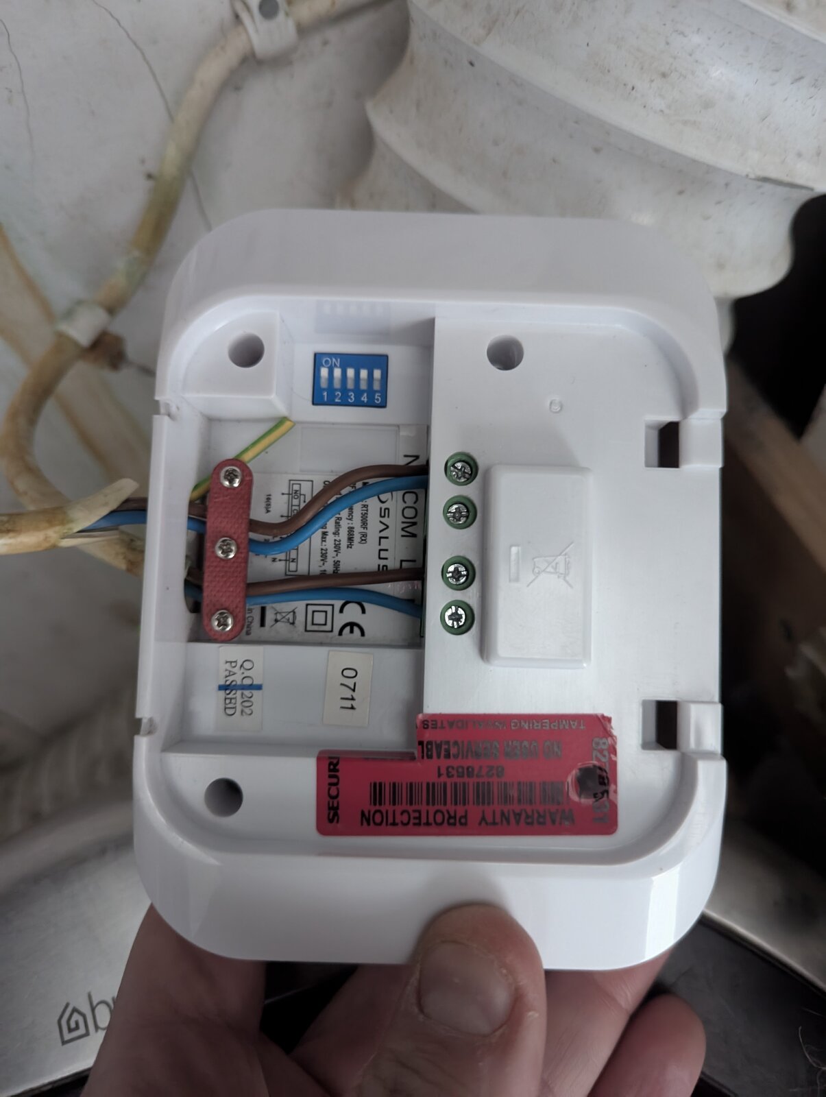

Can you show us a picture of your wiring behind the Salus?
Do you have a separate programmer?
Lights not coming on on the Salus, and the boiler firing when the wires in NO and COM are joined together, suggests a perfectly working boiler.
now wiring.
I purchased a new receiver and combined the wires from the boiler so they could get heating on. Still no lights on receiver
Does the power cable for the Salus come straight from the boiler, or is there anything in between, i.e. a programmer, or a fused connection unit?
