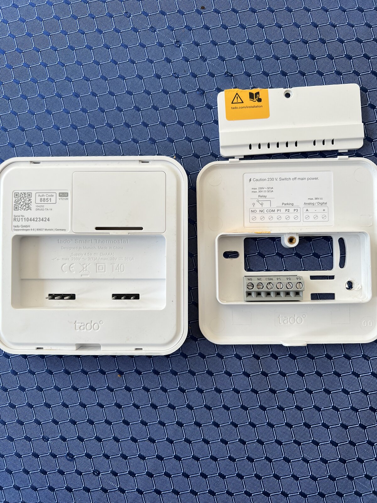

a wired Smart Thermostat.
If you have the Tado wired smart thermostat (despite the name), it is battery operated.
The wires in the RXRT510 receiver will copy across N/O to N/O and COM to COM on the Tado.
Any other wires that are left, can be placed into the Tado's parking terminals.
If there is a link wire in the RXRT510, between L and COM; the L can be placed into the Tado's COM terminal and the link wire can be disposed of.

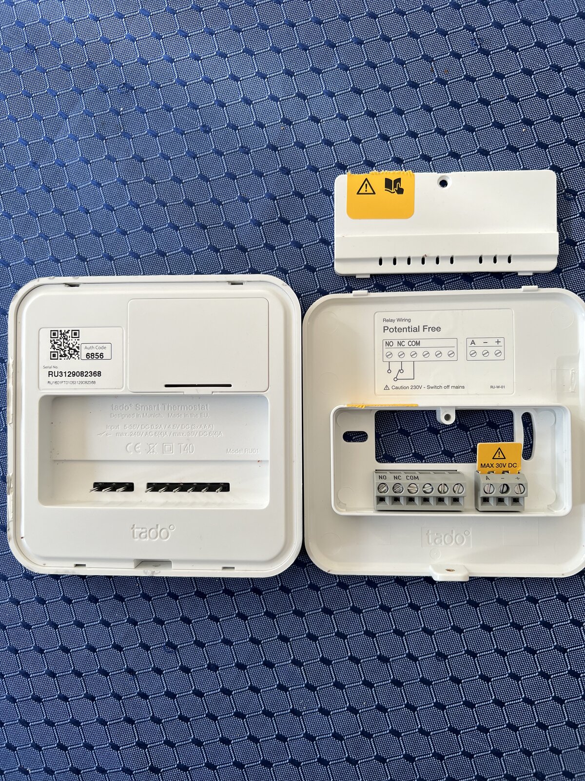

as requested @RandomGrinch, I have attached photos of each of the two Tado Smart thermostats I have. I am 99% certain, both these thermostats were wired before the heating engineer removed them when the Heatmiser thermostats were installed. Each of these Tado smart thermostats also contain batteries.
I have also attached a photo of the Tado Extension kit. Based on the photo, if you can let me which of the terminals I need to wire, that will be great. I think I may need to go to my son's place and open up the RXRT510 receiver to see how it is wired.

Is there an old wired thermostat at your son’s place? I think the extension kit is only to make existing Tado wired thermostats wireless?
thanks @RandomGrinch. If I ignore the extension kit, where do I wire the wires that are currently in the Salus RXRT510 receiver? This receiver is currently in the bedroom on the first floor where the boiler is located (boiler is inside a cupboard and the Salus receiver is just outside the cupboard). The wireless Salus thermostat is positioned in the living room on the ground floor.
Stupid question but if I ignore the extension kit, why did I have it in the first place when I had the Tado setup in my own home?
The thermostats alone, don't have the ability to control hot water.
The extension box allows this and also provides the wireless connectivity that your son needs.

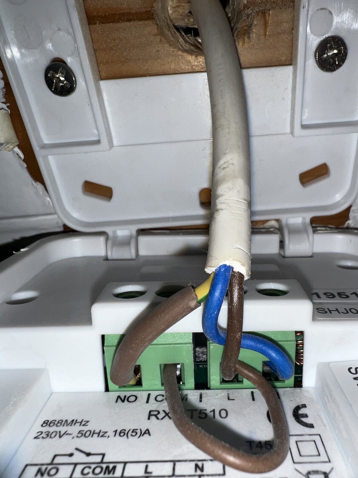

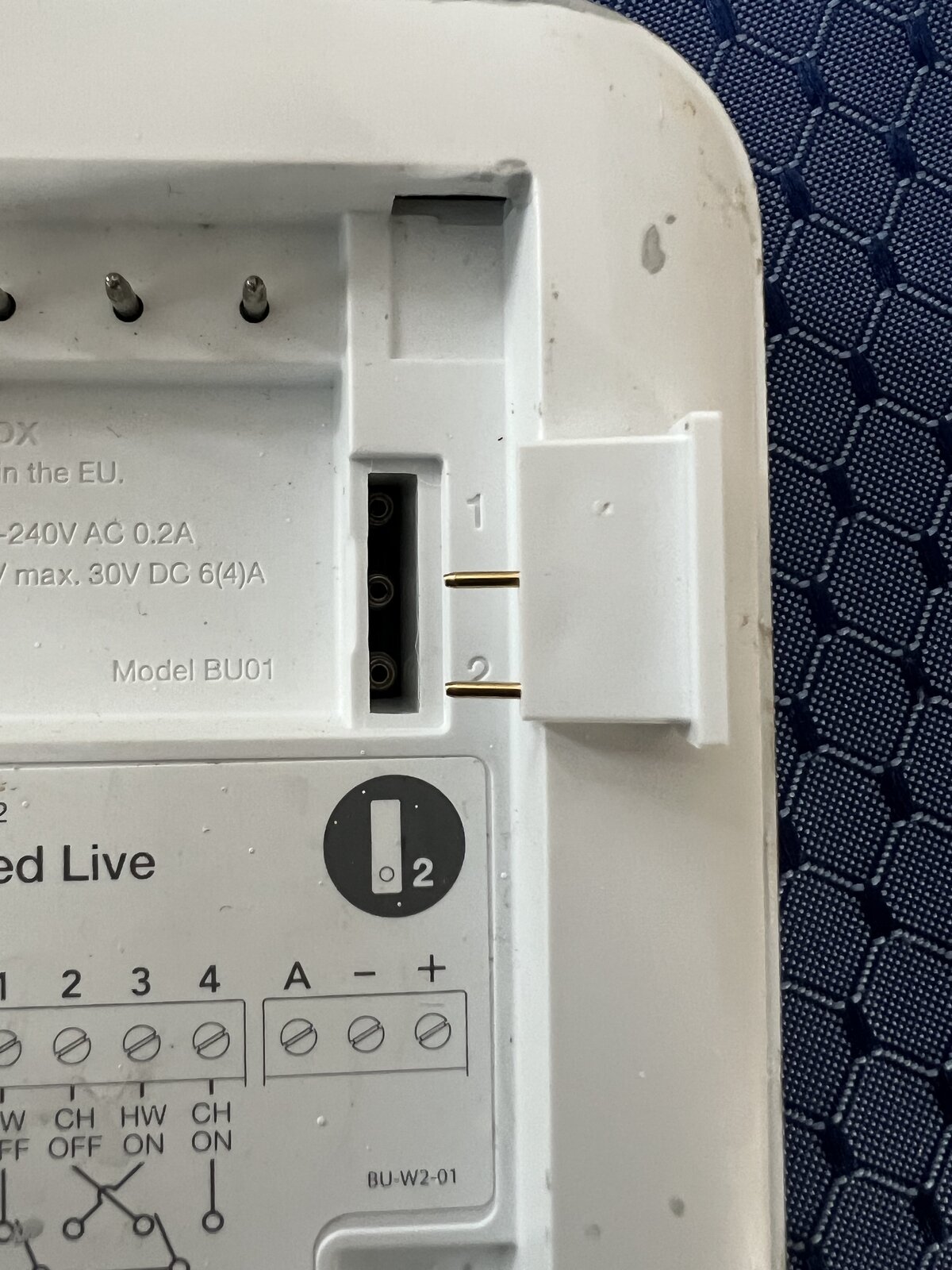

good morning @RandomGrinch , @CBW , and everyone else who may have looked at this post :giggle:. I have attached a photo of the wiring to the Salus Receiver. There is a link wire between L and COM. I also noticed the earth wire coming into the Salus Receiver has a brown sleeve on it just as it's wired into the 'NO' terminal.

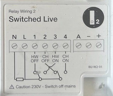

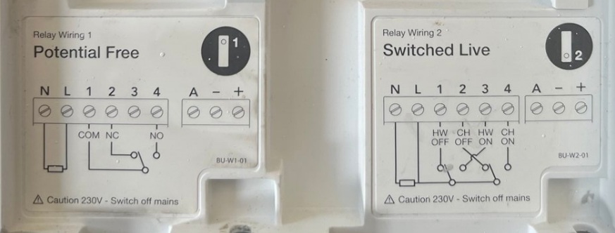

Looking at my Tado extension kit, I noticed it has two wiring sections - 'Relay wiring 1 - Potential Free' and 'Relay wiring 2 - Switched Live'. Which one of these wiring sections would be used?

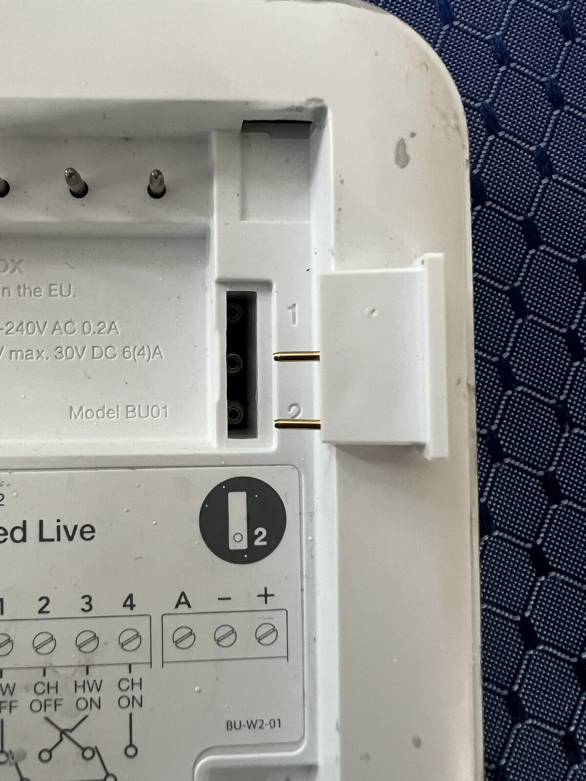

I have also attached a photo of the 'jumper' position at the back of the extension kit. When I pulled it out, it appears it was in position 2. I assume I just turn that around so that it goes into position 1? As a matter of interest, what will this do by swapping the jumper from 2 to 1?
Based on this, can you advise how I should wire up the extension kit?
As in the diagram on the rear, the jumper swaps the Tado between the two modes - essentially, one mode (potential free) for combi's, and one (switched Live) for boilers with separate water heating controls.
As this will be attached to a combi, it makes sense to use the potential free setup - position 1.
Brown to L
Blue to N
Green/Yellow (oversleeved Brown) to terminal 4
Attach the small Brown link wire between L and terminal 1
Note, that under current regs, it is no longer acceptable to oversleeve the earth wire for use as a switched live - however, for a simple thermostat swap, you should be ok!
