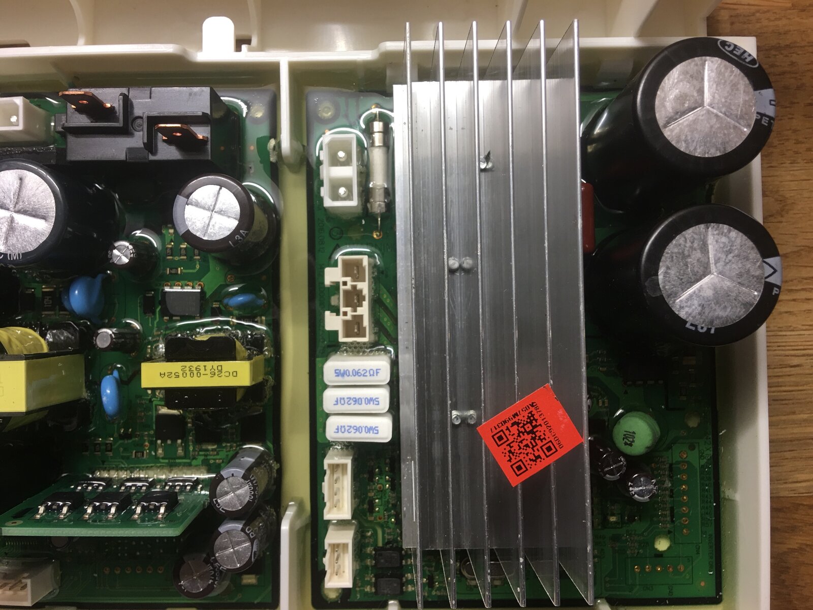

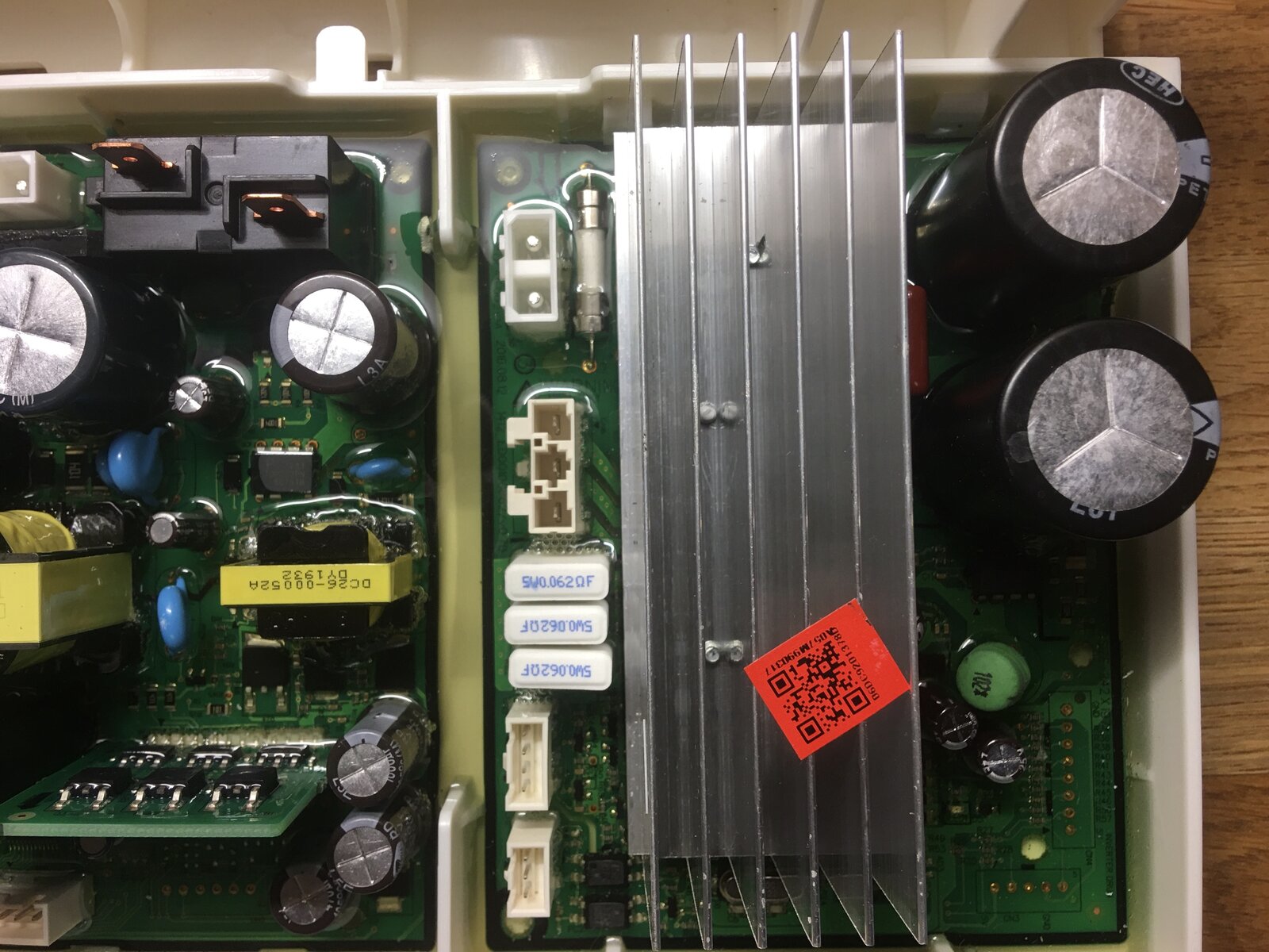

Following a large amount of wires I’ve found the circuit board. I’ve attached a photo.
I see what looks like a metal fuse so with my multimeter set to diode test I get a continuity beep when touching both sides.

Is there any power at all when you switch on, is the child lock activated?
Blup
Nothing lights up at all.
I’m not sure if the on/off switch should stay in when I press it as I press it in and it comes back out. Even holding it doesn’t show any lights etc.
Remove the top of the machine and locate the power supply board.
You might have to take the rear panel off as well.
Those boards are rubbish and all the wire terminals are not insulated.
The vibrations make them move, arch and slowly burn.
If you find evidence of this, you need to first test that you have power there, use a multimeter.
If you do, dismantle the board and clean it properly until you get shiny brass connectors showing.
Then replace the spade connectors on the supply wires with insulated ones and reconnect all.
Circuit board shown in post above.
All looks clean and all have insulation or a cover attached.

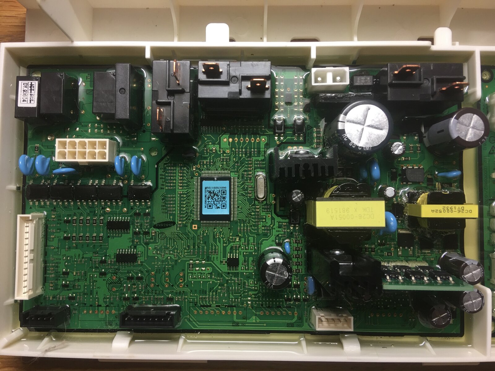

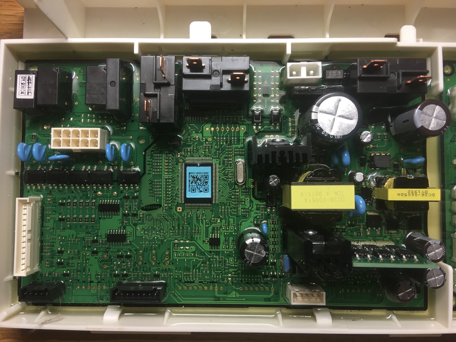

Hi
It’s not that it won’t spin etc it just don’t light up any display at all.
So with the board on the floor & connected all up i switch on the mains.
Now not all the time i hear the clicked like i mentioned above.
I do however see a bright led etc on the circuit board which flashes every now & then BUT as i watch it i see it getting dimmer & dimmer & then no more flashin.
I also had seen a green flashing led on the board.
Any advice with regards this led flashing as i would think it should come on & stay on or at least if its going to flash then it shouldnt dim.

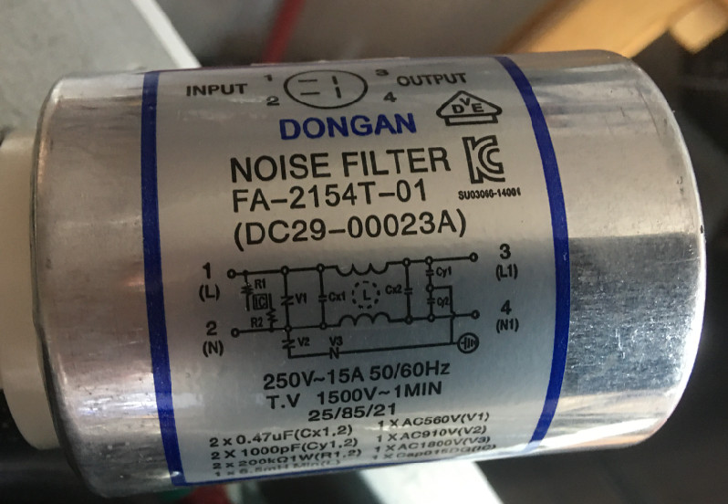

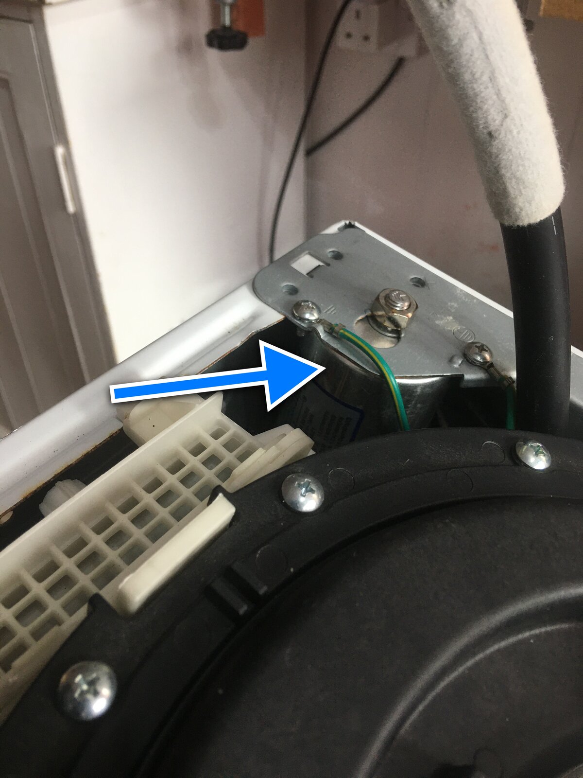

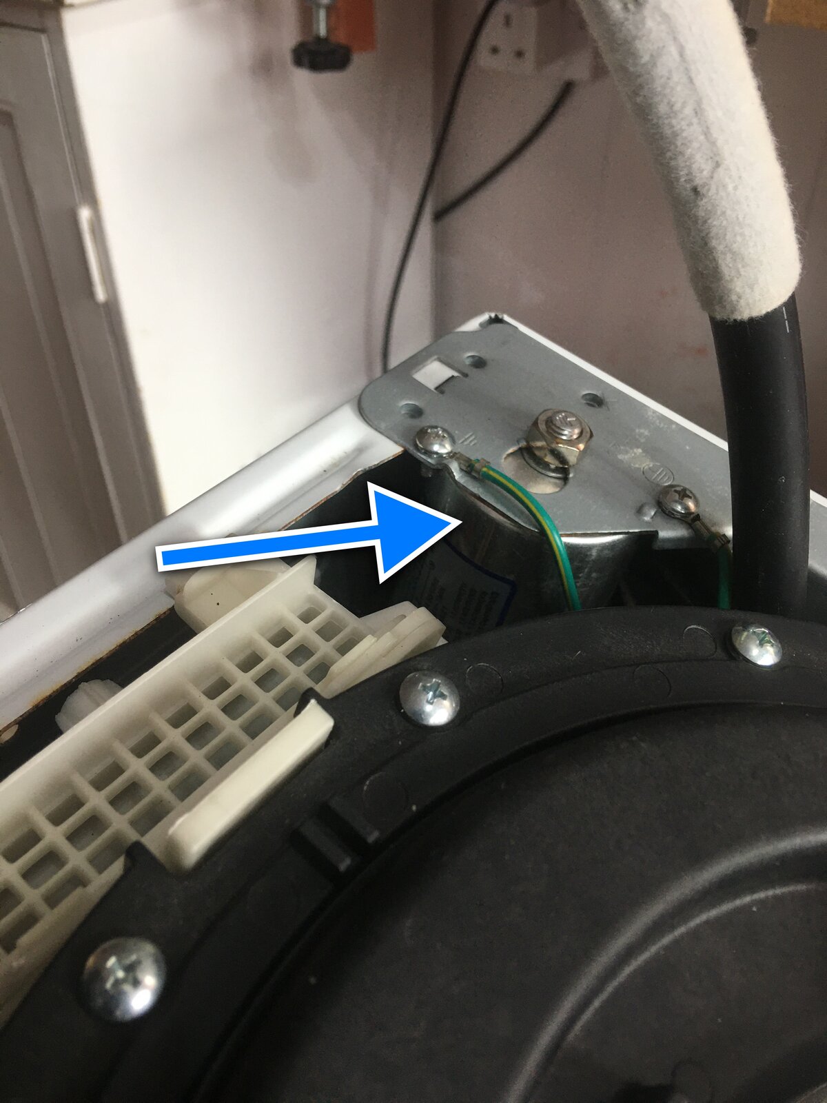

The power lead comes into the machine and the live & neutral connect to a large cylinder looking thing. The earth wire connects to the carcass of the machine.
I dont see another board.
Just in the back of the machine to this large cotton reel looking canister then down to the large board as shown.

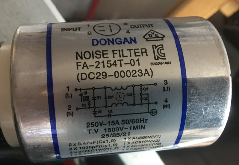

The item is called a noise filter

Kool, then I guess that you need to pull the washing machine out and check for continuity. Google the "service engineer manual" for the machine. There may be an internal glass fuse that has blown. You can often buy replacements from the likes of Halfords.
I would imagine that removing the top will give you sufficient access to the bits that you need to check
Ive removed the power lead & check continuity on the earth, live & neutral & all fine.
I thought to measure the voltage coming OUT of the noise filter.
My voltmeter has on the voltage scale 20, 200 & 600
If i use the 200 scale i see a figure of next to nothing i mean like 0.05 etc
So i thought as it was out of range so i changed to the 600 scale & i get 0.00 on my meter.
I assume using the 600 scale i should get at least 240v ?
Is that correct.
As a test can i unplug the noise filter & then connect the wires meaning to bypass it.
I only then need to see if the display screen comes on, if so i will switch off straight away.
Asking as not sure if the noise filter accepts 240v IN but then say only 100v OUT

With the multimeter now on AC volts i see 234v going into the noise filter & also 234v coming out of it
Ive now followed the wire from the output of the noise filter down to the circuit board.
Using the voltmeter again i get 231v at the board.

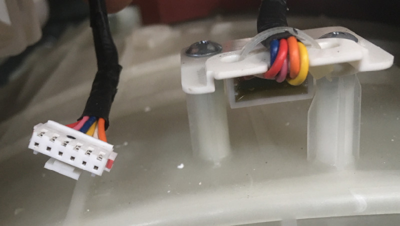

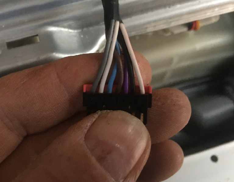

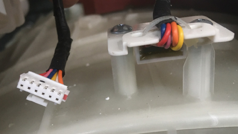

At the fascia panel i see 2 connectors.
One of then goes to the top of the drum & covered in jelly like silicone as per photo.

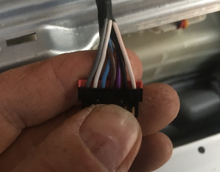

The other of which i am holding goes across the top of the drum, down the side to the circuit board.
So i believe this must be the power feed etc.
My issue is now which wire should i be checking to see if power is present ?
The wires are as follows.
GREY
WHITE
BLUE
BROWN
PURPLE
BLACK
WHITE WITH A RED STRIPE
