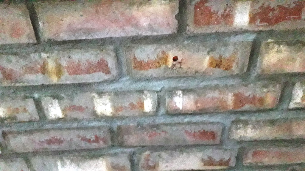

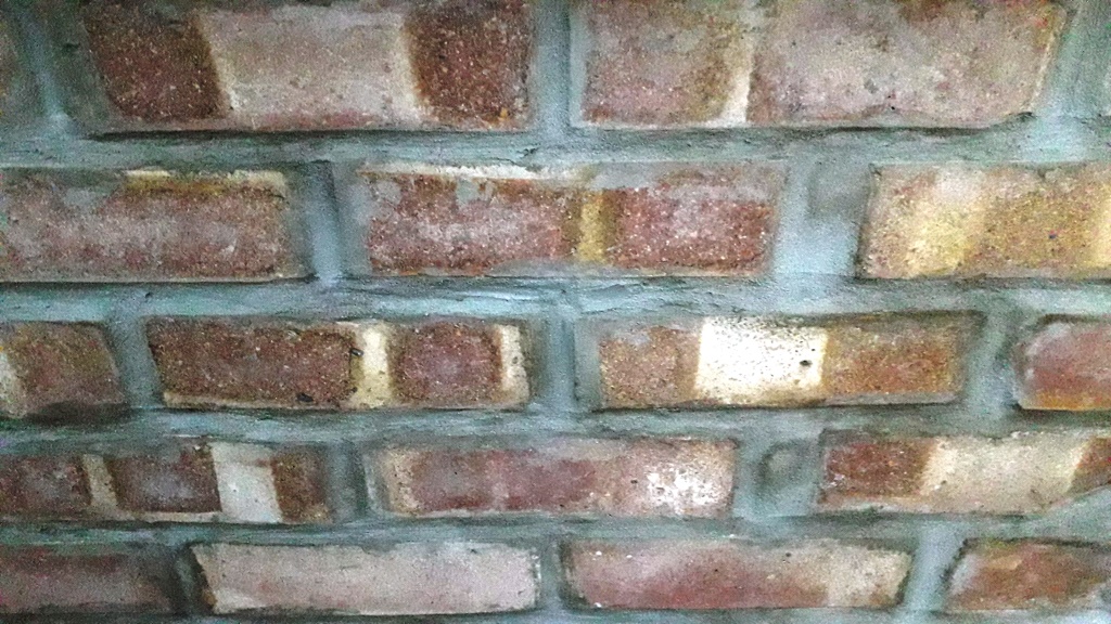

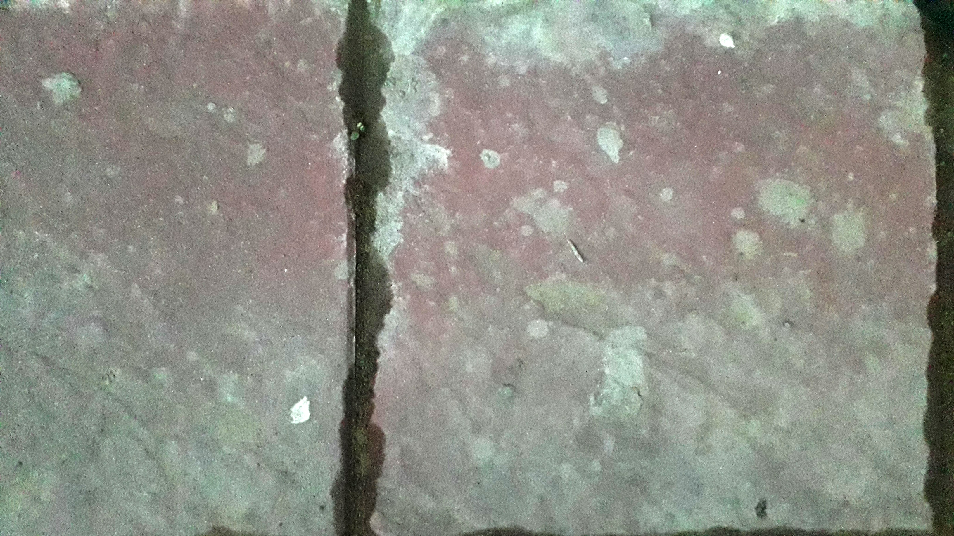

This is what I have did so far :
Bad attempt on one side of the wall :
Better attempt on another side of the same wall :
and this is the excess that fell on the slabs and really needs to be cleaned up :
I did a bit of experimenting and it seems a dish washing steel wire scrub with water is the answer to getting the light mortar stains off the bricks.
