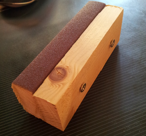

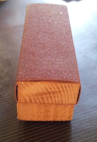

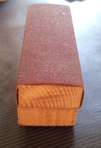

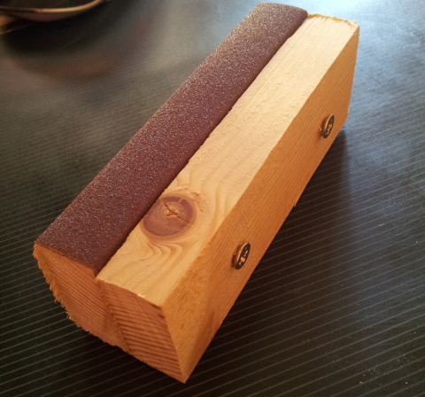

PVA glue sandpaper to blocks. Make a really sharp corner angle.
Or use velcro sandpaper rolls on velcro wood sanding blocks for quick change
Or wood screws.
Cloth can't do sharp angle with the screws. But I have a feeling it has durability. Both paper and cloth have their places. I will get both if tests confirm my feeling.

Or wood screws.

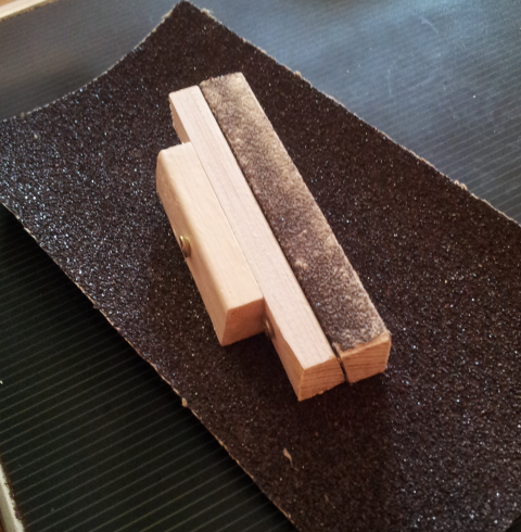

If you put a thinner (less wide) strip of timber on the top, might it not make it easier to hold the block if sanding flush to an edge?
I often wrap sanding paper around long lengths of wooden dowel or bits of square profile timber to rebuild timber mouldings with 2 pack filler, eg
The block is a new fabrication. I can change it to however it is needed, or make new blocks. Right now I don't need a sharp edge. But there will be times when I do. Rather than forcing cloth into a sharp edge, I could just use paper that is thinner and crispier.
The cloth is clogged up anyway from sanding paint. Using rubber of cure hybrid polymer sealant, most of the clogging could be cleaned off. The compacted bits could not. I will soak them and see the cloth performance.
