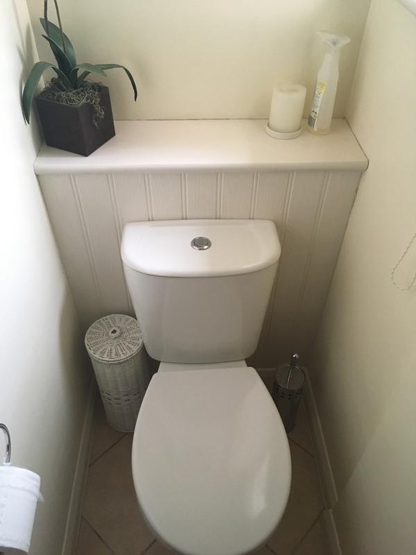

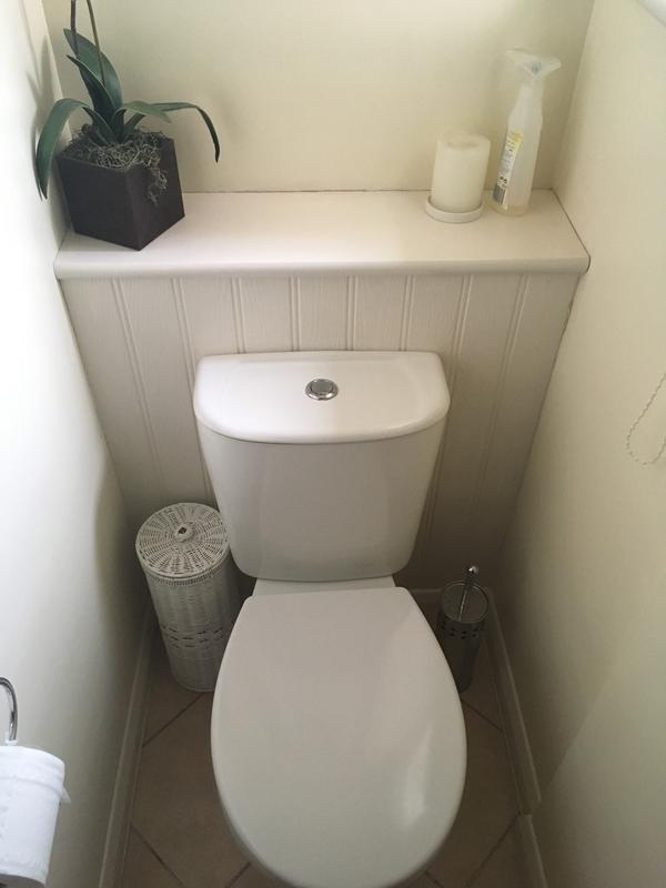

I have the sanislim. That has a couple of floor level inlets. It can cope with toilet/sink/shower. I have mine boxed in. https://www.saniflo.co.uk/installing-a-toilet/226-sanislim.html
make sure that the panels are removable so that you can repair the unit.
