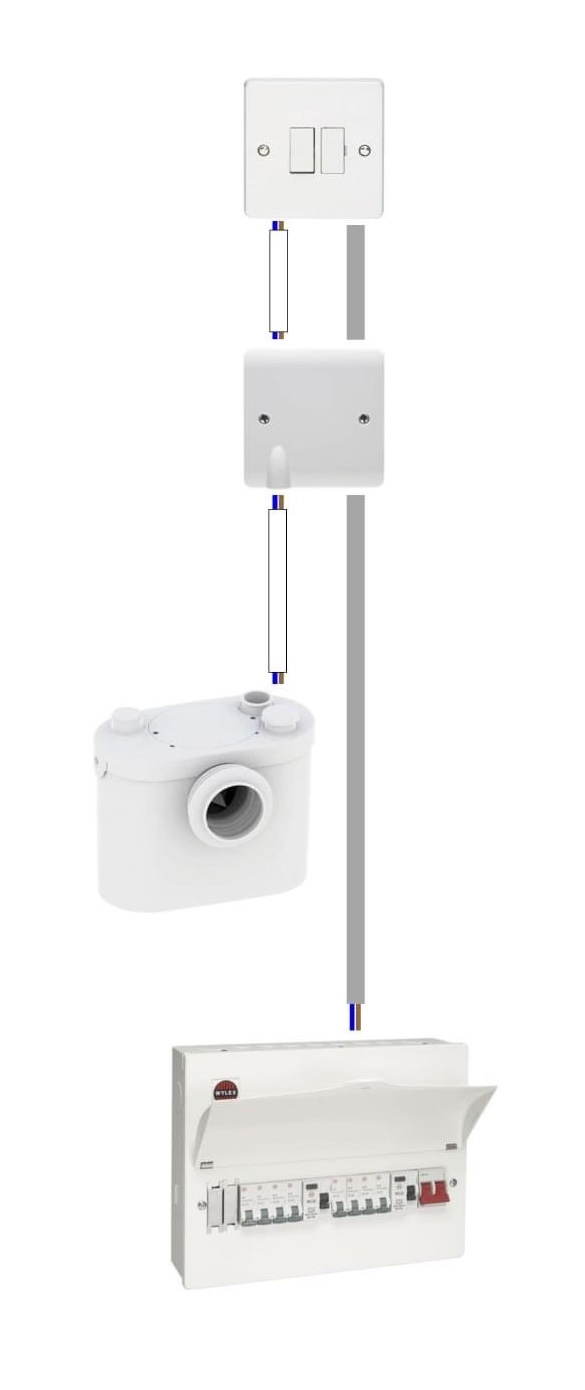

Saniflo Cable too short for Spur.

is the cable for the FCU run from floor level, up or down from the ceiling? What purpose does the FCU serve?

It depends if it's anything like:

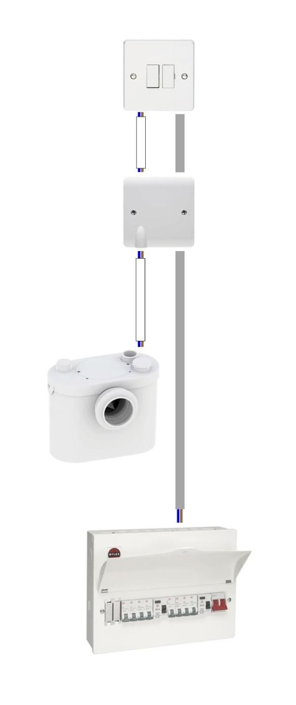

Would that not be subject to if there is a shower or bath in the room and the 3 metre reg
... again, if the plug and socket were within the cabinet, would that not be out of zone?
If I had got out of bed on the wrong side one morning and found no milk in the fridge for my first coffee and then arrived to find a plug on the power cable then according to the MI`s I could reject any warranty claim within the UK.
Not that I ever did you understand.
Why don’t you just fit an FCU with a flex outlet lower down the wall and remove the FCU from up top?
I would say no otherwise you could build a tiny cabinet around a socket anywhere in the room.
Plus - 'out of zones' doesn't really apply to sockets. In case anyone doesn't know, they have to be >3m. from bath/shower.
Thank you, yes I see your point.
An FCU in a cabinet would probably be ok?
