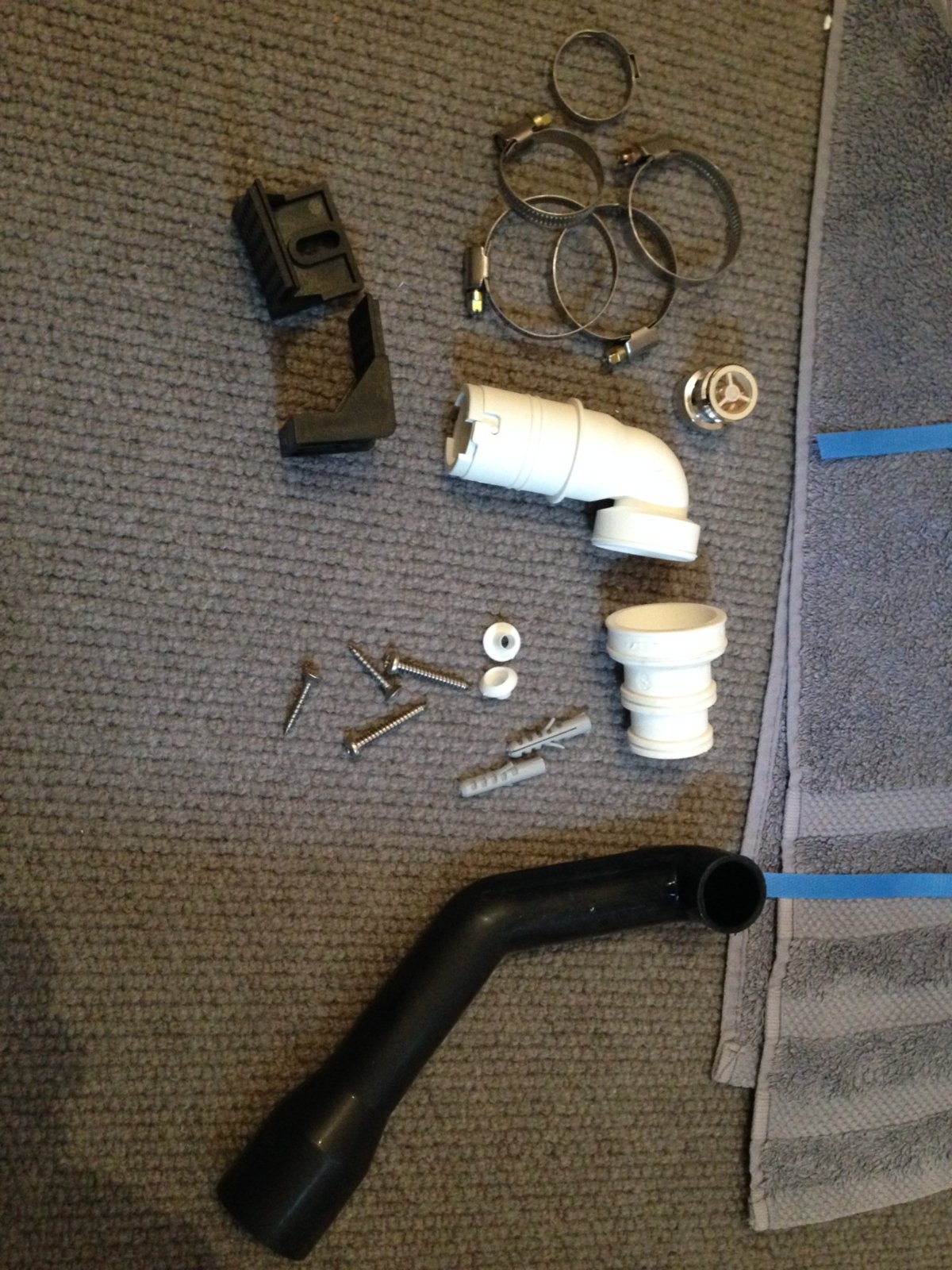

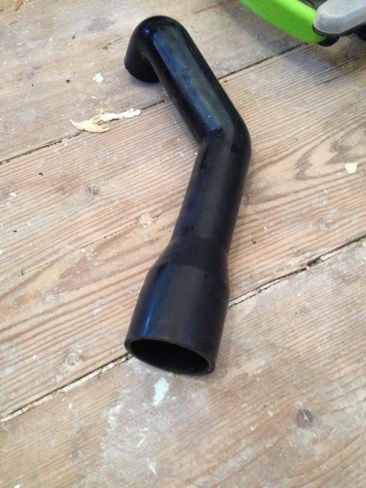

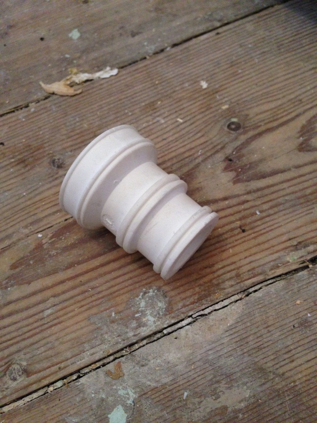

These are the parts causing issues.
Waste outlow with 32mm dia and sink inflow with 40mm dia. Neither work with U.K. Solvent weld.

It's the elbow siphon.
They used to come all assembled, looks like more time saving cut backs in the factory then. No big deal as it can only go on one way and if memory correct there is a little line up cut out and lug to guide you. If using the basin connection then just cut the last 5mm or so off where the line is. (nice and square mind you).

Photo#1. Look at it carefully and it is stamped up for size of pipe, think you will find 28 & 32mm so slice the smaller section off with a new blade.
Photo #2 Is for the basin connection and is optional as discussed, low pressure inlet connection (for 32mm not 40mm from a basin)and rubber will compress with a jubilee clip.
Photo #3 Shows the floor brackets and all the jubilee clips you may need along with other bits.

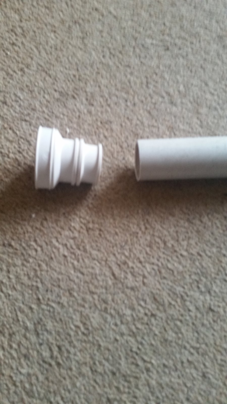

Re photo #1 it doesn't have that stamped on it and there is no configuration that will except a 32 mm solvent Weld pipe. Which has a 36 mm outside diameter.

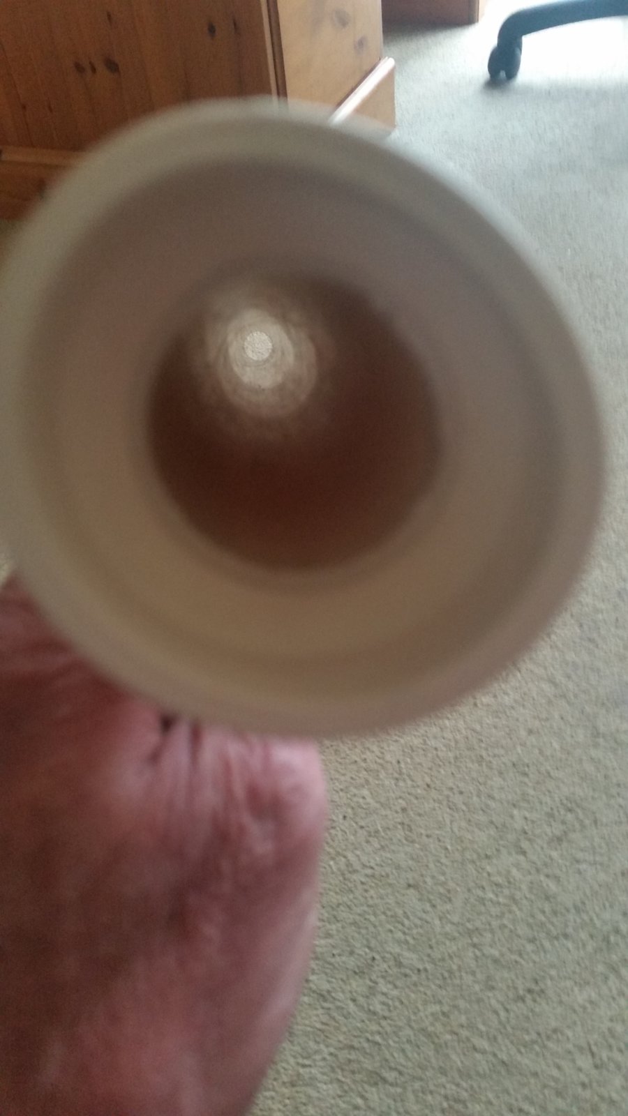

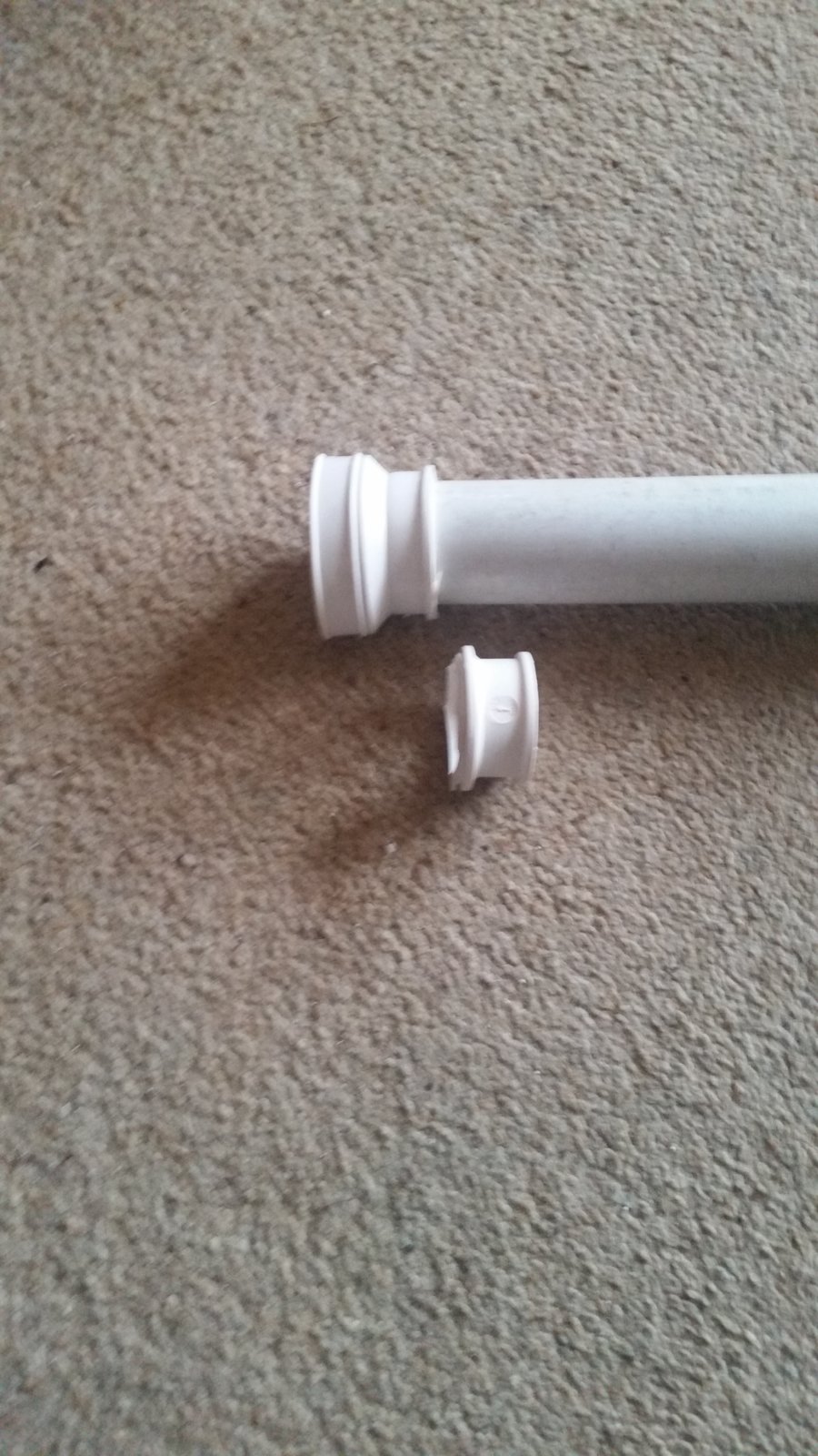

Just got one out of the van, cut it down and fitted it to 32mm solvent weld pipe for you (without using any lubricant !). :whistle:

So to be clear the solvent weld pipe has a 36mm OD and the adaptor 'hole' 32mm and you just stuffed it in?
I just did that and the adaptor distorts a little and is very tight.
Thanks !
Hand on heart that is 32mm solvent weld pipe with O/D of 36mm and no I didn`t "stuff" it in I worked it in bit by bit until the pipe was in by 15mm, if you can`t get it in without distorting the rubber, soak it in hot water for awhile then put it on the pipe and if you look up the other end of the rubber part as per photo #3 you can see when it is fully in and nicely square to the pipe. Yes it is tight for a reason!
