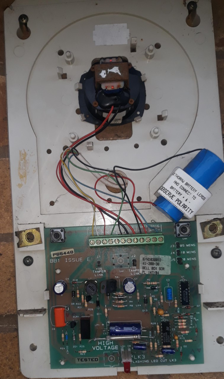

I left the strobe wire in the 0v for several minutes but the strobe still didn't activate. I've reset the bell delay to nil by keying 91 Omit Reset and Reset again and whilst the alarm all sets, only the internal sounders are triggered and the external one is silent even though I know it works when you place the blue wire into the 0v. What I have noticed is that when you're in the programming mode, if you try and key in 74 to test the strobe or 75 to test the siren, the system just beeps and won't let you. Also, for some reason it also won't let me key in 72 to change the user code and so its still currently stuck on the default code.
Sorry to be a pain in the a**e but I hate giving up on things and I'm fairly sure there's not much wrong with it, probably quite a simple fix, if you know what you're doing.
Thanks.
