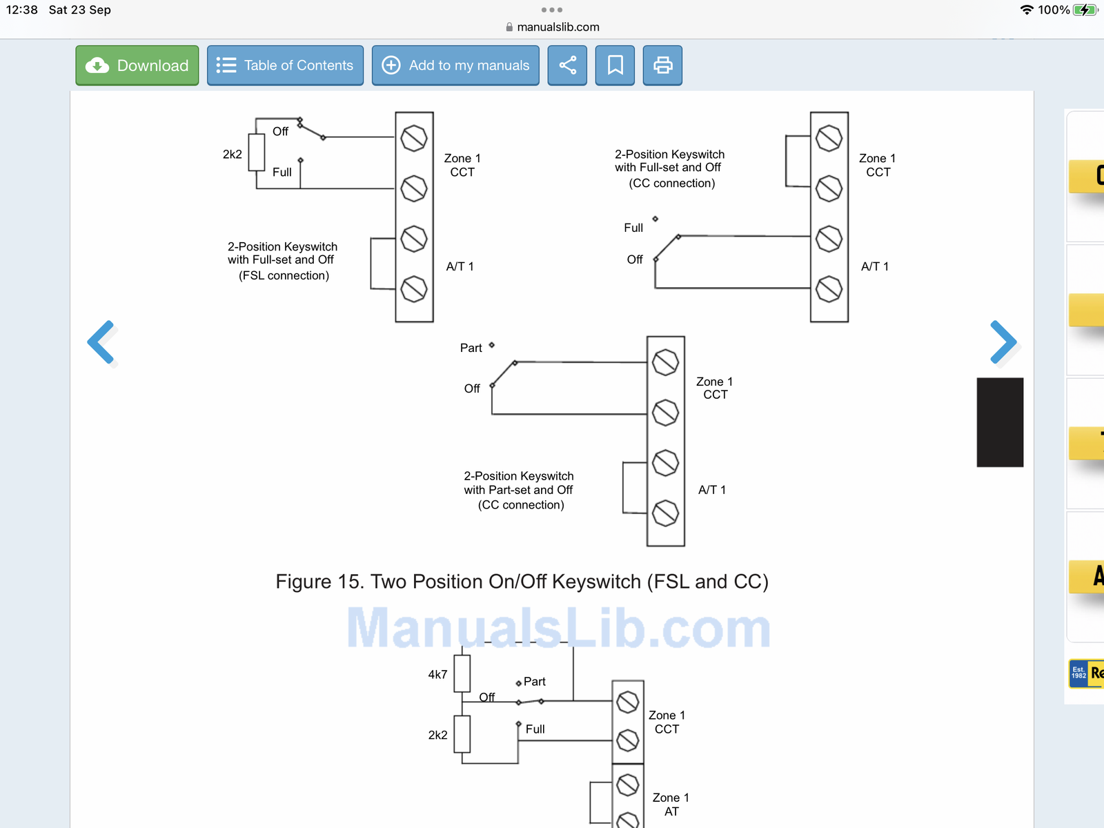

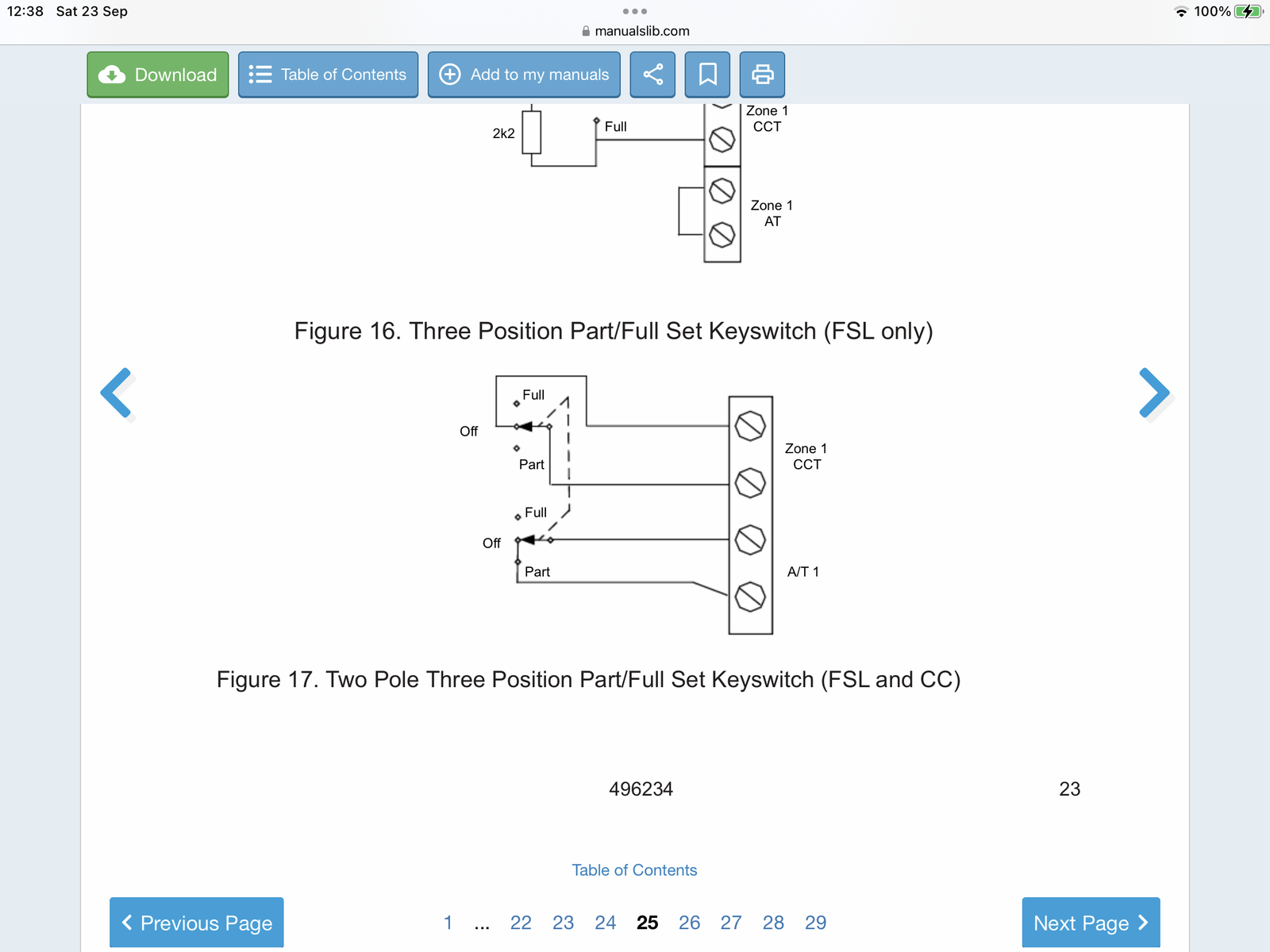

Bit of progress, if I set the zone to KF rather than KM. Then completing the circuit on the zone now puts the alarm (Level A) into a kind of set mode, but the sounder maintains a steady tone, and it never completes the set.
Typing my alarm code in during this process performs an unset..confusing!

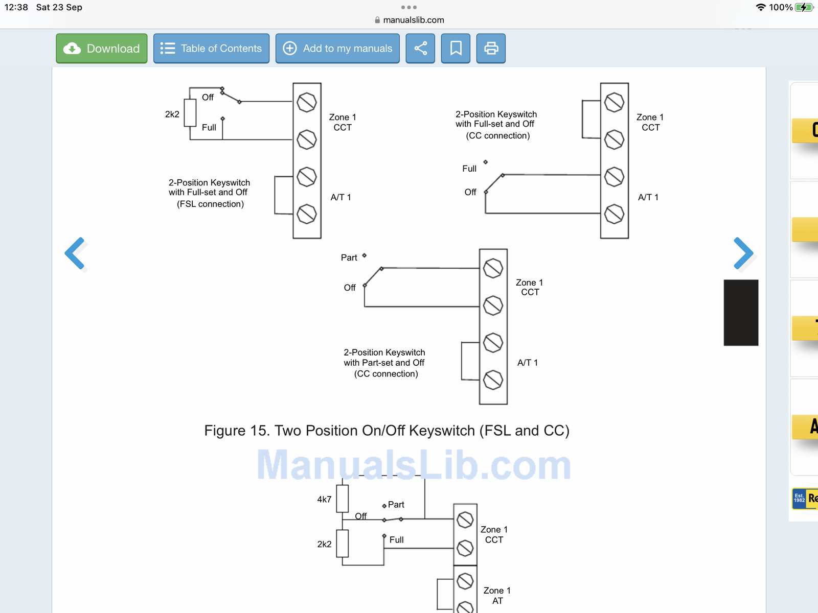

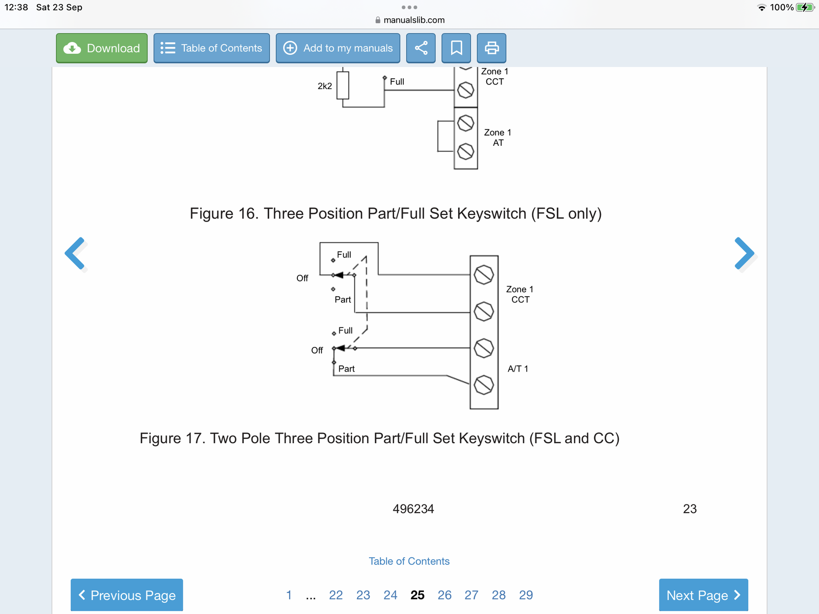

These are from the 808 /816 manual ( non idis version ) may help you …..only problem I can see with this type of key switch setting is when it’s not turned off by this method it will be out of sync….
