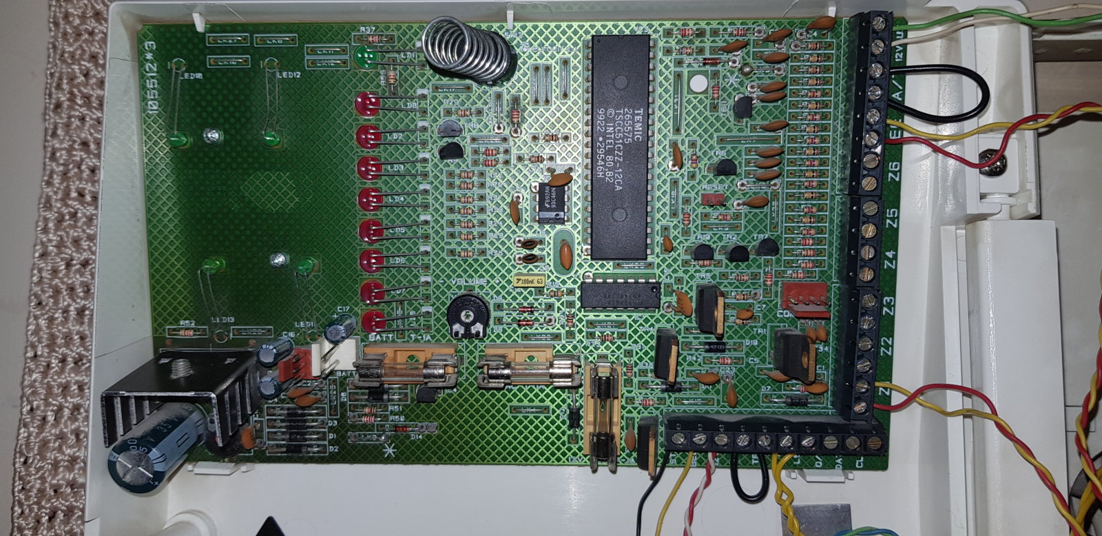

No ....you need to find the tamper shorting the pins is going to add to your problems ...post picture of pcb with what you have shorted out ...eg tamper and bell tamper
Here you go:
Ok ....looks ok . link out e/e , then put it in walk test, it should only show tamper ...now wiggle the tamper switch on the back of the pcb and hold it in ....does it go constant tone ?
Yes it does go to constant tone. then when I release the switch it starts beeping again.
That's normal? Can you hear the tamper close when the lid is in place? The spring may need stretching slightly to reach the back of the case when the lid is close (be gentle if you try to stretch it!)
Failing that, I've known 9448 tamper switches on older panels cause an issue when the lid hasn't been opened for a while and is then opened up. They sometimes need pressing in and out a few times to get them to close properly again.
Right then, I've just stretched the spring out a little and now when I put power to the box and turn it on the internal sounder sounds, I put my code in to stop the sounder and then my code again and NO TAMPER LIGHT now. Just the Green power LED is lit.
