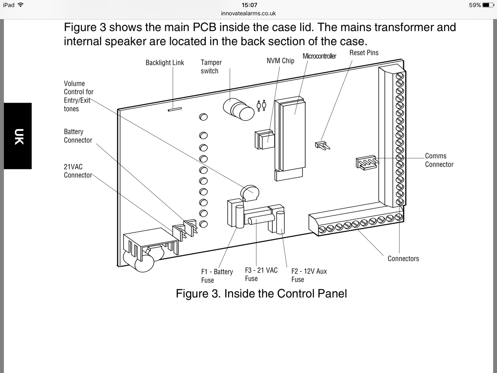

Hello,
Looking for some help.
I came home recently to find my Scantronic alarm completely dead i.e no lights, no tones when touching keypad. I checked all the internal fuses and they are OK. Figured it was the battery so replaced that and sure enough it all came back to life. Set the alarm in the morning, came home from work and the panel is dead again. Any ideas?
Battery is brand new so assuming its not an issue.
All internal fuses appear OK.
Replaced 3A fuse to mains, just in case.
IMG_1590.PNG Faulty transformer or transformer fuse on the pcb F3 as per diagram , this normally blows when the battery goes faulty and the transformer gets hot ...ps you may have to replace battery again if it's run too low , remove battery if replacing fuse F3 as it may take out the fuse ...
Seems to have done the trick. Tamper light came on at first and would not reset, but was OK after giving the internal tamper switch a little attention. Thank you very much :)
