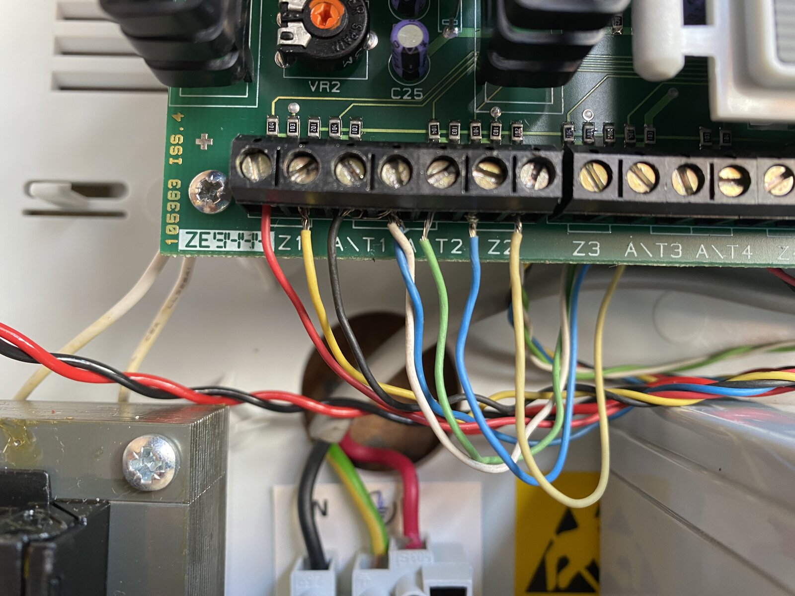

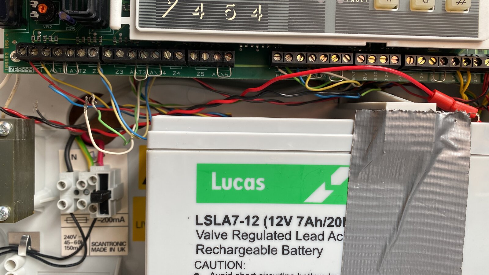

Replaced alarm for an identical but brand new scantronic 9454 exactly the same. Fitted
New battery and rewired using existing wiring into like for like connections. Can’t understand why I am getting tamper and zone faults when programming.

You have to link out anything that is not used or made not used in the programming for zones ( not other connection like bell tamper ) it’s allways better to power up with all links connected to make sure the panel is clear , then start swopping items over
