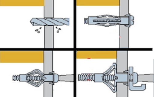

Why not just use interset fittings if it is a plasterboard wall?
They are metal fixings that have "arms" that splay out against the back of the plasterboard as the screw is tightened.
Before discovering them, via this forum, I used to use the expensive GripIT fixings.
A 50" LED telly is often 10-15kg., 6 of these will suffice. No need to try to find joists.
And yes, you can order a total of 6 from Orbital Fasteners, but you only get free delivery at £25. I would recommend buying the setting tool as well but that is £10.
Those are what we nickname "umbrella fixings". Available from Screwfix and Toolstation, but stick to the better brands like Rawl and Fischer as opposed to unbrandeds. If you do many of them the setting tool at about a tenner is well worth the extra. On double thickness PB I've installed Spur shelving uprights in shops on them on the odd occasion and I have some at home on book shel es (again Spur uprights)
Yeah, when using them, use the ones designed for double thickness plasterboard.
I must admit that the 4mm screw Rawlplug ones can be very hit and miss. I have had a few that failed at the point of using the Rawl tool to splay the arms back. It literally stripped the thread. I had to hammer a slightly bigger machine screw in to "unsplay" it and then remove it and fit a new one. Never had a problem with the 5mm ones though.
