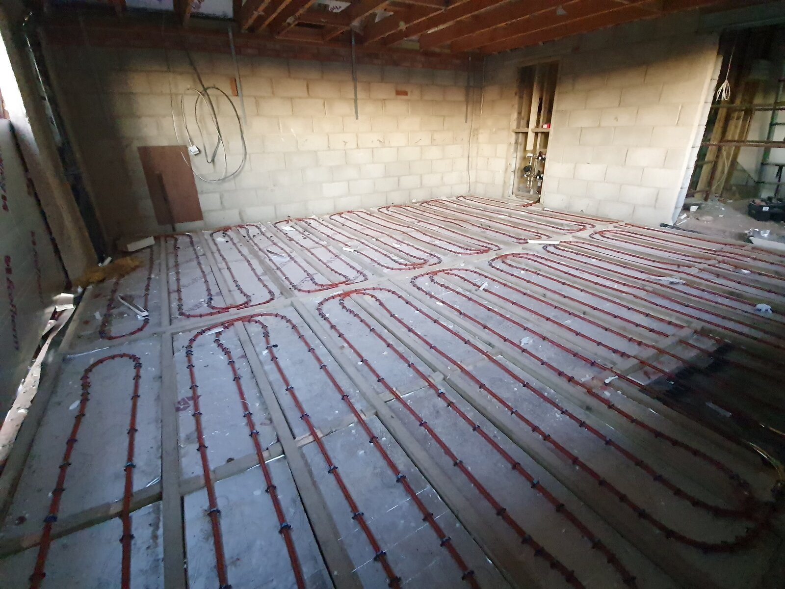

As mentioned in another thread we have a vaulted ceiling garage conversion with underfloor heating. The underfloor is running hot at almost 60deg flow. When it's mild outside it heats the room to a lovely 21deg but when it's cold we can't get above 18deg. It appears nothing further can be done with the underfloor which was the previous discussion.

i have fitted hundreds of underfloor systems and many in barn conversions with vaulted ceilings that are sometimes 50ft high. Never had any issues. But it does depend upon your floor coverings. If you have wooden floors then you are going to struggle badly, unless you are running flow temps near to 50c

@snb the flow temp is currently 55° and sometimes higher, nowhere near the efficiency I'd hoped for. Over the pipes is a thin screed, chipboard, 9mm ply and Karndean. In retrospect perhaps there is too much wood but I don't know how it could have been done differently. Surface temp today is 22°-23°

should have been screeded with karndean straight on top of screed. You would be best to rip the flooring out. Have another 20mm of poured screed applied on top of the existing screed and then put you finish straight on top. Your chipboard and ply are acting as insulation above the heat source.
You should be able to tee into the underfloor set up to connect a radiator or two. You will probably be surprised how little extra heat is needed to get your temp where you want it. I would try a fan heater on 1kw setting and see the effect.
I have a few underfloor setups where they have a couple of towel rads connected as well. They work fine so it should be possible for larger rads. Just flow temp will be at underfloor temp.
As an idea.
Whilst the wood is insulating the heat from the room, its also limiting the total heat output of the system. (Imagine your return temps are higher than youd expect).
Just tap off the ufh with a large radiator. Your heat input into the room should then revert to what the ufh was designed for.
However, id still go back and do a 1st principles heat balance on the building. You might find that regardless of the floor, it was never enough to heat it anyway.

Normally you would lay karndean onto the screed. With underfloor heating you normally latex it first so it can absorb the thermal movement. Don’t know why someone told you to use ply and hardboard.
as for testing the extra heating. With underfloor you need to run it for a minimum of 18 hrs per day and allow the thermostat to control any off times. Ideally you would run it 24hrs and allow the thermostat to control the off periods. To test how much extra heat I would run the electric heater for around 8 hrs and see the effect

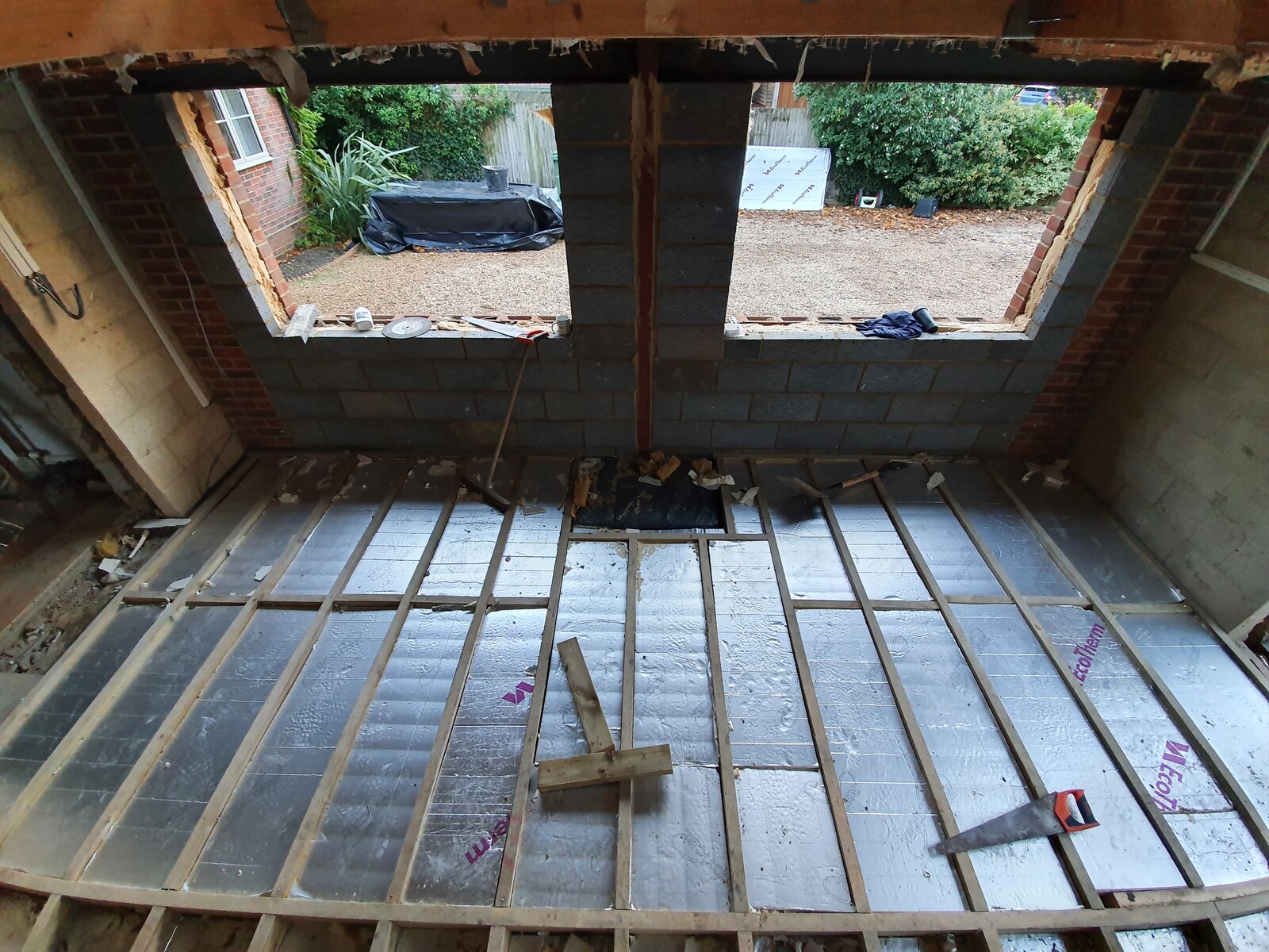

@snb it's a joisted floor, celotex was laid between the joists and the underfloor clipped to the insulation as per the pictures. They weren't going to screed but I asked them too, so they added a thin layer up to joist height.
The builder then added 18mm chipboard.
Later the Karndean fitter laid 9mm ply on top before the Karndean itself.
I'm confused by the heat test? Run the underfloor with a demand of 21deg for 18hrs? What do you mean by let themo control off times, it isn't getting above 18deg on cold days. 8hrs of the electric, ok wow, longer than anticipated!
