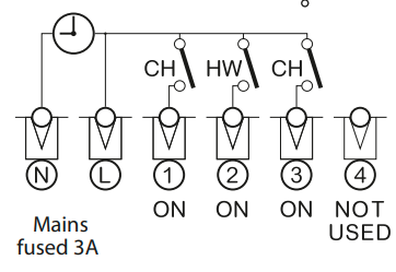

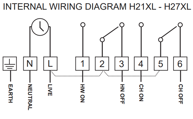

Hi,
I've got Secure ChannePlus H27XL which I want to swap with Drayton Wiser Hub (WT734R - three channel) Could anyone please help me with the wiring of these below? (N & L I can see how to wire clearly)
Here is a diagram for Secure ChannelPlus H27XL:
And here is a diagram for Drayton Wiser Hub (WT734R):
Maybe I ordered the wrong one, but that's what was advised based on having 2 zones/2 thermostats in the house (I've got one downstairs and one on the top floor).

Another trap for you- your existing controller uses volt-free relays. That Wiser hub is 240v (or Opentherm) only. Many many boilers are controlled by 240v signalling but not all- worth checking before you get too excited
Well, one of the problems that I do not understand is how is it wired to know I've got 2 zones.. From the diagram above in the Secure controller (H27XL), it only has CW ON/CH OFF. I assume that's on and off for heating. Do thermostats directly connected to the boiler control which zone to heat?
The second thing I do not understand why I've got 2 CH connections on Drayton Hub... I think one will be redundant then?
I still got a feeling it needs to be connected via Opentherm so I can use 2 thermostats as there is no other link.
Also, you've mentioned trap - that existing controller is using volt-free relays. Isn't L connected to 2 relay which switches? I mean it's still 240v anyway. No?

If your hot water is coming from the combi (no hot water cylinder) then good odds the HW side of your existing controller is actually running one of the heating zones.
You don't need an electrician but you do need some basic electrical knowledge and test equipment so that you KNOW what things do rather than assuming (which can cause expensive and dangerous problems).

Apologies, the Centaur was the predecessor. Also you may be able to use the Kit 3, so again apologies, was having an off day yesterday.
